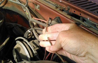

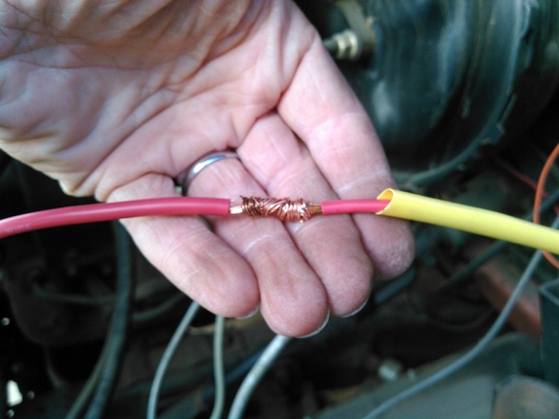

Woo-hoo! Sorted out the wiring on the dual battery setup and got it up and running. Did it right, with soldered lineman splice connections and heat shrink too. I hate going the cheap crimp butt-splice route if I've got the tools and time to do it right.
Found the problem pretty quick- internal corrosion in the power lead from the firewall junction block going to the solenoid for the second battery... It fell apart when I started to unbolt it from the stud. I think just a little brittle insulation was all that was holding it on.

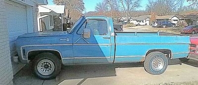

Went to the drag strip this weekend, me n gf want a motorcycle but I'm contemplating selling my 4wd square and buying a 2wd to tub out and make a pro class drag truck, all in all would be about 15k
The price of the bike we are looking at, I could get a lwb 76 for 300$, all rusted out and ugly (perfect sleeper right?)
Then slowly build the engine throughout the next year or two
I just need to talk her into keeping mine since it's only 300$ for the 2wd but it's long bed
