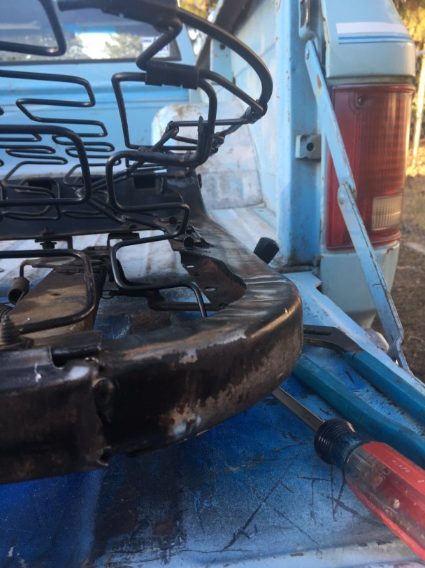

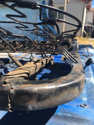

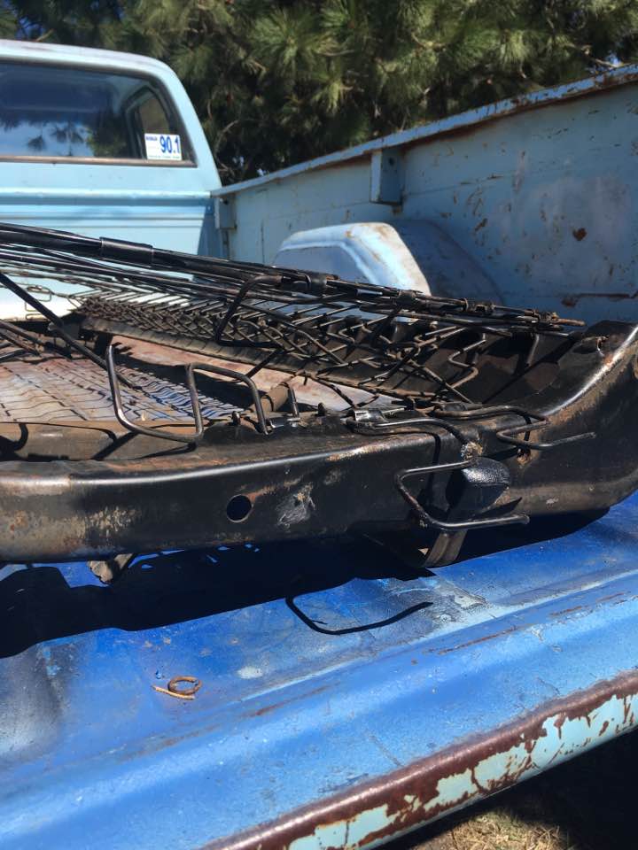

Replaced three broken springs and repaired three others. Here's a few before and after pics.

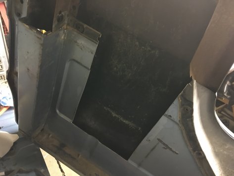

Spent a couple hours doing some hammer/dolly work on my rust free Shortbox bedside. I had to cut an access panel on the inside to get to the damaged area. Yeah it would have been way easier to just buy an aftermarket boxside BUT-I wanted to save this box and keep it all GM!

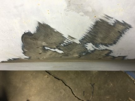

this body line was dented in about 1/2" at a length of about a foot.
gmachinz
Harnessworx Inc
Nov 10, 2012
762
303
Iowa
Jabin
More of a top view angle-this restored the location of the body line so it's as close as it will get horizontally and outward. Now, several coats of high fill primer will hopefully allow me to re-finish this area of the panel without the use of any putty.

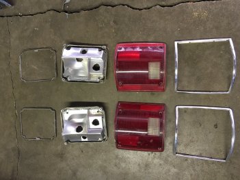

Also did a little Resto job on a used set of lenses....here they are all apart...
gmachinz
Harnessworx Inc
Nov 10, 2012
762
303
Iowa
Jabin
The GM housings were a silver color but-I preferred them painted white with a clear gloss coat-this should provide for much brighter lighting once assembled and installed with bulbs. The lenses I used a Meguiars plastic polish to bring out the gloss-the aluminum trim I used Mothers metal polish.

Assembled and ready....
