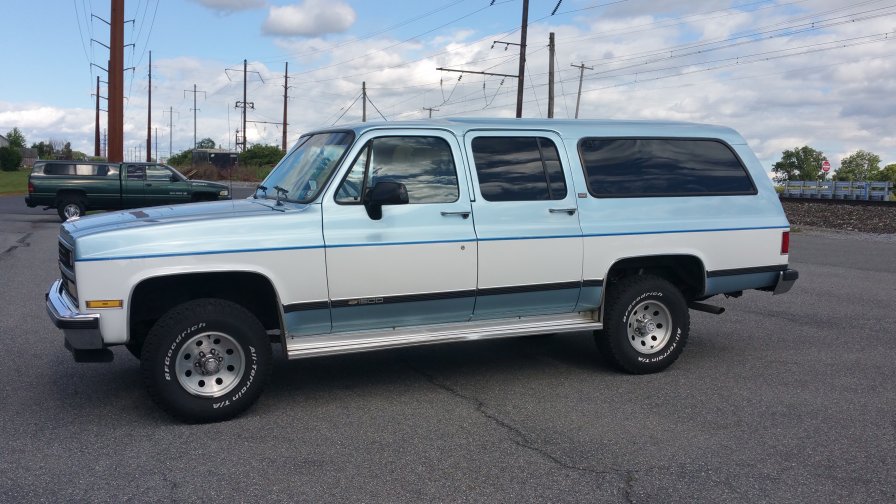

I had Firestone air bags installed in the rear and a new LMC bumper installed. The tail was sagging a bit and the bumper took a hit from the PO and was slightly higher on the right. I wish I could find a new bumper cover. The Firestone kit wor ks great.
Tom
That sure is a nice looking Suburban!
