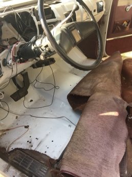

Pulled the seat out and started tearing out the carpet. Surprised at what I found under the carpet.....clean and rust free. Going to save time and some money.

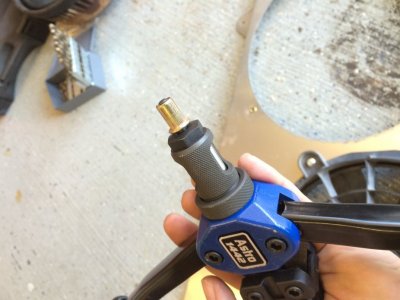

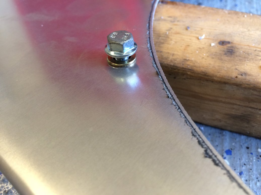

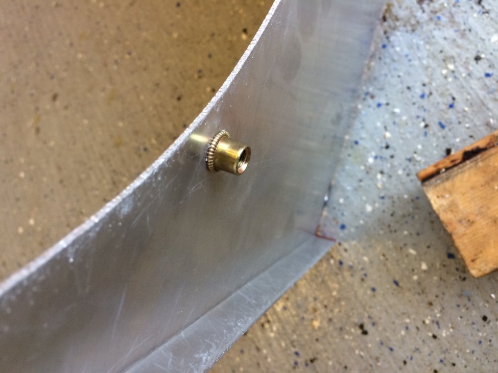

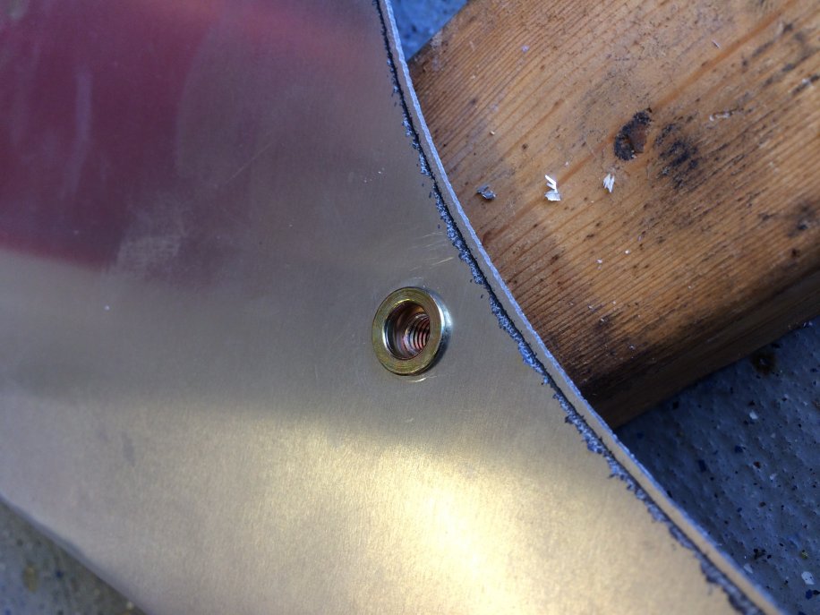

Upgraded my fan shroud to use rivnuts for ease of removing the fans, and ordered LT1 Camaro fan motors. I pulled my fans from a 3.8L V6 Camaro, which apparently have a different motor (same physical size, different internals). Having now had hands on with both V8 and V6 fan motors, the V8 motors definitely have more RPMs and thus more airflow.
The rivnuts will make my life easier. As it was, I had some M6x1 bolts with nuts and lock washers to hold the fans to the shroud. Downside was that I had to remove the entire shroud and upper radiator bracket to get the fans out, since I have to get to the backside. With the rivnuts, I just pull the bolts out and the fans pop right out.
