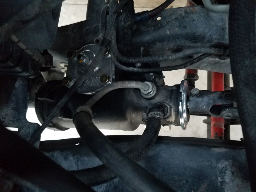

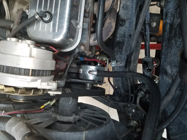

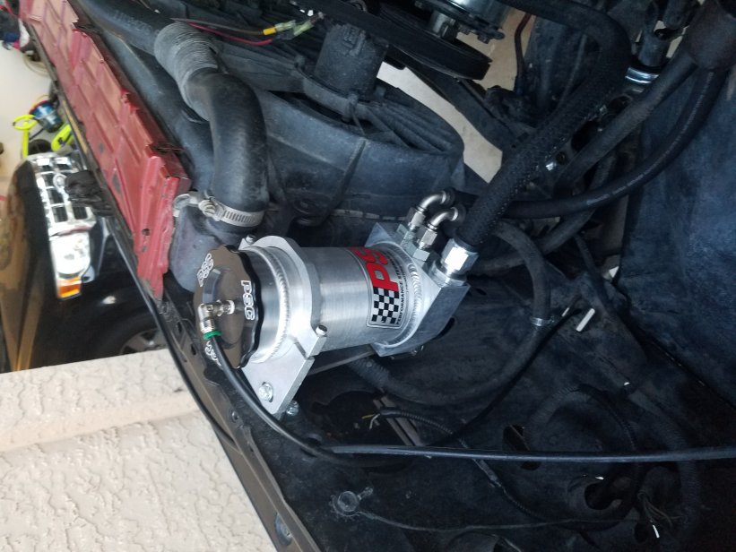

Psc power steering pump, remote res, ported gear box for ram assist. Getting ready to mount ram .

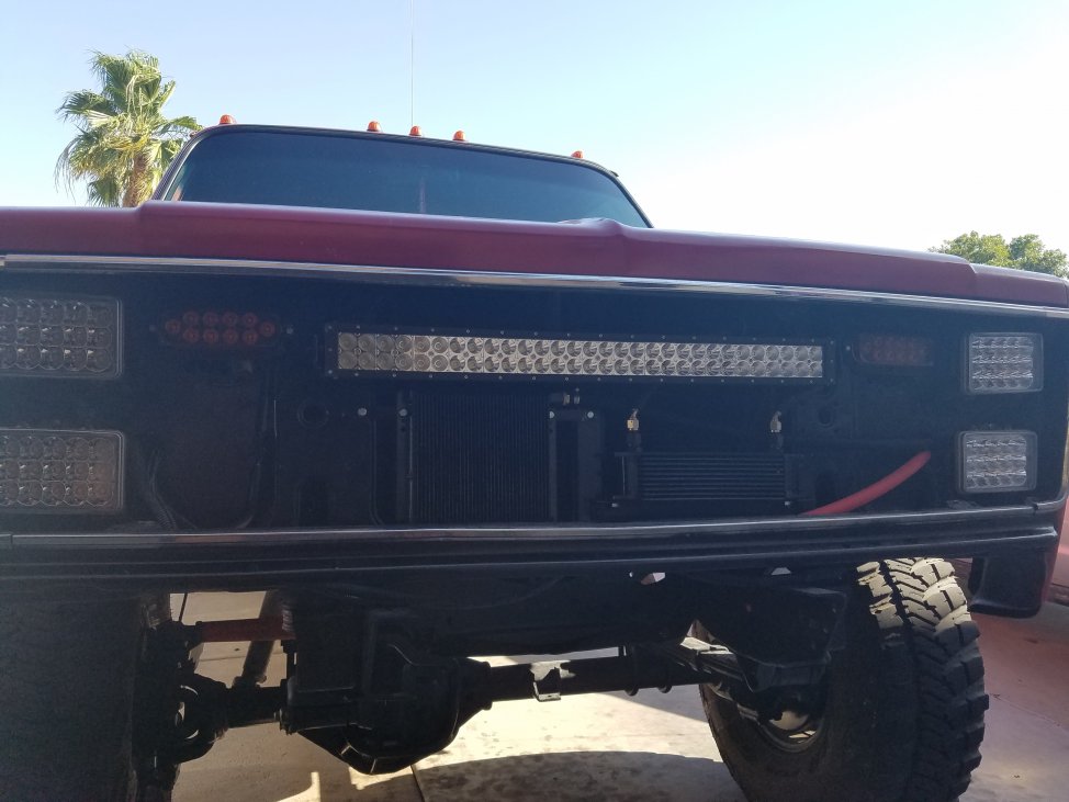

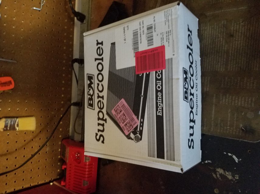

B&m cooler
B&m oil cooler tryin to beat some summer heat.

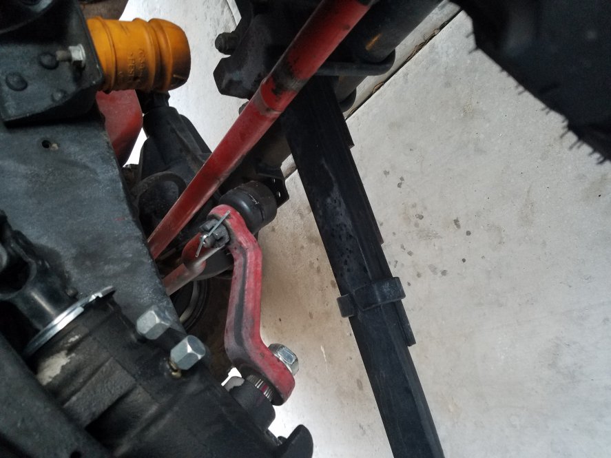

Ord high steer

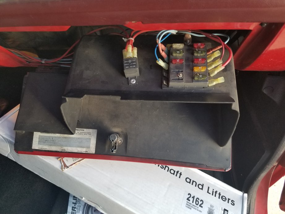

Thats what i did added a power block on top of glove box.
For all the little things.

I like that location. Is the relay for the strip or something else? I was planning on putting a relay in to control power to it.

It runs my fuel pump theres a switch on off under dash.
The light bar has its own wire harness with relay.
I use it for the cig lighter, a few gauges, cb radio, consant power to a few other things works great couldnt tell you where i got it from

Put oil cooler on today was prety easy we will see if it works tomorrow. Also just got my perfomer plus cam and lifter kit and timing set today should go in, in a couple weeks

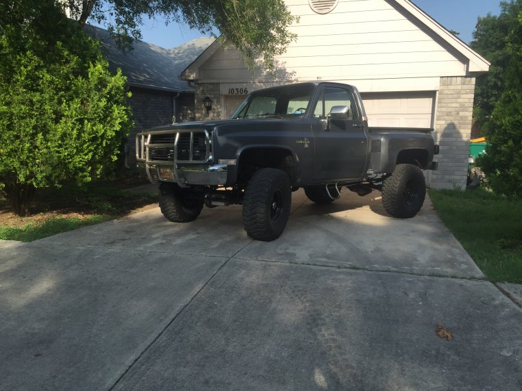

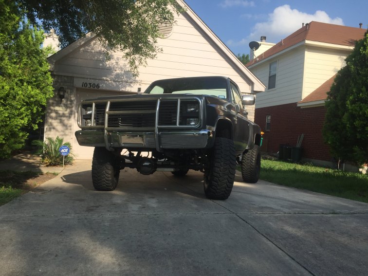

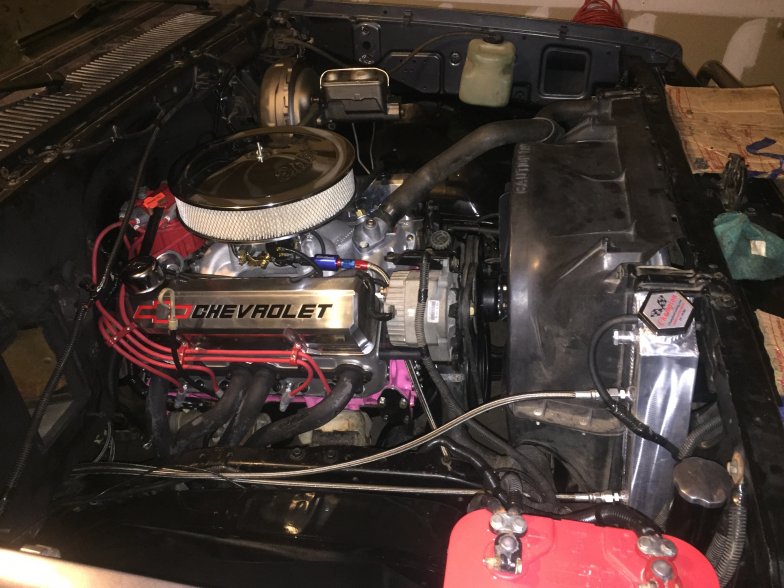

Fighting my crap idle circuit on the 1411 750 Edelbrock carb! Don't get this carb if you have a long duration cam. Just get a EDDY 650 or Holley brand carb. I'm learning my lesson right now. Only runs right with mechanical advance ONLY and no vacuum advance. But I love her regardless!
