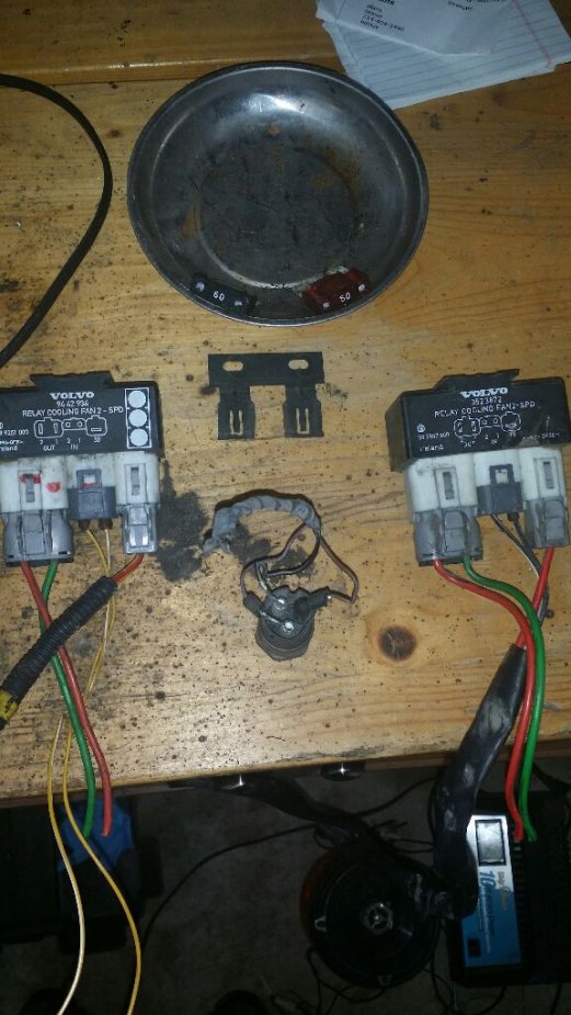

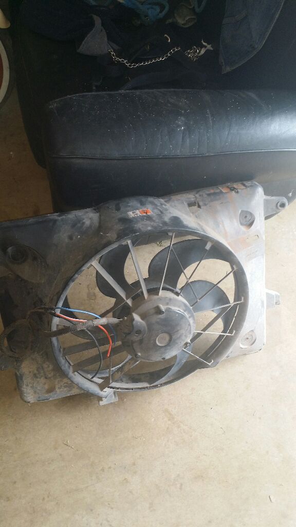

Went to the salvage yard Friday and picked up two Volvo fan relays, a bmw coolant temp sensor, couple fuses, and a radiator cooling fan from a 200? Crown Vic. Had it in the same day. The fan shroud was too deep so i ended up cutting the sides down so the fan motor wouldn't hit the water pump pulley bolts. This are the links i got my info from http://www.jeepforum.com/forum/f12/volvo-fan-swap-1373350/#/forumsite/20623/topics/1373350?page=1
I'll be going back to find the temp sensor adaptor for the radiator hose. I have it installed currently and will say it cools way better then the factory setup. Mpg have gone down a pinch in traffic due to the amp draw the fan puts on the alternator. Hp is marginal at best. Kinda like changing the oil after it's been a while. I currently have this setup controlled by two toggle switches while keeping an eye on the temp gauge. Couldn't find the Taurus fan or Volvo fan. All in all I'd say (Don't fix something that isn't broke).
