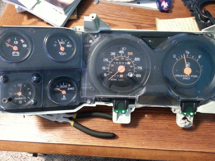

Cluater mix n match complete, i hope everything works. The traces looked like they all went to the same places, the warning lights under the speedo were different so i swapped mine over. I swapped my unleaded fuel gauge, cuta hole for my clock connector, and fixed trip reset. Also the odometer magically dropped to zero......
No idea how many miles are on it anyway, and it isn't needed for title in my state

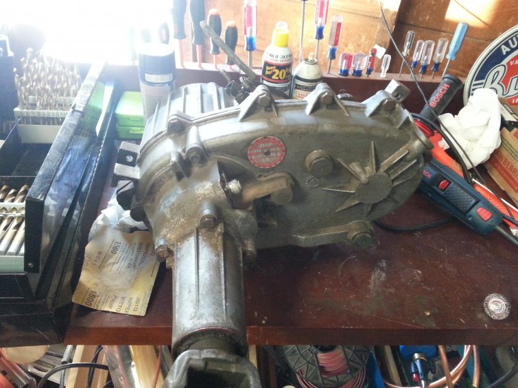

Cleaned my 241c. Everything was sealed with rtv, no not sure of it has been opened or that is factory. I hope it doesn't leak, going to fill it and see of it leaks on thy bench.

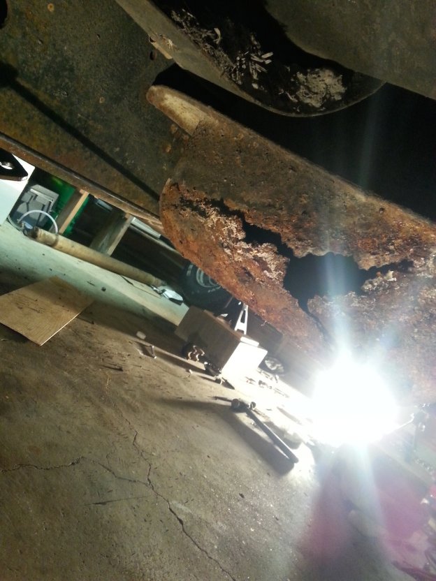

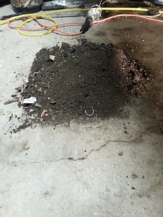

pulled the plastic cover of my drivers side tank. found about 10lbs of dirt and this, pretty sure it won't hold fuel....

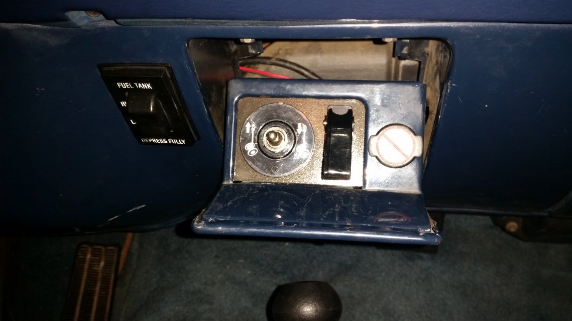

Installed an in cab control switch for my winch. Since I won't be taking up smoking, I decided to put the control toggle and the switch to arm it in the ashtray. Spaced off the light to show is armed... but I'll add one soon. I tried the toggle mounted up and down, but the ashtray would close when I pushed it up, so I turned the switch 1/4 turn, used the face plate of the controller and now the toggle works side to side.
