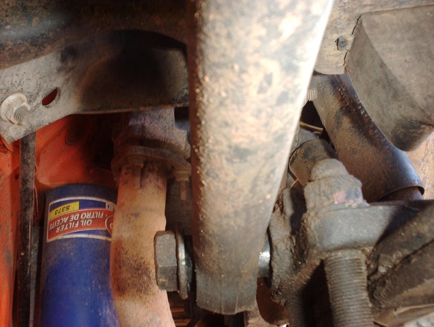

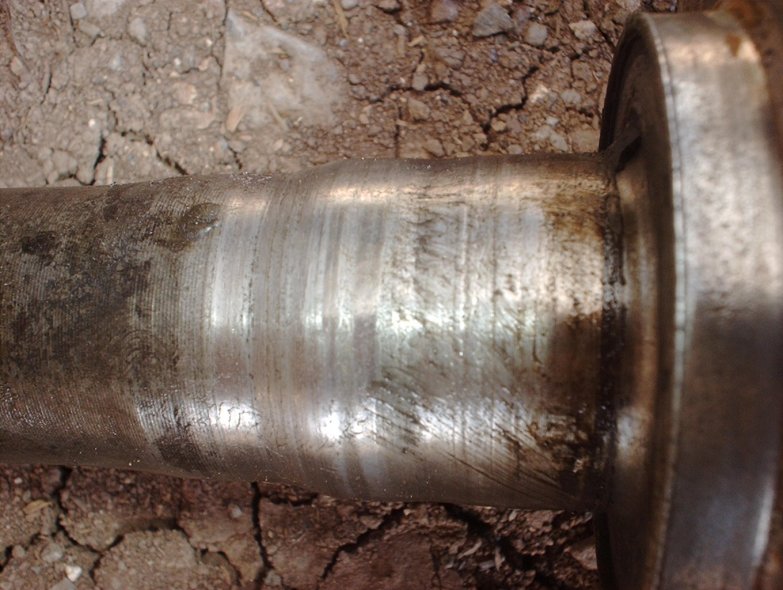

I started taking my front axle apart so I can install a limited slip in it.
Discovered a missing sway bar bushing when I was jacking the truck up to put it on jackstands.
Found the LH wheel bearing outer locknut had loosened and backed off, and shaved a little aluminum from the inside of the locking hub.
I hope it won't affect it.
The inner locknut unthreaded partially off, then stopped.
I had to use a 1/2" drive impact to get it off.
Good thing I have a spare set of good spindles and nuts.
Here's a couple pix of what I saw.
I'm not going to use that axle shaft, I have a good set of used ones already.
