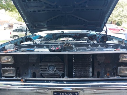

Man, I've got to paint the rust behind her grill. Too obsessive not too. I have to work around the driver though. She said she has to take it to do farm chores later.
Got to do it right.

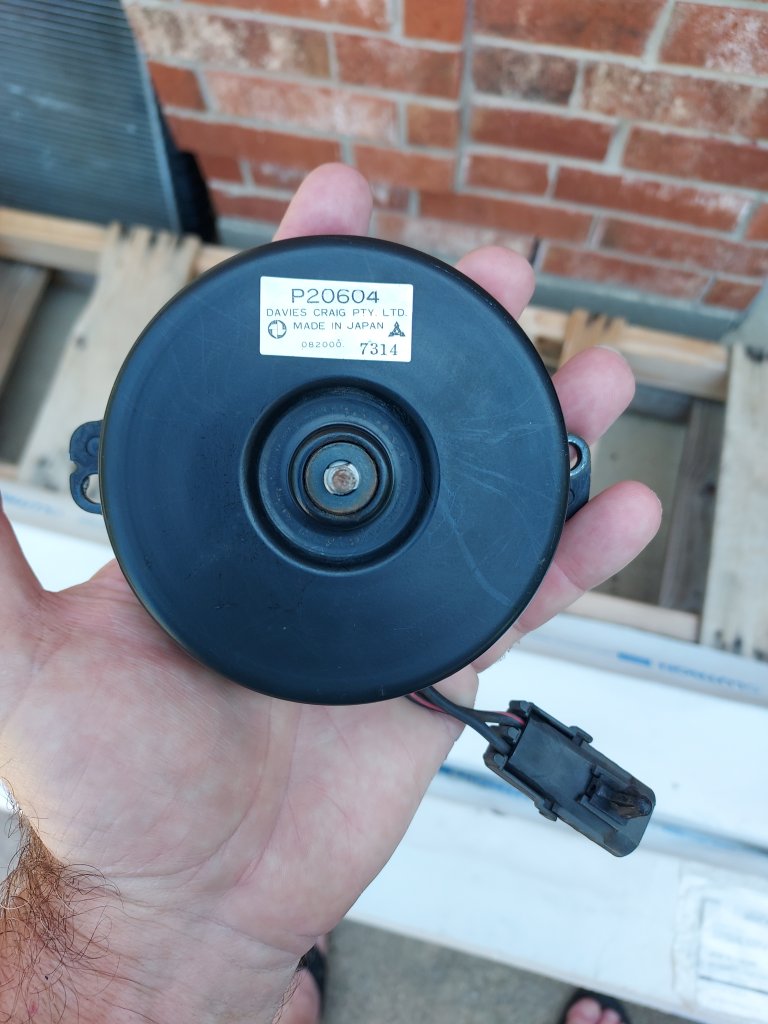

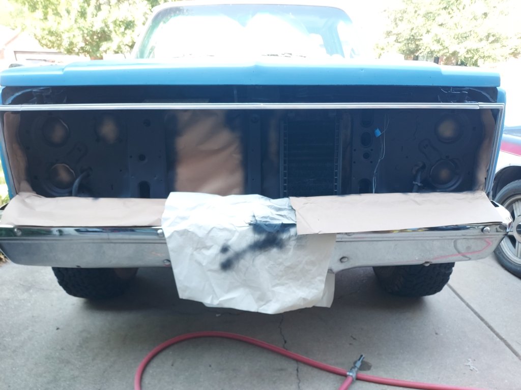

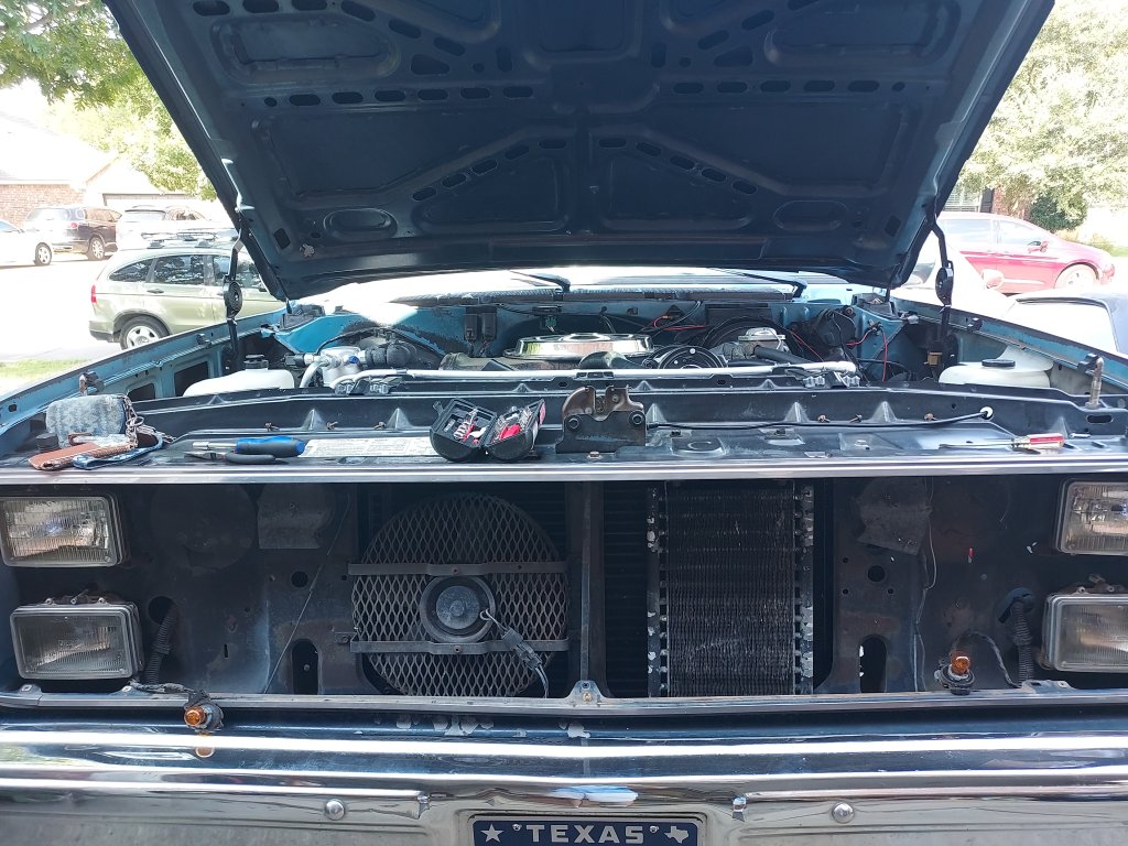

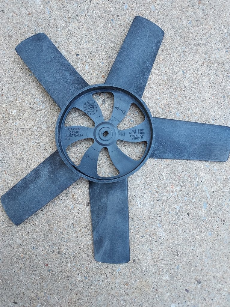

Rust reformer applied where needed. I will throw on some satin black caliper paint after wipe down. Quick easy.
Also thought aux fan blade from Australia cool. Motor Japan.

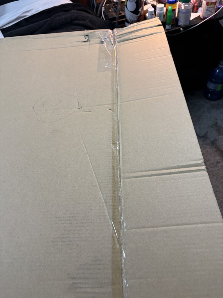

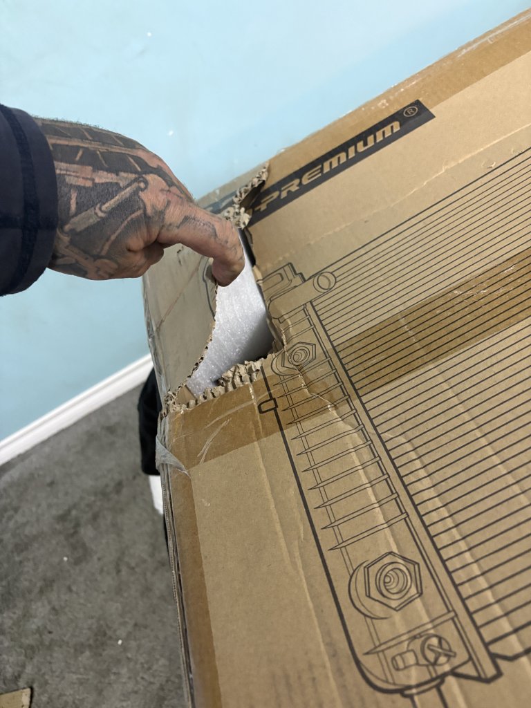

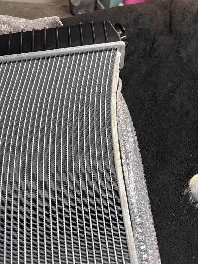

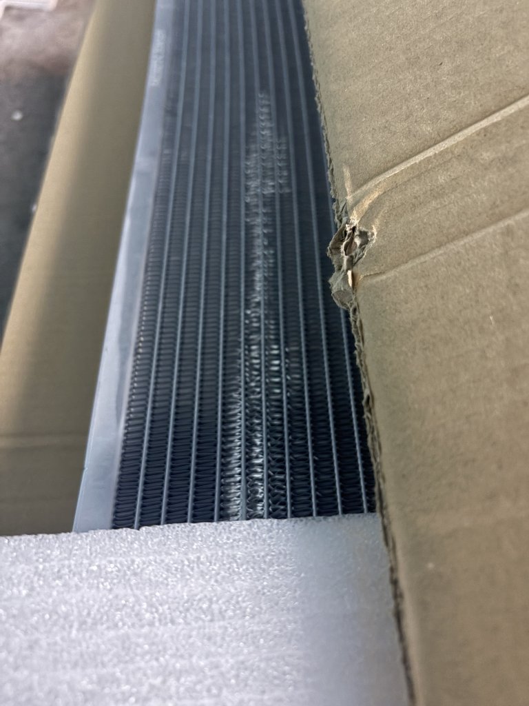

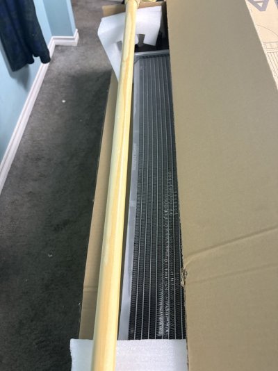

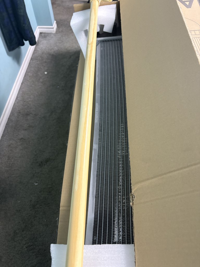

Over two weeks I’ve ordered 2 rads both bent vertically - thanks Bezos workers for doing right! lol see what the third turns into
I didn't risk it due to fins and went and picked up at a summit. Don't know if that is a realistic situation for you though.
