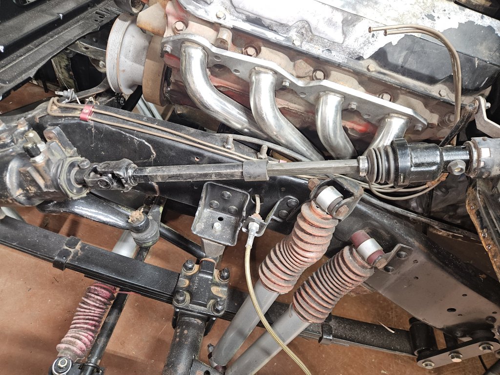

Tried the C3500 intermediate shaft. I used a 88-2002. Got it in a salvage yard 25 bucks. Had to do just a little grinding on the stub shaft on the steering column. Worked out great, and got rid of the rag joint...

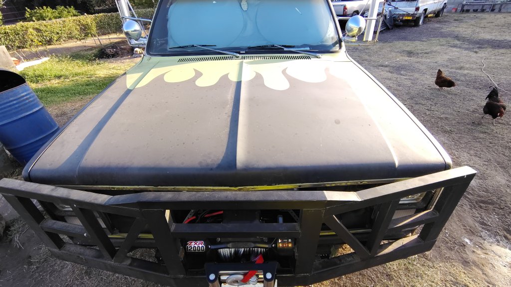

Got everything mounted up and wired today just got to figure out what to do with the grille I'd have to chop up the stock one pretty good to fit and it's not in great shape and is 83 hard to replace so might have to make something or maybe get another grille to chop up instead
I need to do that...
I had a rag joint disintegrate after getting off the freeway doing 100+ mph. At that speed I wouldn't be here. It's a weird feeling when you go to turn and the steering wheel just spins...

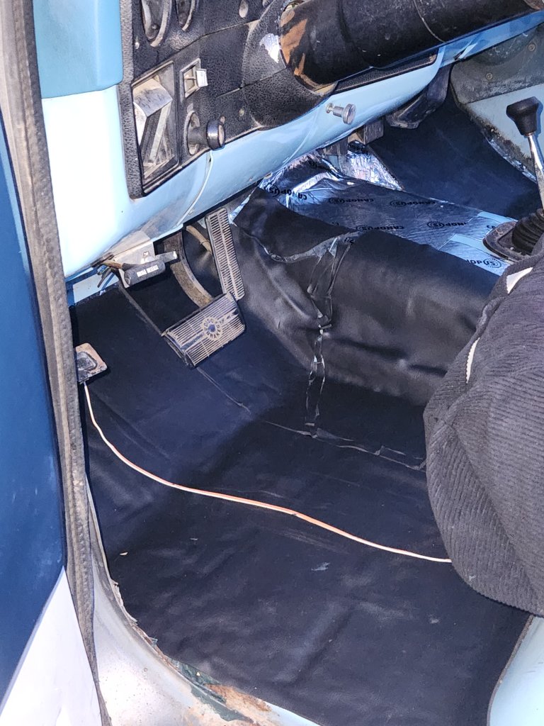

Almost done with the flooring. I addressed rust in the pans, put down layer of Canopus 50ml sound deadener, and then 1 layer of 4mm closed cell foam. These will be topped with LMC's MIP floor mat.
