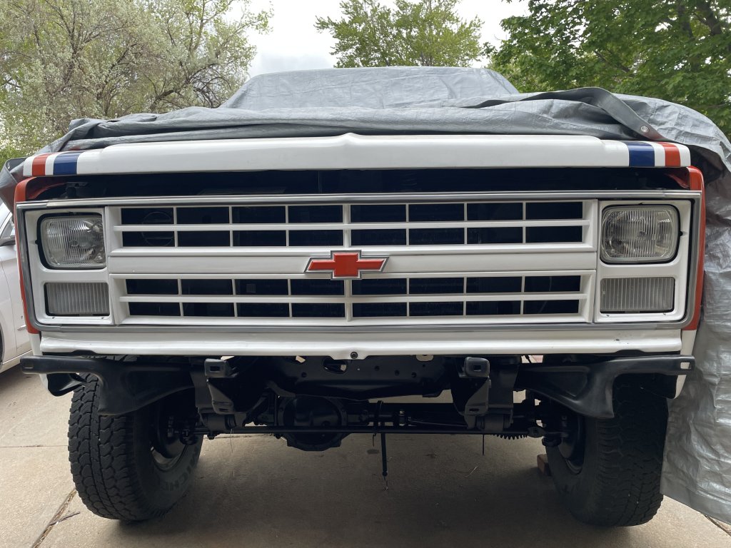

Installed 85 grill and trim on my 83 to maintain Frankenstein status. It will need a little white touchup paint.

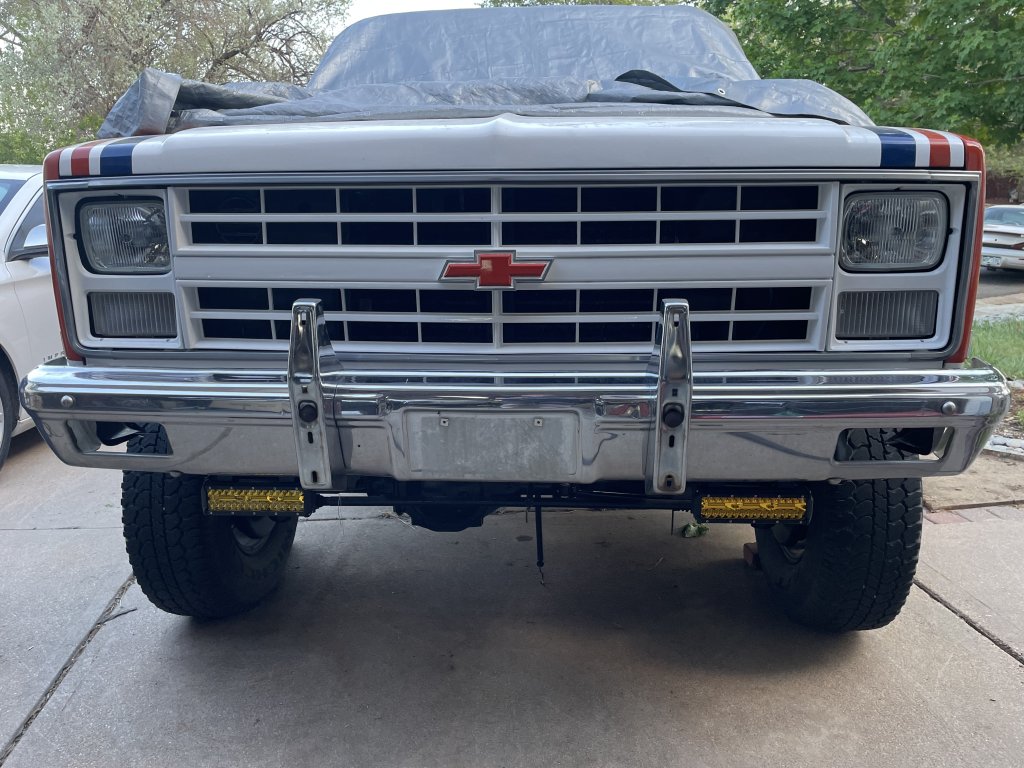

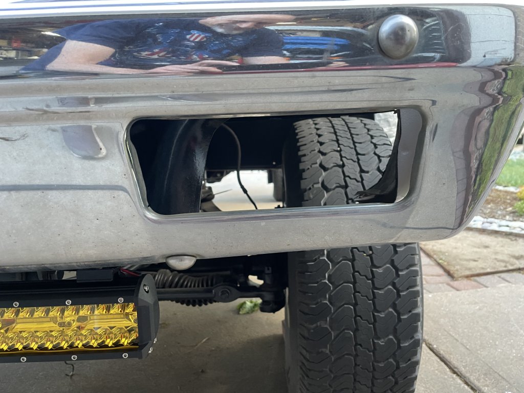

Bolted the bumper to determine if my fog lights would fit in the 82 bumper turn signal holes. It will require some metal cutting and welding of the bumper bracket which I don’t want to add to my to do list so I’m gonna look for a different solution similar to newer trucks with a circular light in the middle of the cutout. There were some holes along bumper bottom so I bolted them up to see if they could be mounted there, not sure I like them mounted there.
