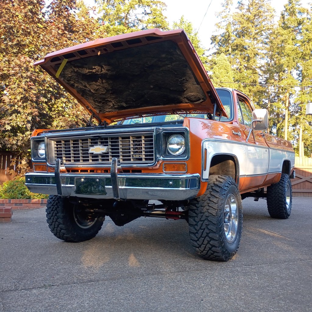

Several little things hammered out on the 73, the dash gauge bulkhead connector is missing a tab so the blinker indicators and the temp gauge weren't working....tied it in place, problem solved. Still don't have a working fuel gauge. On my list. The pcv was popping out of the valve cover on a fresh engine. Replaced the grommet, problem solved.….and the spark plugs look next to perfect now.
