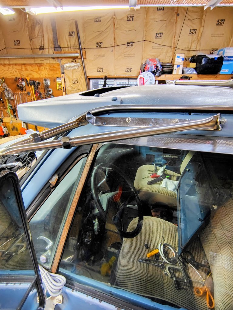

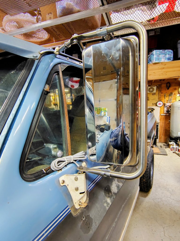

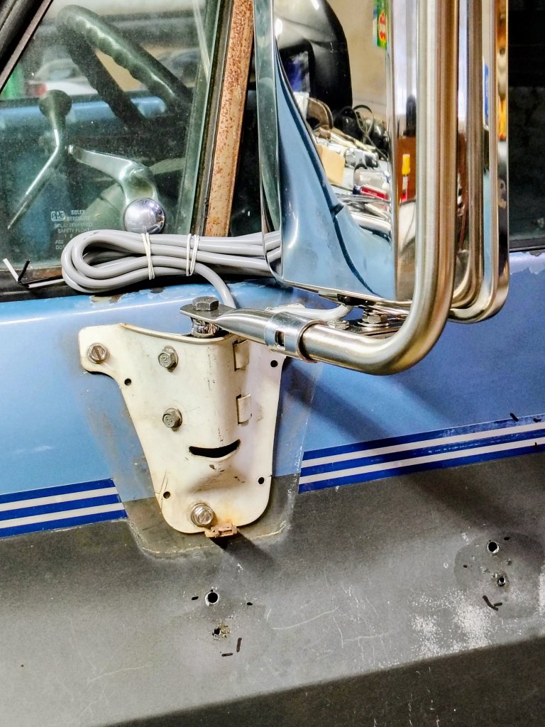

went a different route on mounting the mirrors.wish I had thought of this prior to drilling a couple holes!! I am using the stock mount for the lower portion and then some aftermarket brackets for the upper. Much more solid!! I am going to use bolts and nuts to mount the bracket to the door,don't want the stock screws to loosen up. Had to order new gaskets that go behind the mount since I tossed the old ones ,thinking I would not need them!! Brilliant!!

That's kind of genius.
