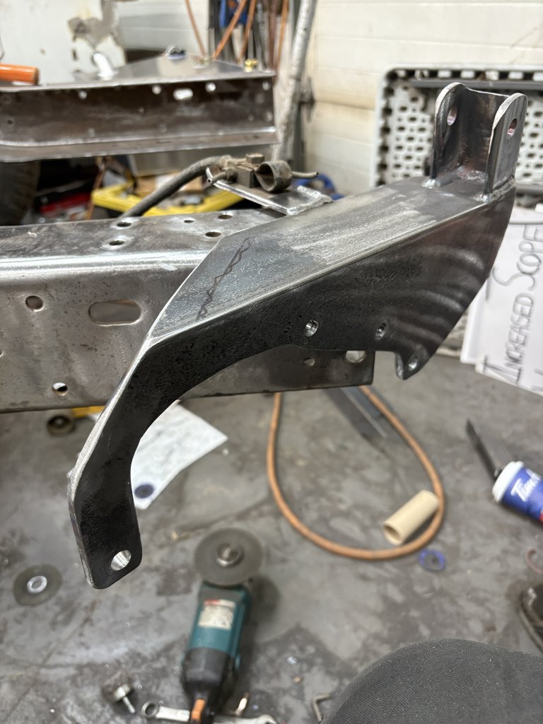

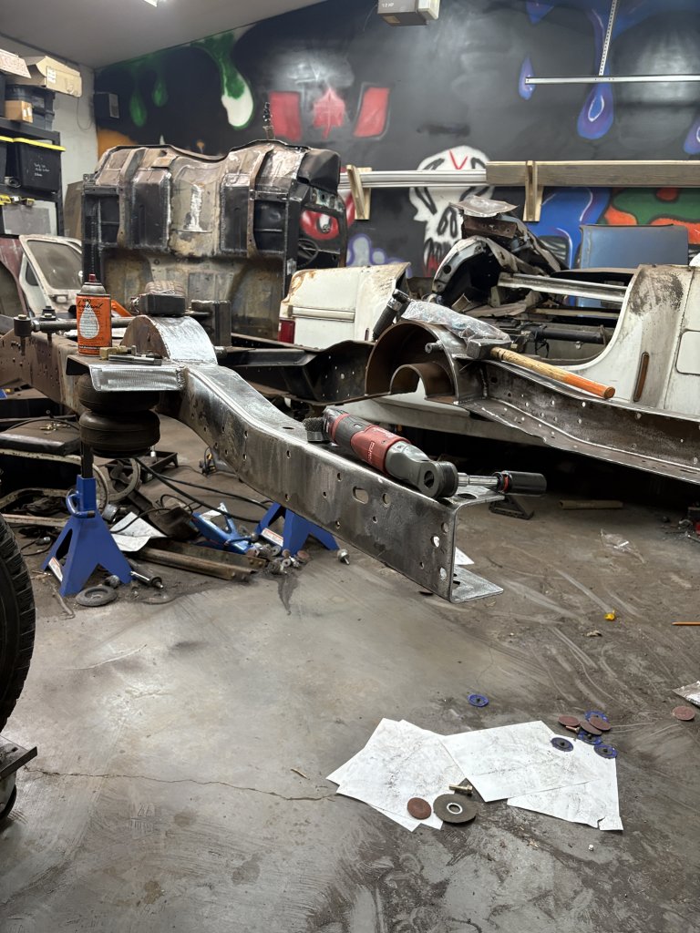

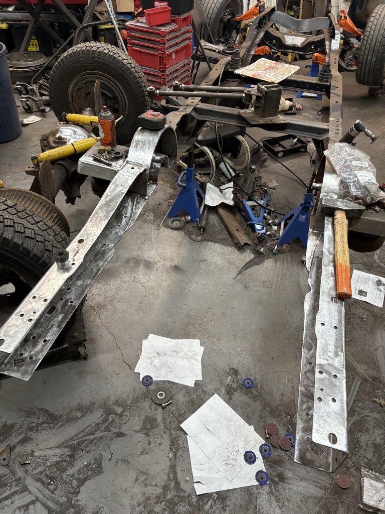

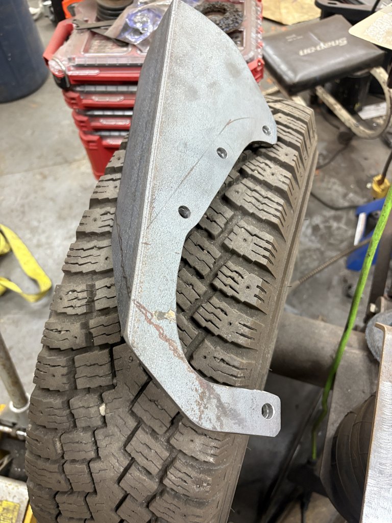

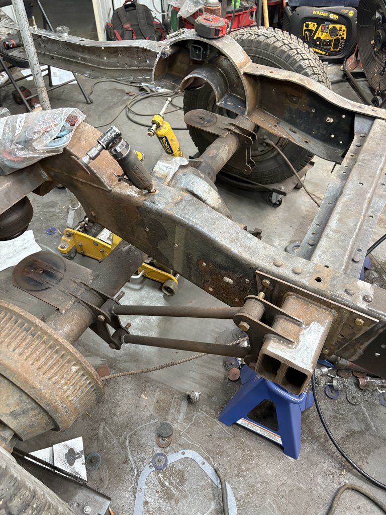

Still cleaning the frame had to move my pan hard bar and fab up a bracket for the new fuel tank

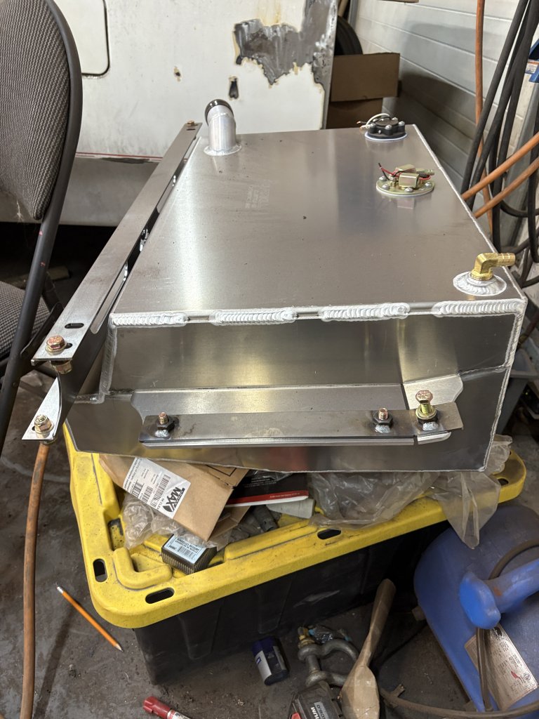

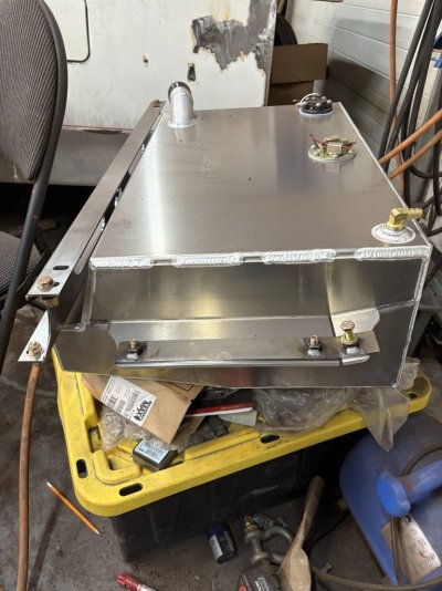

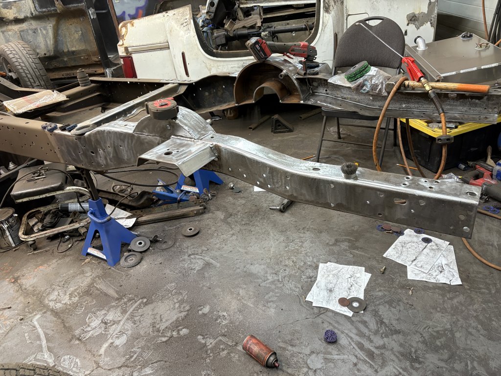

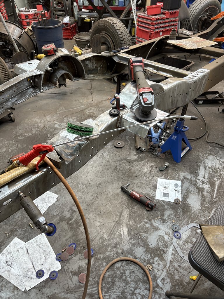

Side rails and top cleaned up today - fuel tank is a overkill customs tank from red deer specifically for a long box, replacement cross member came with the tank with in tank fuel pump, sending unit and is vented with a offset fuel spout.
