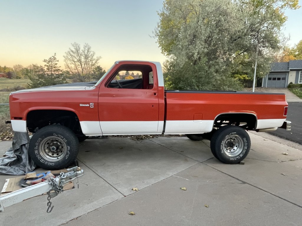

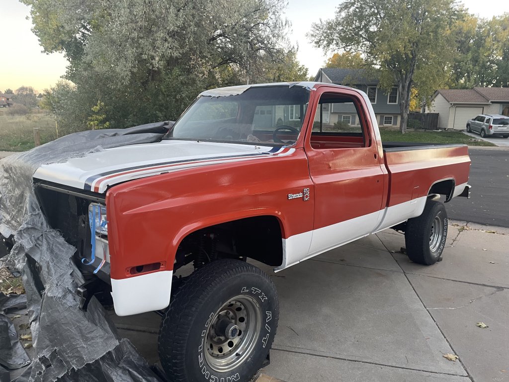

Test fitted the left fender with the old skool emblem taped on. Gonna need a few shims for door alignment but pretty good. The hood gonna need some adjustments as well. It’s still a 20 footer, paint actually matches pretty well for panel spraying, but the orange peel is a little off and I have no plans to flatten it out.

There comes a point to where you must decide "is this going to be a pavement princess or a useful truck". I'd much rather have a nice 20 footer than a truck that I had years into restoring and was hesitant to use. I posted a pic of mine yesterday and it's definitely a 20 footer. Most folks have no clue as to how much time, energy, resources and CASH it takes to fix a vehicle to "new" condition. Keep the pics rolling and let's see the finished product.

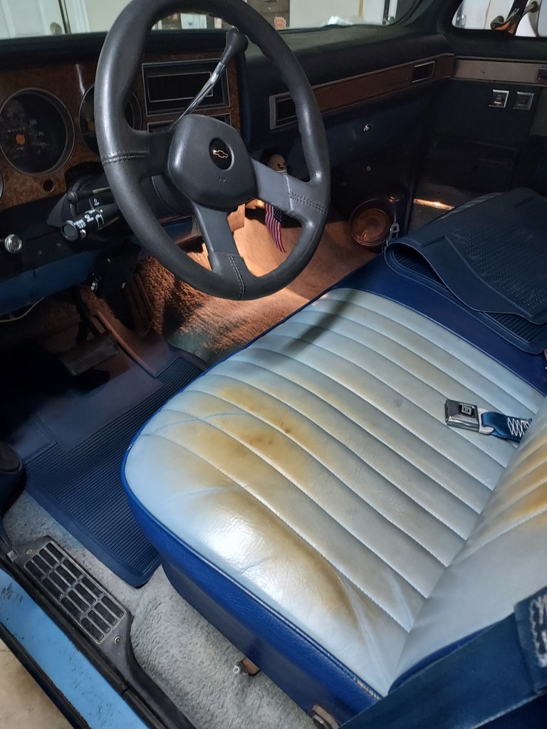

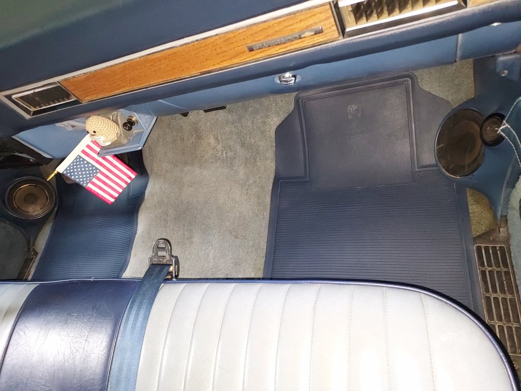

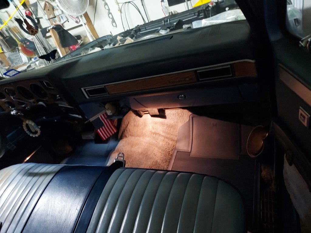

Okay, caught up on your posts! Sorry, not sorry for the likes and what not.
Got some rubber floor mats for daughter's truck. So close to driving to school, Lol.
Note: At her school, square body orange and white Ford? And a Doge truck, all driven by girls. ;):)

Gotta say that cavalier steering wheel is nasty.

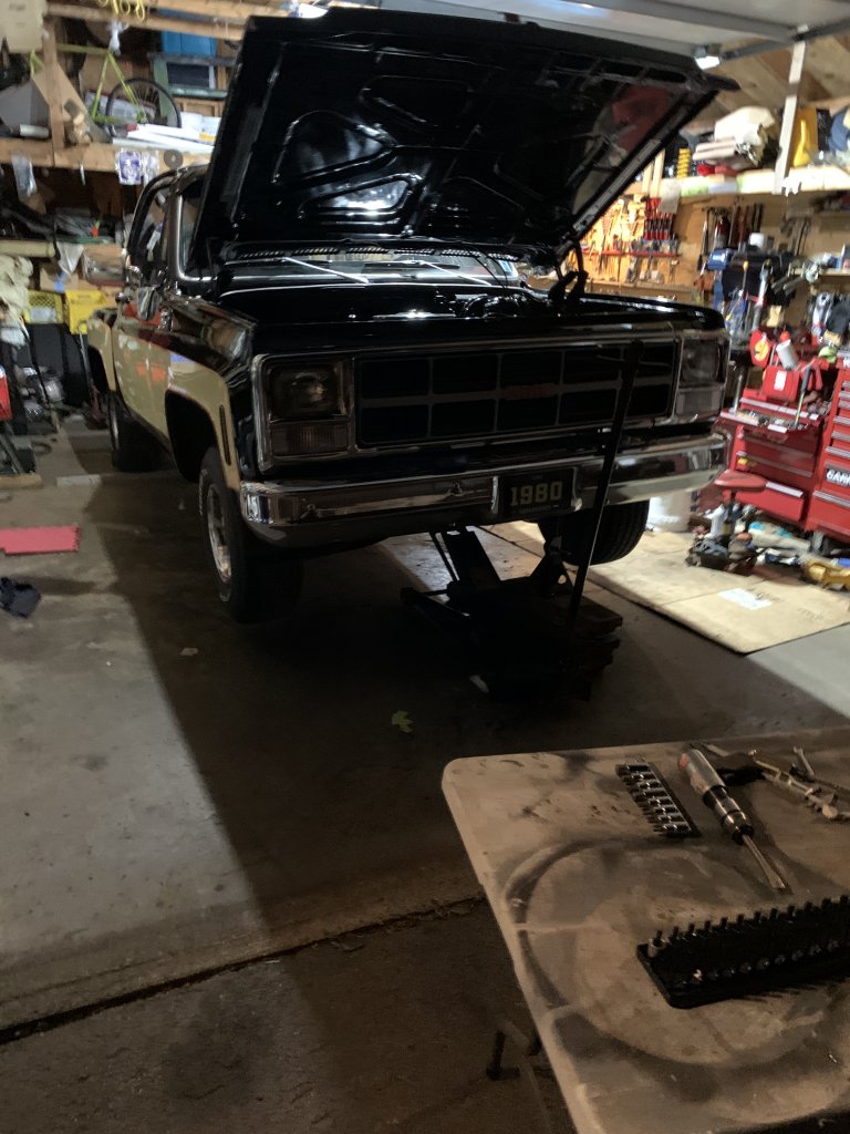

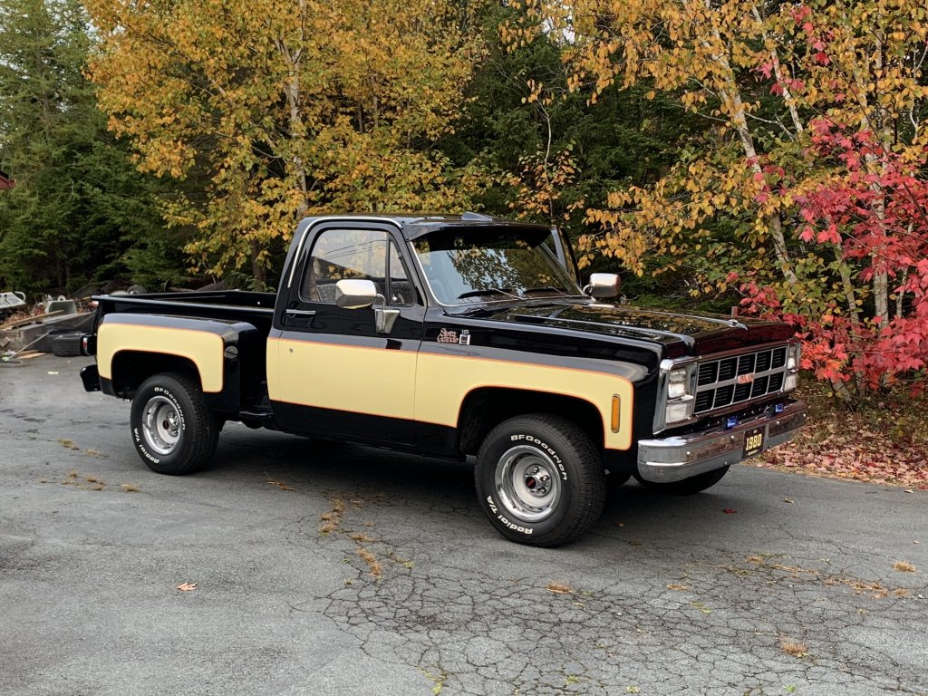

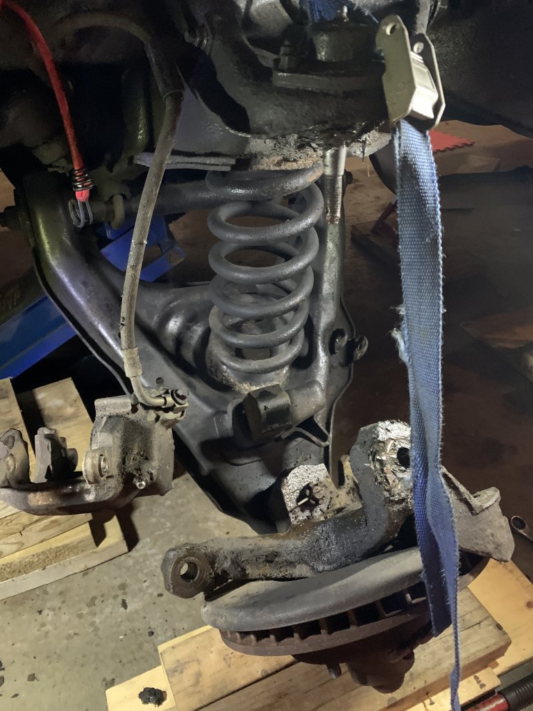

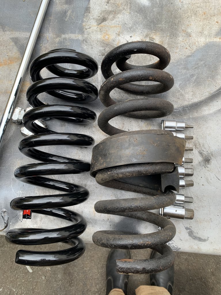

I have never been happy with the stance of my truck since I bought it. Front was low compared to the back, and it was over 1/2" low on the passenger front compared to driver side.
I have been considering dropping the rear to level it out, but after noticing how rusty the front springs were and that the previous owner had at some point installed a spring spacer on the passenger side, I thought it would be better to get some new springs installed before I make any other decisions suspension wise.
I bought a set of regular springs from A-Premium. These are equivalent to the Moog 6452 regular springs.
This was my first time replacing front springs and will say it was a pain in the ass and took much longer that it should have to get them swapped. If I got the springs in the top pocket they would fall out of the bottom groove and vice versa. Eventually everything got installed but another floor jack will be required in the near future.
I expected some lift from the new springs but never expected what I got.
Driver side was raised 1-1/2" and the passenger rose 2". Better yet the truck sits level in the front with less than 1/2" difference front to back where it was over 2 inches before the work.
Truck feels more stable side to side, with much less dive under braking. We will see if they settle any over the next few months.
