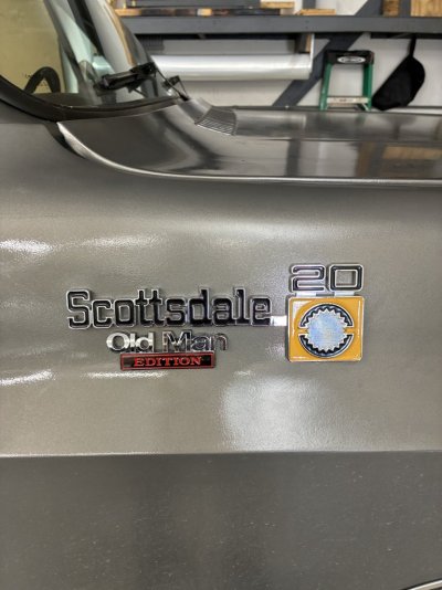

While recovering from Covid I got some of these cheap emblems off of Amazon.

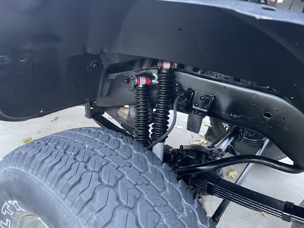

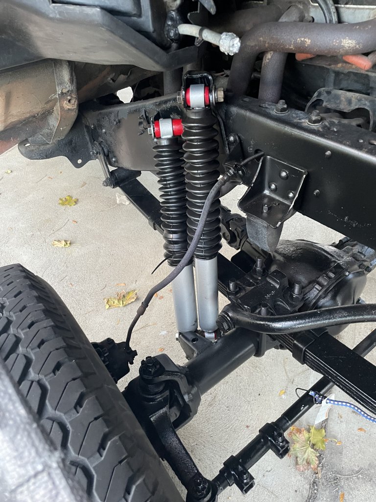

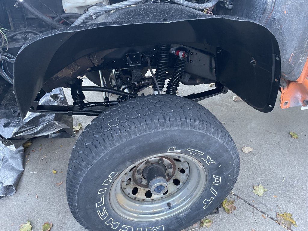

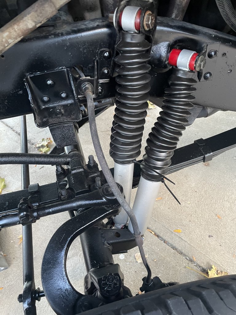

Installed the front shocks and put a few bolts on the wheel wells. The driver side shock doesn’t fit nicely under the wheel well like the passenger side does. Is that correct or do I need to make some adjustments when I get the fenders installed?

Interesting that your inner mount is so much taller like that.. I think mine are equal height (both about the position of your lower one) Hmm.
The shock mounts are about the same mounting height so I think it’s more related to the inner fender mounting and/or the inner fenders are slightly different for each side.
I just meant they are different locations..
Super old pic, but you can see mine are at the same level - that's all I meant. They basically use the same bolt to hold both in place (both down lower than the inner fender)
The factory quad shocks are setup with the add on shocks on a taller separate bracket, that kind of tucks behind the inner fender well.
If it's got rivets, it's factory.
Mxers first pic is factory quad shock brackets.

It’s factory riveted.
