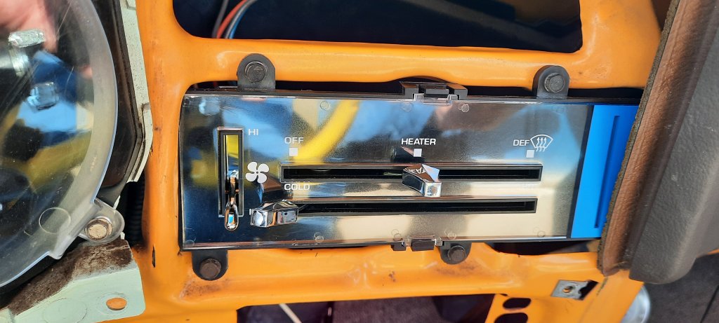

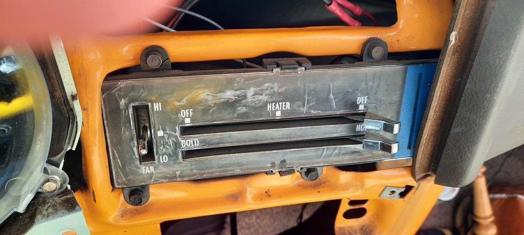

1978 C15: Just pulled the "3 speed," constantly on heater control unit and installed a 4 speed version from LMC Trucks The 3 speed had been beat so bad it looked like a non-survivor of WWIII. And the switch only flowed at one position.
I cut the brown lead from the heater resistor low speed circuit loose from the input terminal from the fuse box (both were brown leads and I left the one from the fuse unscathed at the connector plug).
I moved the heater resistor brown lead to the middle terminal, which gets power when the switch is in the second switch position.
I have the blue lead at the outer side-by-side terminals, for the medium speed activated with the switch in the 3rd position.
The orange, top terminal, where the brown leads were, is the high speed, 4th switch position.
The brown lead from the upper, stacked terminals coming from the fuse is, now, moved to the terminal that was under it.
This gives me off when all the way down.
