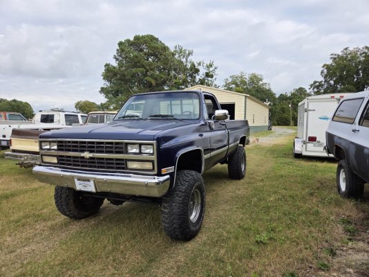

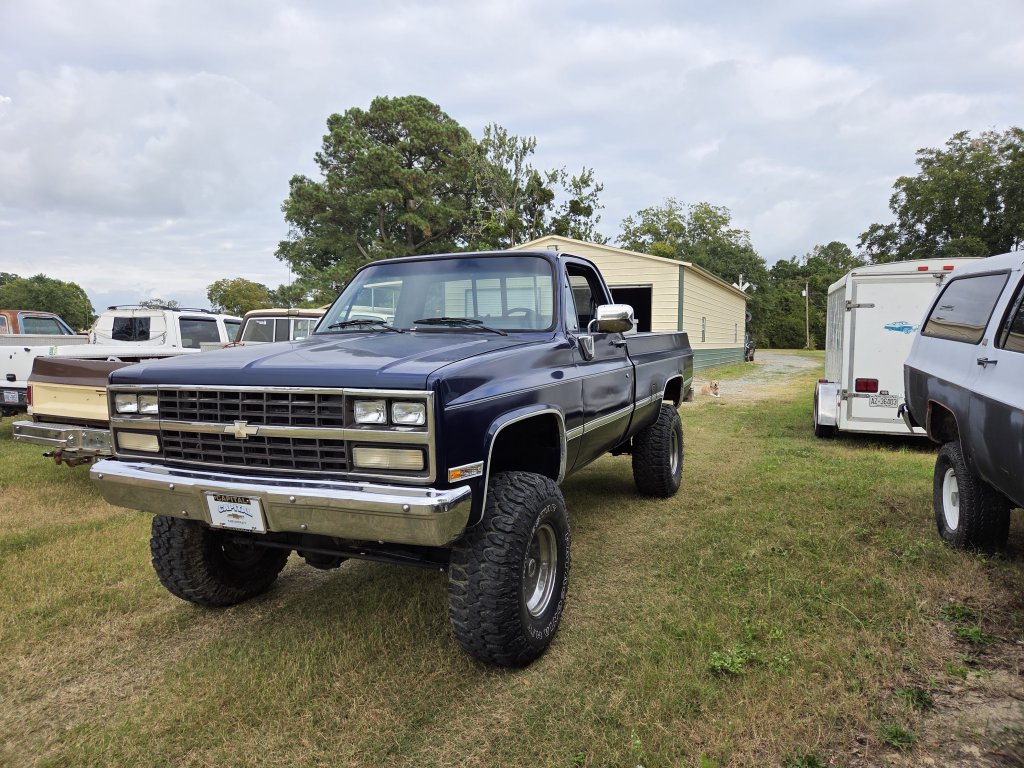

I took a few minutes today & swapped the PCM from my parts 91 Sub over to my 87 V10 that I have recently upgraded with 4.56 gears, lockers on both ends & 6" lift with 35x12.50's.
It has been running terribly rich with erratic & surging idle. It never had a DTC or MIL & I figured the Atari cartridge was bad.I swapped PCM's & it coughed & then cleared. I gave it a test run & it will now blister these Patagonia tires on thru 2nd gear.
This truck has a new ECT & wiring & had a TBI in the floor when I got it. It has ran horribly this whole time but it has been sitting in the shop & field for most of the 2 years I've had it. I'm just getting time to work on it again.
I wish I could upload a video of the hard pulls this truck can now achieve.

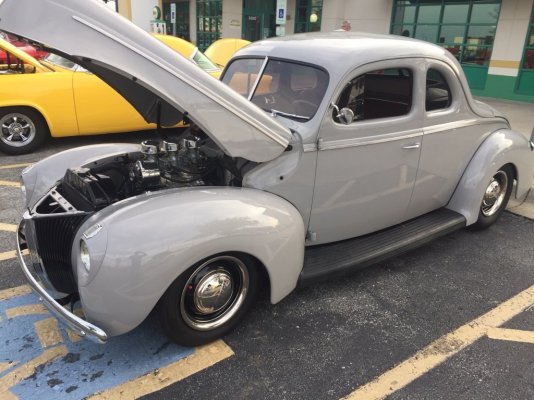

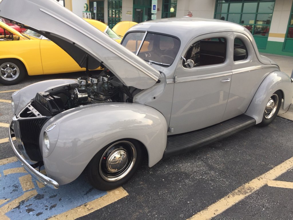

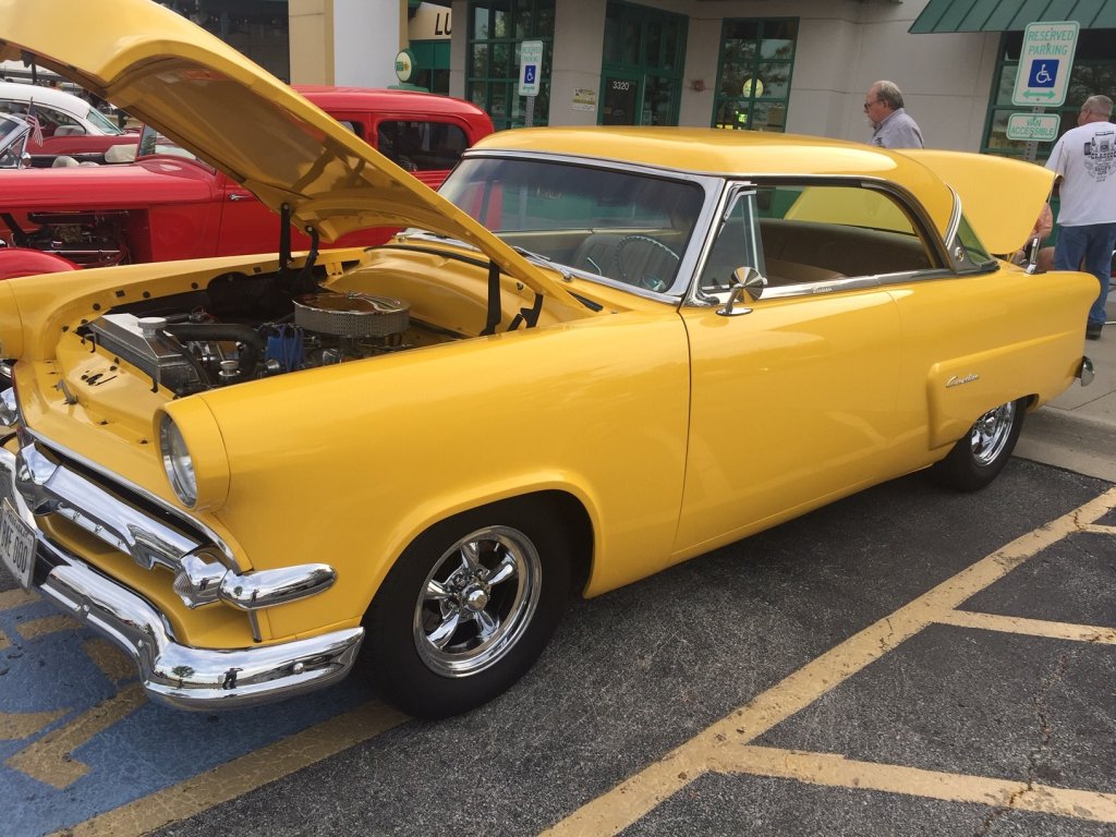

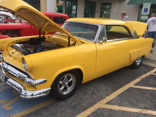

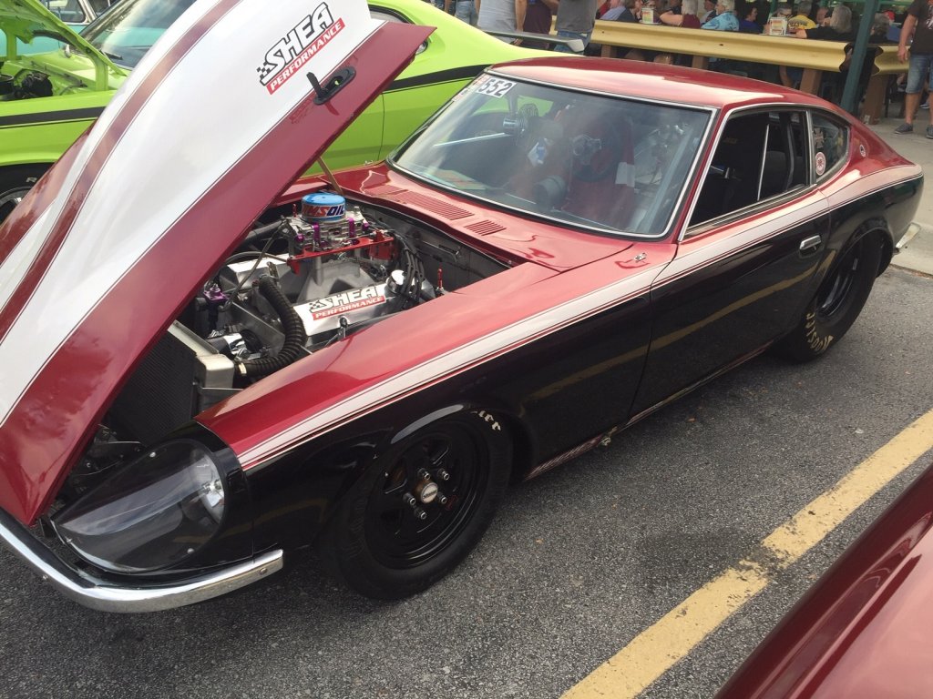

Took the old girl out for a beer to a Quaker Steak Car Show.
Good turnout, about 150 rides.
Here's three samples, the Datsun was sweet.
