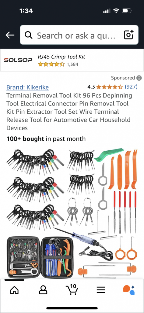

Get your self a pin removal tool for gm off Amazon replace the blades, super simple- even I can do it.
That's interesting, I wasn't aware of such a tool but not surprised. I will look for one because the $700 for another complete harness, while probably a good idea to replace the 46 year old brittle wiring, needs to be a down the road thing. Thanks for the heads up.
You don't know that tools nomenclature off the top of your head, do you? Holy crap there's a lot of choices.

Not specifically but a generic kit has what you require

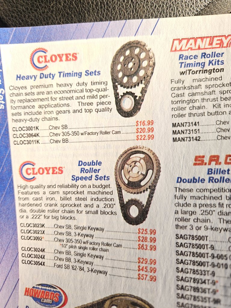

Planning/Building me a big block on paper before i buy anything. As far as timing chains... do you get what you pay for? I see 25 dollar timing chains then i see 125 dollar timing chains in the same catalog.

No that are not all the same by a long shot. Some have stationary pins,some have rollers,but all rollers are not the same some are just cut from pieces of tubing ,some have a seam because they are rolled from flat stock.Morse chain is a completely different animal and what I'd be looking for. Now it gets more complicated because 99 percent of everything is Chinese these days and some of the Chinese chains have a reputation of stretching real bad,real fast. Personally I'd be looking on Ebay for something NOS pre Chinese era,preferably Morse chain. That or research if anyone is still manufacturing timing sets anywhere besides China. Another issue some of the cheaper sets are using cast gears. Research more than just here. And just because someone has had great luck with brand xyz timing sets for 50 years. Make sure brand xyz is still the same product it was 50 years ago. I'm putting a link to some info about timing chains. The chordial motion they talk at the bottom,doesn't happen with an O.E. Morse chain. Research Morse chain. They changed the tensioner design to eliminate the motion in newer engines( not SBC)
