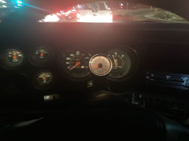

I whacked the dash at night, and all my dash lights started working! Even the HVAC. Never even seen that one on.
Sorry for the delay, just added the photo
