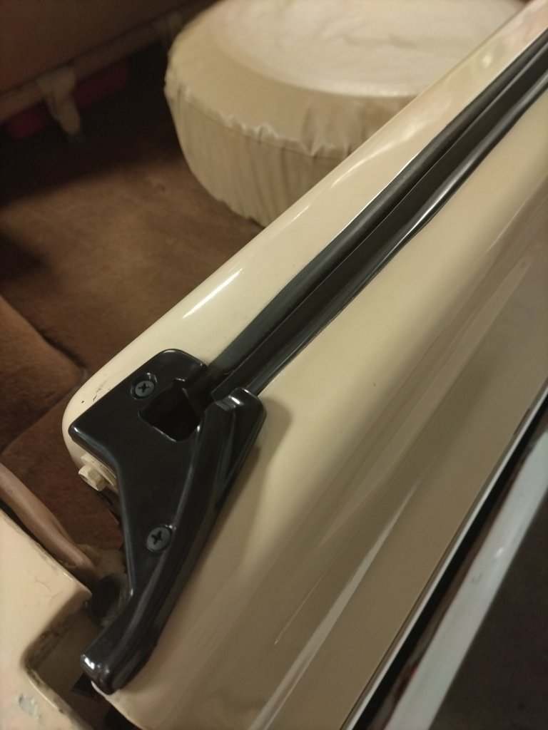

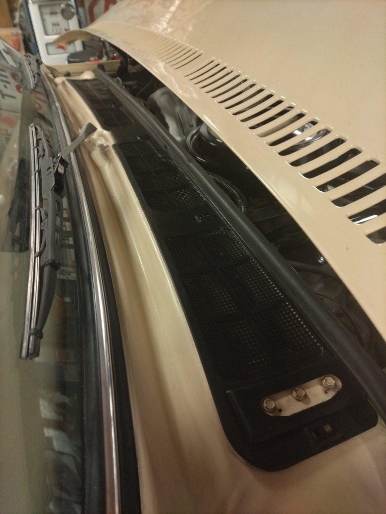

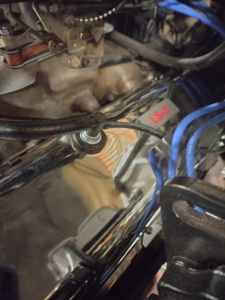

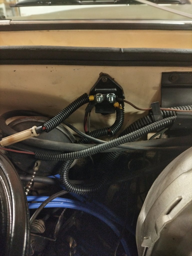

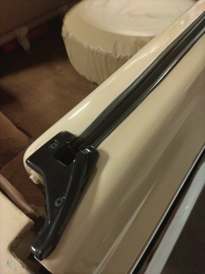

Several smaller jobs today. Replaced the cowl screen after spraying the inside of the cowl with WD40 and wiping it down. Cowl was very clean, no rust. Then replaced the tailgate glass guides as the old ones were chipped and broken. Replaced the firewall power distribution block and PCV valve and called it a day.

Curious about the WD wipe down inside the cowl. Just to keep stuff from sticking in there?

Helps prevent corrosion.
WD-40 was developed by the Rocket Chemical Company under contract to the DOD to protect the thin aluminum outer shells of nuclear warheads from corrosion as they stood in their silos. Water Displacement Formula # 40 (hence WD40) was the ticket. Eventually the DOD allowed the product to be offered commercially.

I actually knew that but had forgotten. Good point! I know alot of people also use it on undercarriages/wheelwells/backhoe buckets/etc cuz it helps keep stuff from sticking as bad

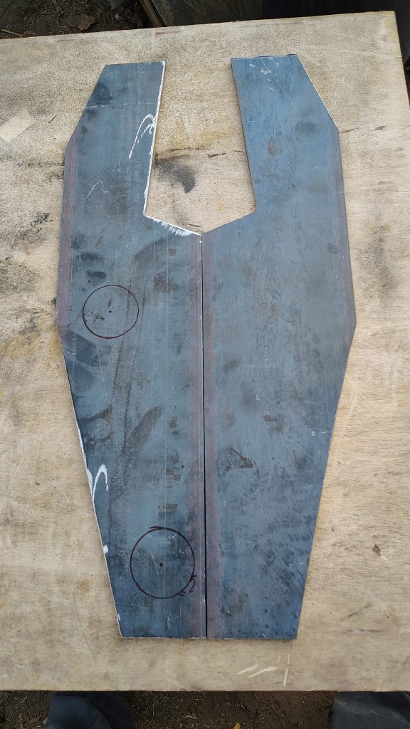

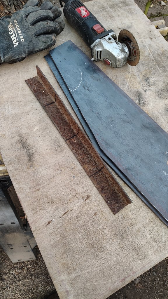

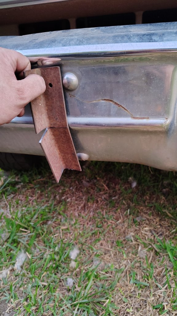

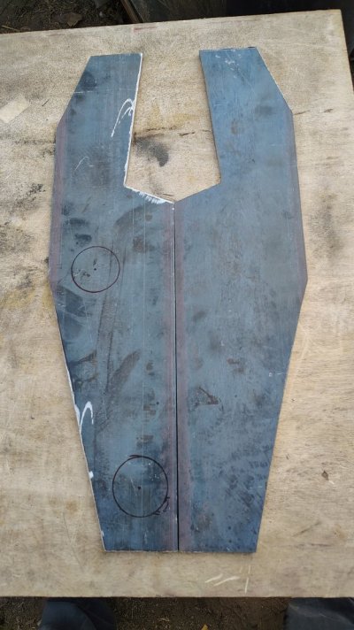

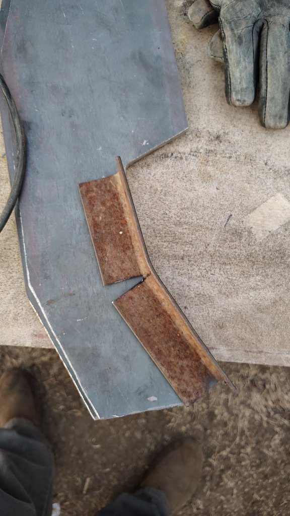

Progress on the bull bar I used 1/4"×6" plate 2ft Long each some scrap angle iron for the mounts and some 2 1/2" scrap pipe and some tabs for the lights getting dark so will continue on tomorrow

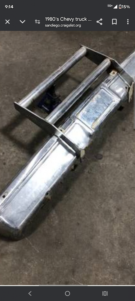

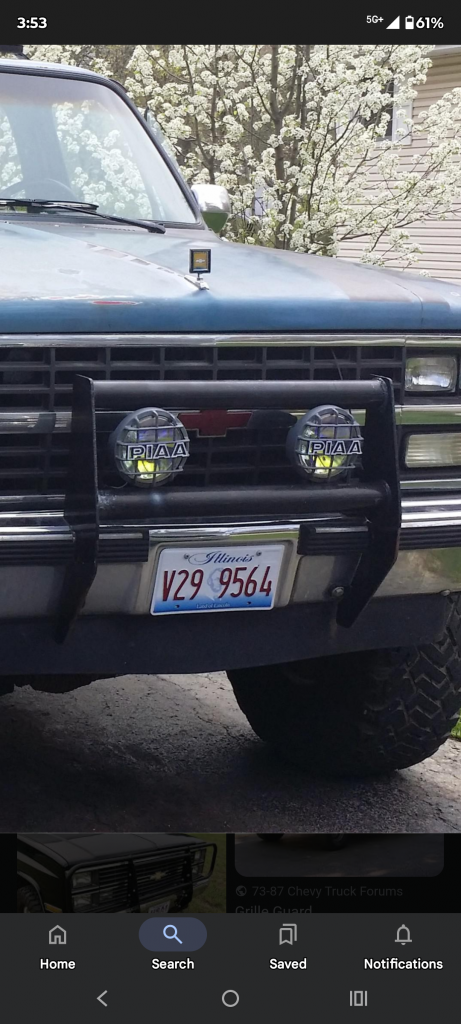

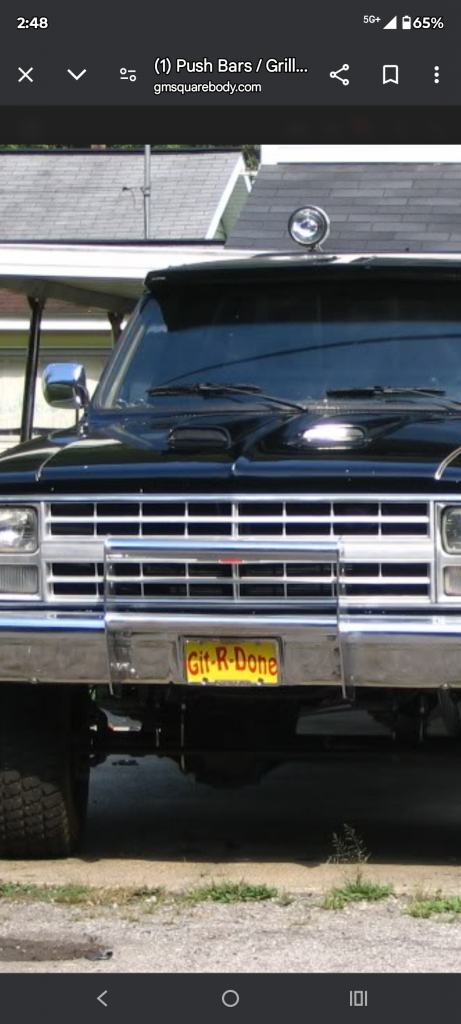

These are the ones I used for the design all slightly different but the black bull bar is close to the look I'm going for

That black one looks very close to the one on my '88. Still slightly different though. There must have been countless manufacturers.

Look at those wheels on the k5! :roflbow:
That suburban looks mean though. I like it
