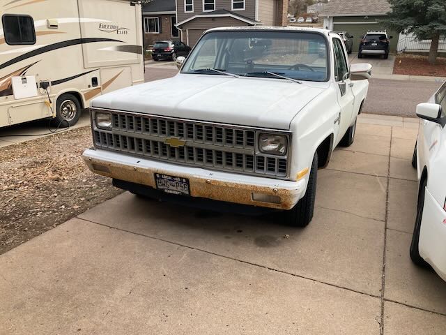

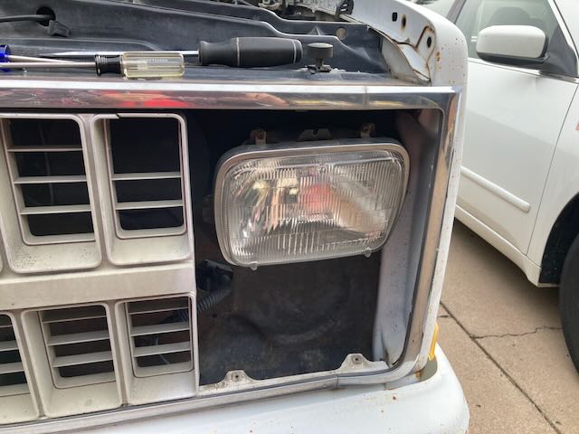

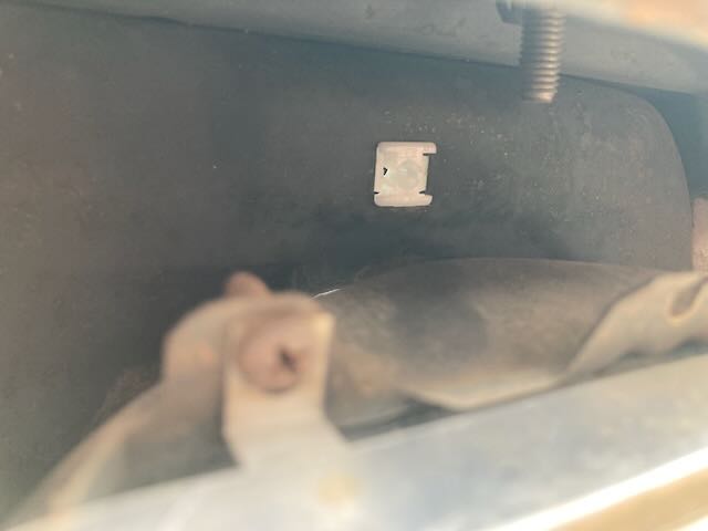

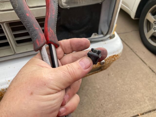

Fixed a droopy headlight by replacing the plastic doo dad behind the adjuster. Black (old one) was internally stripped and cracked.

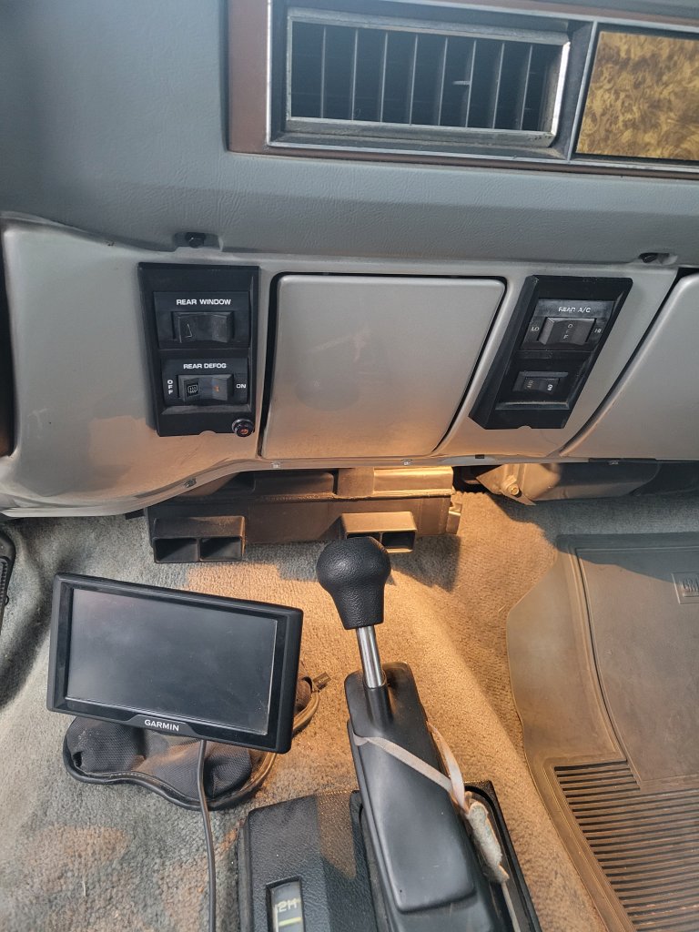

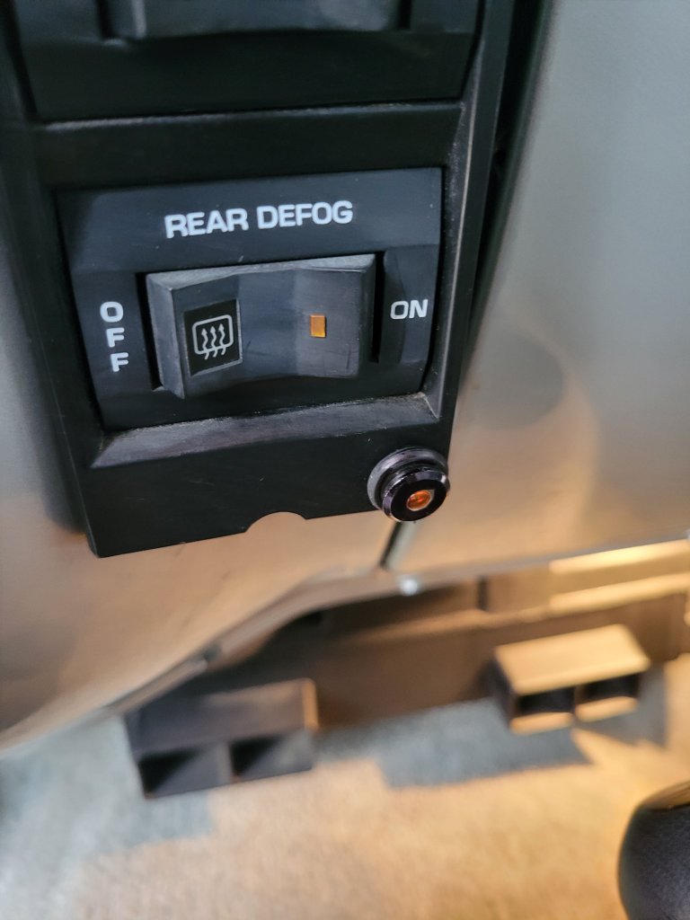

it is so dark inside the cab of these old rigs, and I could never see the cupholders on the center console of the suburban. One good thing about more modern cars is the little LED that shines down from above to illuminate the console area.
So I added a little LED to provide some ambient light in the console area. The rear defrost switch has a lamp in it, so I tapped power there and it comes on with the headlights. I drilled a hole in the switch bezel to keep from drilling a hole in the metal dash. I did have to shim it out with an additional O ring so the LED body would fit in the bezel cavity. The bezel is angled downward slightly and is nearly centered on the console. It's not as elegant as a light shining from above, but overall, I am pretty happy with it for less than $10 and about 20 minutes of my time.
The light amount is perfect to just let me see the console area on an empty highway or backroad and isnt distracting while driving (sorry no night time pic, maybe I'll add one later).

Nice idea! That reminds me of the little amber light by the dome light in 30 series John Deere tractors like 4430’s that gave some (emphasis on some) light to supposedly help see the transmission shift levers at night.

Our old JCB's had a similar feature. There was a switch on the RH dome light that would turn on a nice, dim, aqua-blue light that would cast a pleasant light down on all the controls at night.

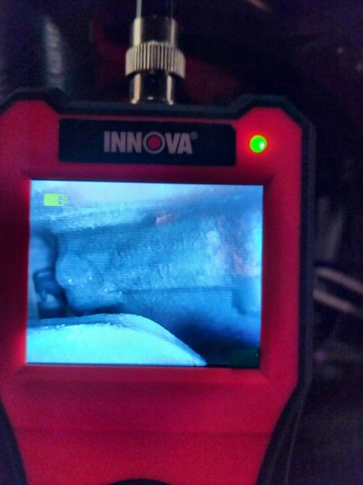

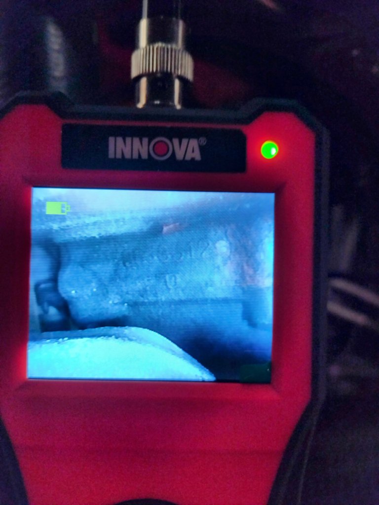

Wife took pity on me today and gave me an early Christmas gift, a boroscope so I could find those ridiculously hard to see stamping and casting numbers on my engine. Had tried several times but eventually admitted defeat.
Tool worked great! From todays searching here is what I have found:
Stamped engine Code and VIN info:
CPD - 1971 365 hp LS-5 454 from Chevelle or Monte Carlo with 4-speed.
11B228294 - Chevrolet Division, 1971, Baltimore assembly plant. The 228294 is the partial VIN of the car this engine was originally built with.
Block Casting #:
3963512 - this casting was used for both 427 and 454 big blocks. Could be 2 or 4 bolt mains. I’ll find out which one day.lol
Exhaust manifold casting numbers: 3994045 (LH side). Big block Police manifolds. From what I read the only real difference is an increase in nickel to add strength and heat resistance as cop cars idle a lot and things get hot under the hood.
Didn’t pull a valve cover to check head casting info, but I posted earlier about that vintage Weiand intake that’s for the large rectangular port heads.
