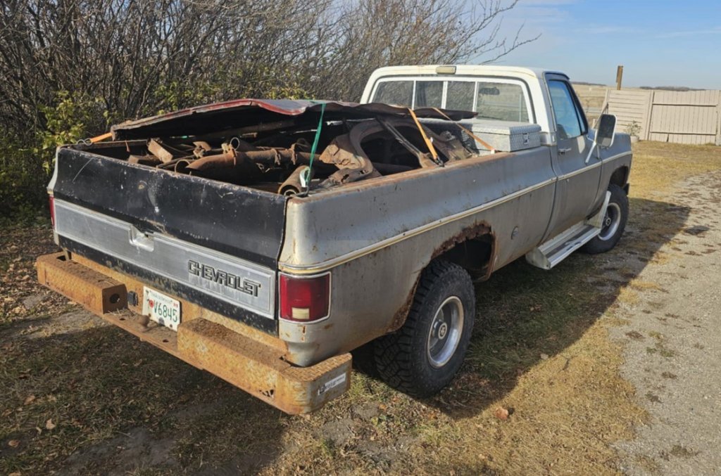

Loaded up the K10 with scrap metal today. I've been having issues with the divorced choke, not opening all the way. So I disconnected it and it ran way better on the highway, and used less fuel. I am going to try one of those electric conversions

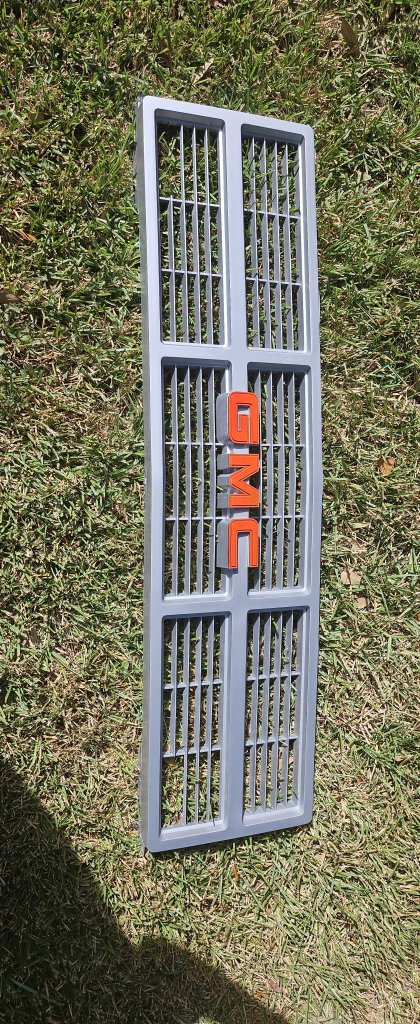

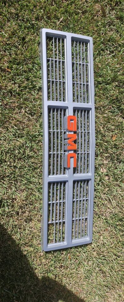

Been working on converting my GMC to actually have GMC badging.
Picked up a grille and clean tailgate panel for $130 from a swap meet and restored the grille.
Workong on restoring the tailgate panel right now too but no pictures of it

Dude score that's a hard to find grill

What year is it exactly? '84?
I'm just curious since I've got a 76 with an 80s front clip. Figured this would hold me over until I do a front end swap in the future.
83-84 there is one on eBay looks in worse shape for 400 right now so I think you got a deal

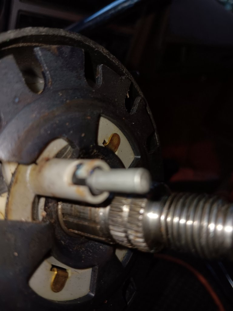

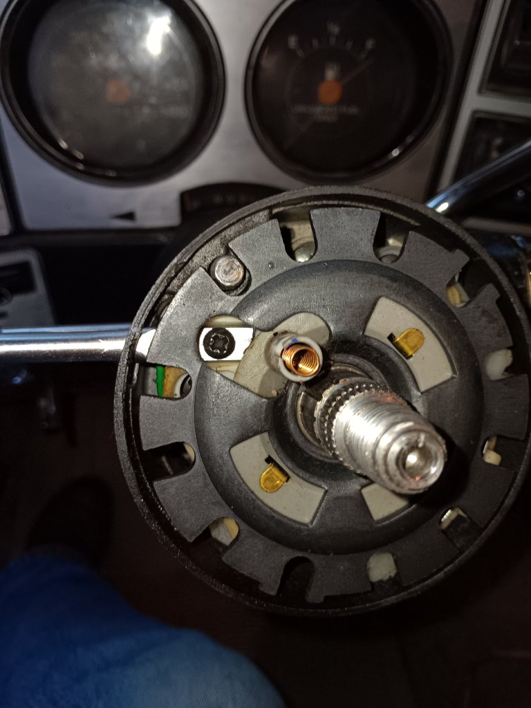

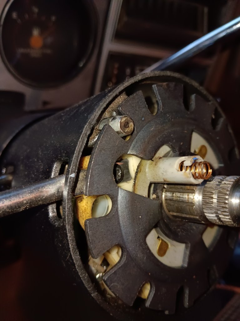

Noticed my turn signal/cruise stalk was loose. Looking thru old pics and noticed that there is a cut out in the lockplate that accepts a round tab from the plastic lock plate cover. Hmmm...
Looks big enough to get to the screw without taking the lockplate off.
Yup ! Still had to take the wheel off.
Dunno if it will hurt since the turn signal lever screw goes in to plastic but I put some blue loctite on it.

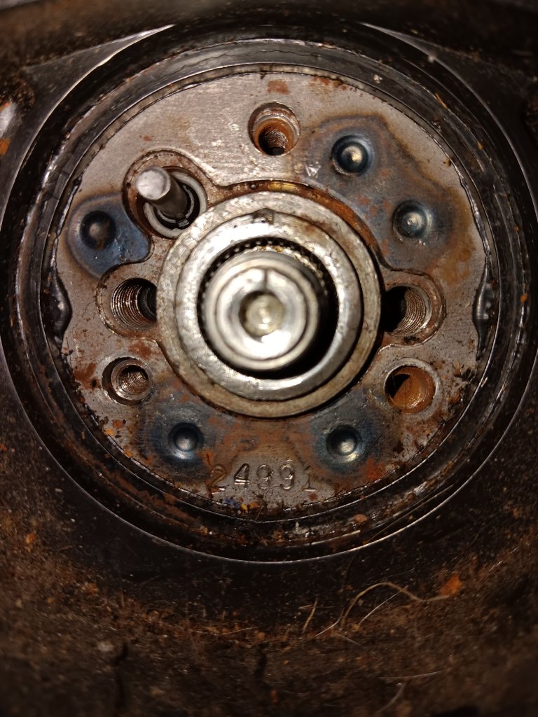

Bonus pics of horn spring, horn button (metal) and the plastic retainer, and the line up marks on the steering wheel and steering shaft.

Dude you stole that grille! Looks like it's got a couple broken slats but if repaired and fully restored, I've seen those go for $500-$1500

That's cool! Whenever I swap to the 70s front end, guess this could help fund it.
I'll post a pick this afternoon of it on the truck. Got it mounted yesterday but it's in the garage so I couldn't get a good picture

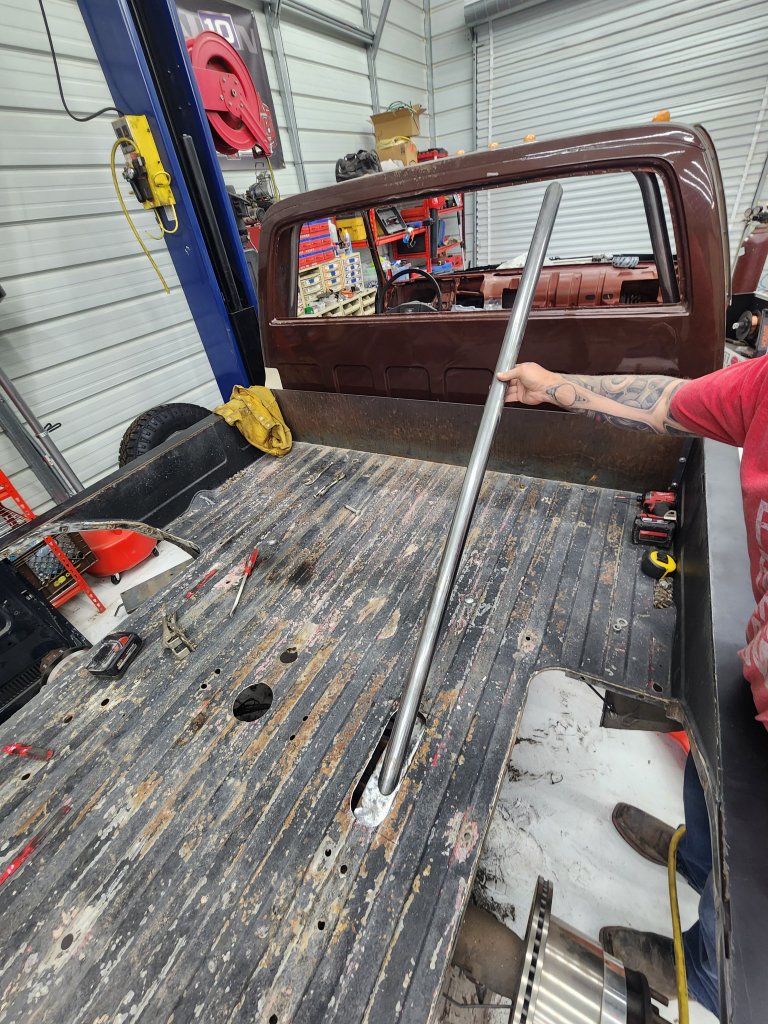

Got the gooseneck hitch removed and holes cut where the down bars for the roll cage will get welded to

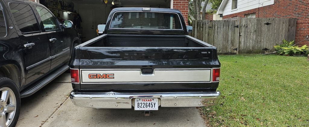

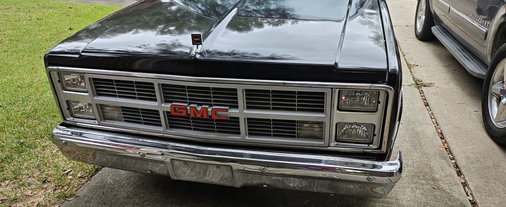

Got the grille, hood emblem, and tailgate panel on.
Now on to the wheel caps and fender badges. Then interior badges
