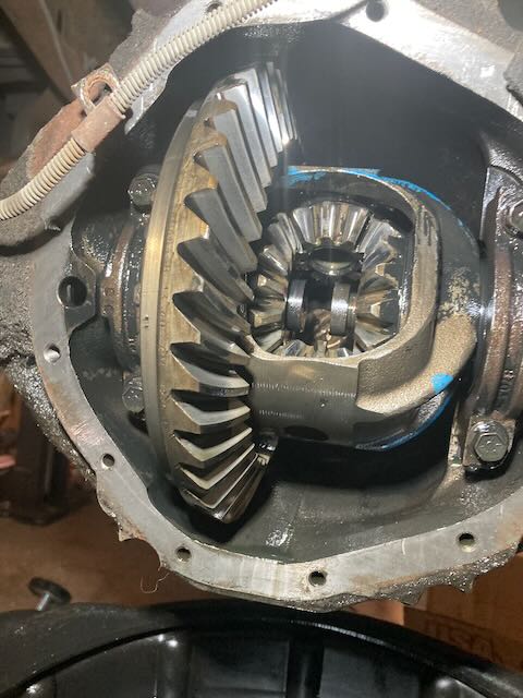

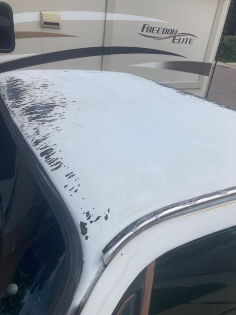

Cleaning up my truck for VGG wipe on clear coat (matte finish). Also, after coating, I will install a new axle half shaft to replace the one thats bent and has been wiggling for the last 19 years. More photos to come after the clean and coat.
Well, roughing up the paint was hard work. The first coat of coating was awful, streaky. I Made the mistake of putting a matte finish on white paint. Second coat was better (I had enough, barely), but, the paint was chalky before I started this, and the matte finish on white was just wrong. I should have chosen the gloss.

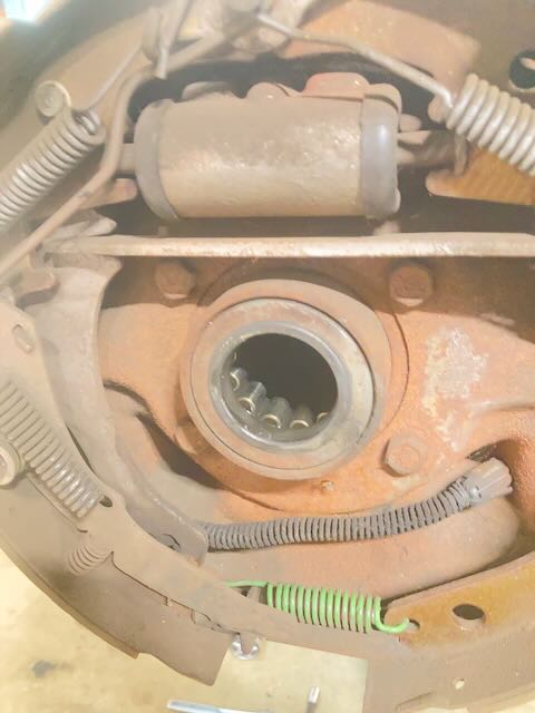

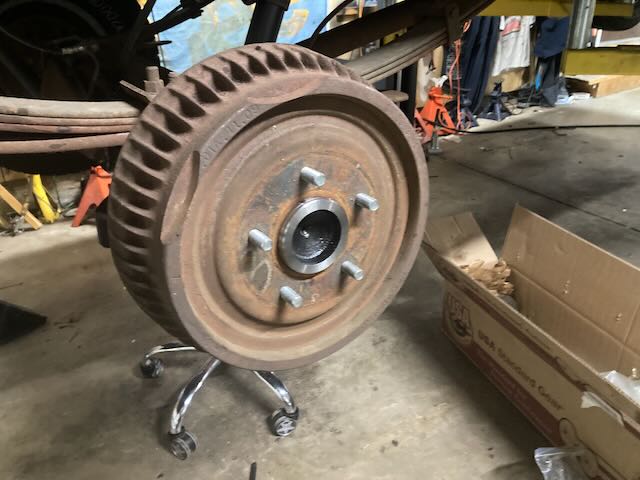

The new axle ($106 for the axle, bearing and seal kit from RockAuto and $40 for new gear oil) was a snap. Pop open the diff, remove the lock bolt, pull the diff center pin and the CClip on the axle, and out came the old axle, in with the new. Did not have to touch brakes other than sliding the drum off. Sorry, pictures not in correct order, but Hey.
