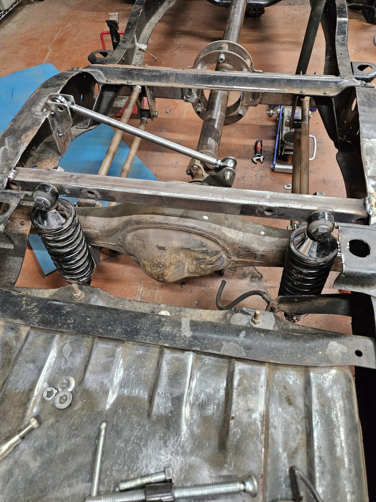

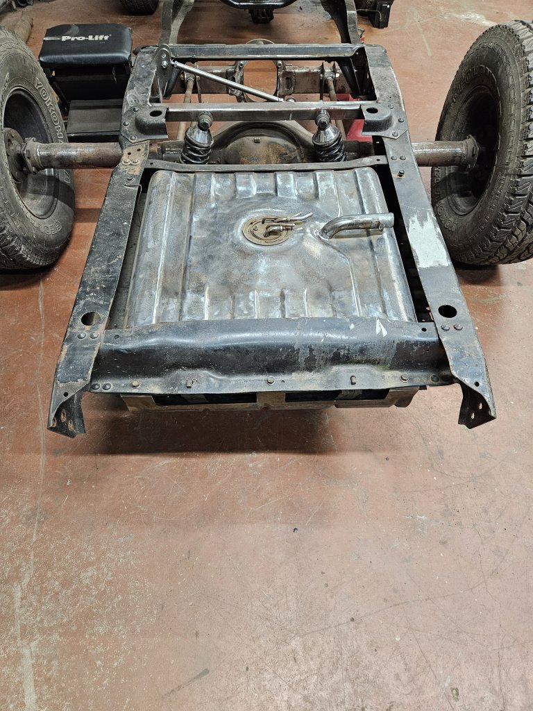

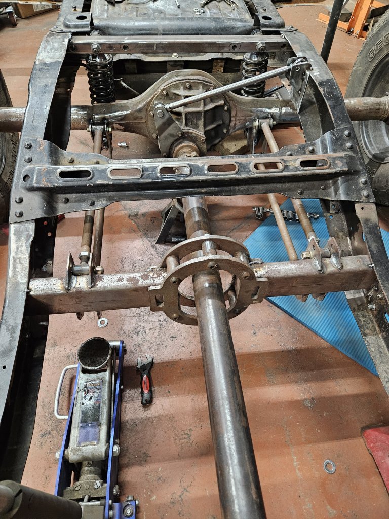

Had to reposition the front cross member. I was talking to a guy at work about the rear coilovers. I had mine at a 30 degree angle, or maybe they were 60 degree anyways. He suggested I make them as close to a 90 degree as possible. He said they will preform better. I had to drill new holes in the upper mount. Weld in some round stock. Came out pretty good if I do say so myself. Little before and after shots...
