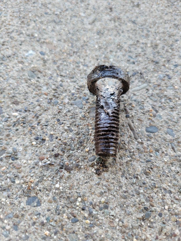

Had to fight the seat belt bolts - tried penetrating oil, heat, a big breaker bar, big impact and only succeeded in deforming several T50 sockets and throwing tools like a three year old. Took a drill to the driver side one and, even after drilling, still had to unscrew it with channel locks. I won, but at what cost?! :))

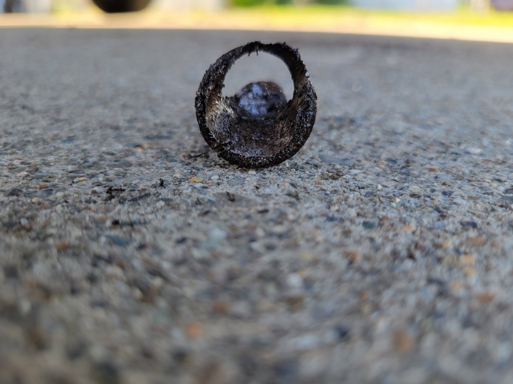

Got the driveshaft out, wiring unhooked, lines unhooked, trans drained, headers and linkage removed and trans out. Of course when the pan dropped, it made a mess and a lot missed the drain pan lol
Got the motor mostly stripped of its harness, plug wires and intake. Just gotta drain the coolant and remove the accessory drive and it’s ready to come out.

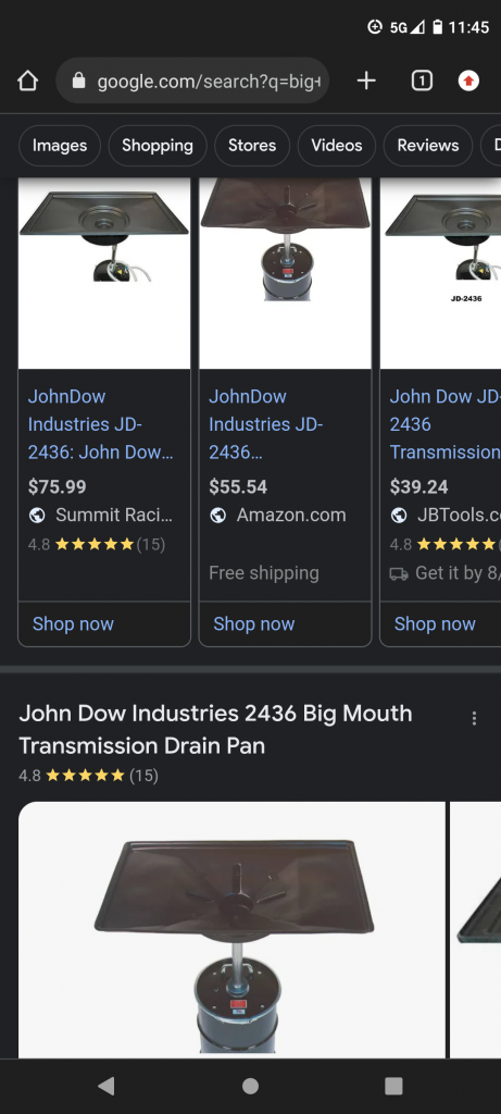

Need one of these they just sit on top your r2d2 oil unit

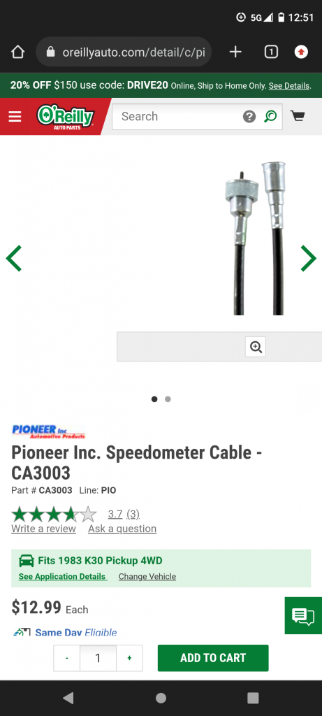

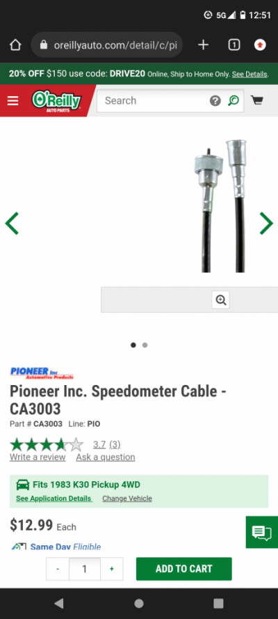

Confirmed the speedometer cable was making noise was going to pull it out and lube it up then seen it melted near the exhaust sounded like a siren/squeaking so bad I thought the drive line was going to fall out of this thing
