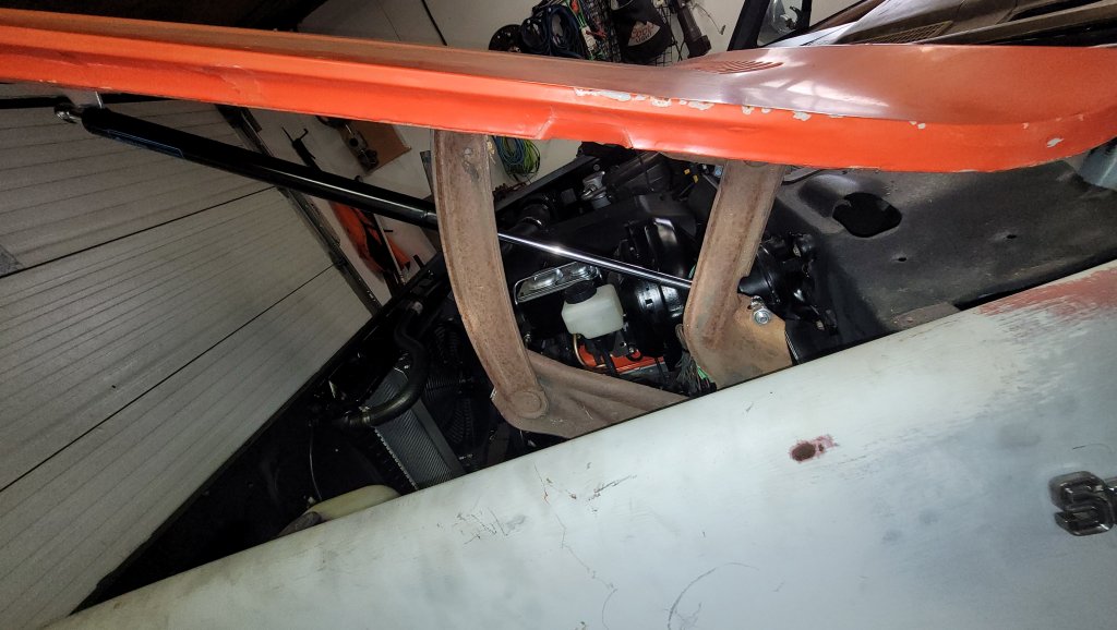

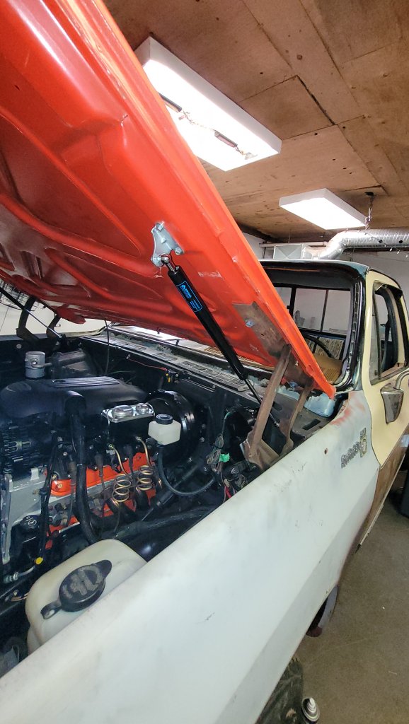

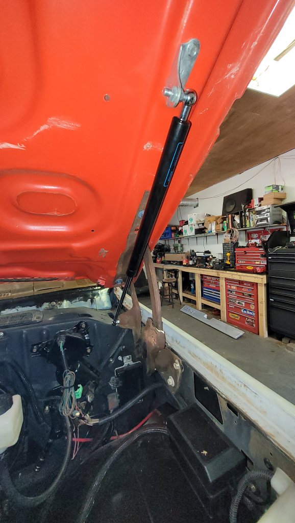

Hood sits down fine. You can see in thr pictures I had to cut the one end where the spring would attach so it would clear the hood pistons. I used 23" long pistons with a 9 inch stroke 100lb.
All that being said It does feel a but tough at first to close but not enough to do any damage to the hood. I am using old wore out hood hinges that i do plan on replacing I would imagine that would make it a bit easier to close
I am happy with thr results so far.
