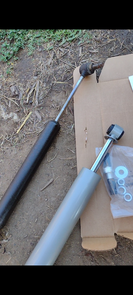

yea I have been running those load leveler Munroe's on all fours for a long time.
How's the ride thought about trying these out also sweet build loving the green

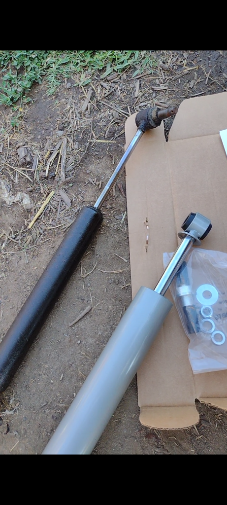

Follow up on the DW I got the new stabilizer in today and drove on the roughest roads nearby and the problems solved(old one looks original and was toast and would drop a inch or so then catch) the new rc was definitely a beefy upgrade still waiting on bushings shocks and tires are high on my list
With the stock front OEM 3 leaf springs it rides just like every other Square little springier. Will see with the LS in it but the weight difference between motors isn't very much.
