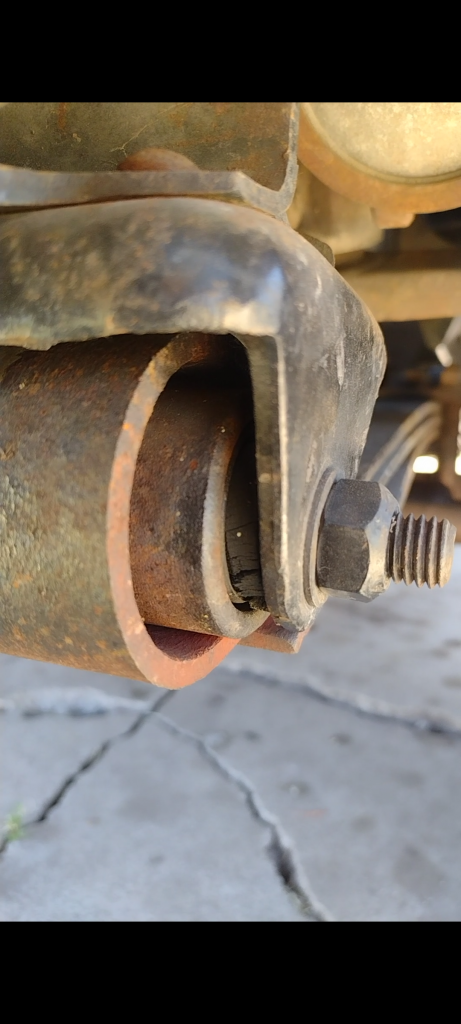

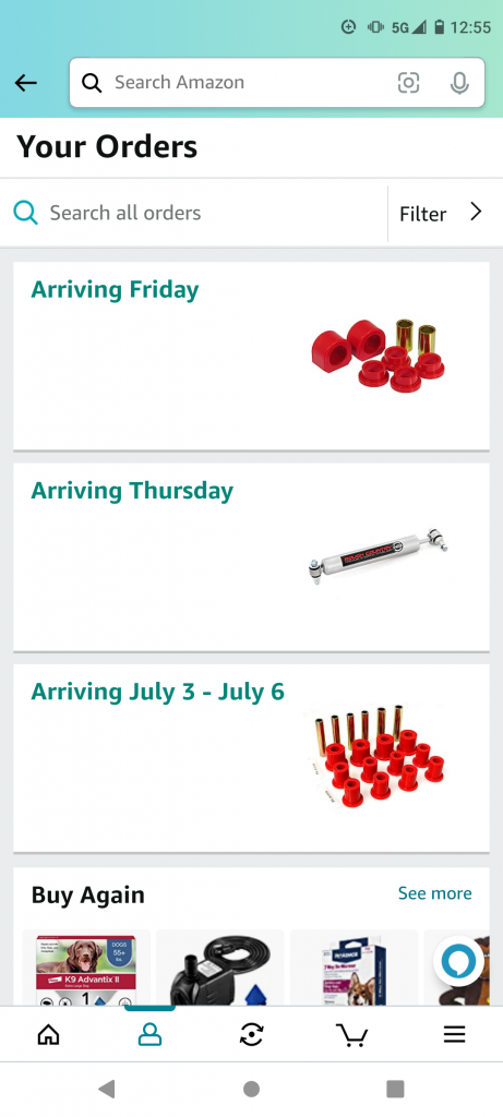

Old girl started to death wobble around 30+ if I hit a bump so I got the front end bushings and stabilizer coming all this 40year old rubber starting to let go still got to get the rear bushings found it more affordable piecing it out than getting the front and rear kit

Death wobble is usually from worn components such as tie rods and ball joints. Spring bushings aren't likely to fix it.

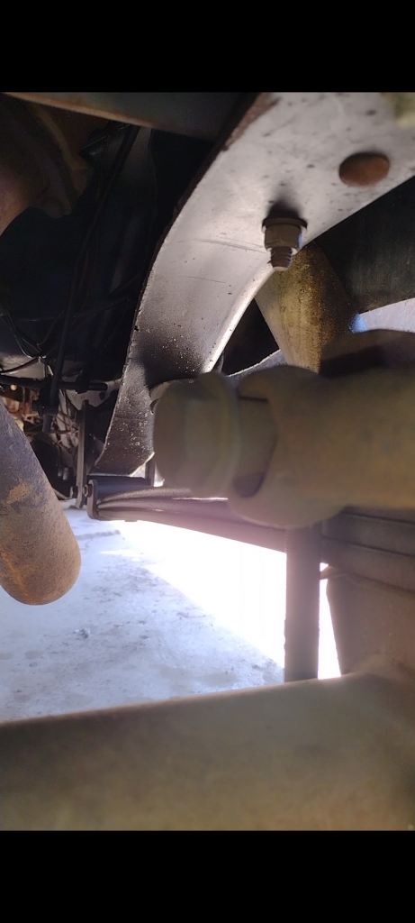

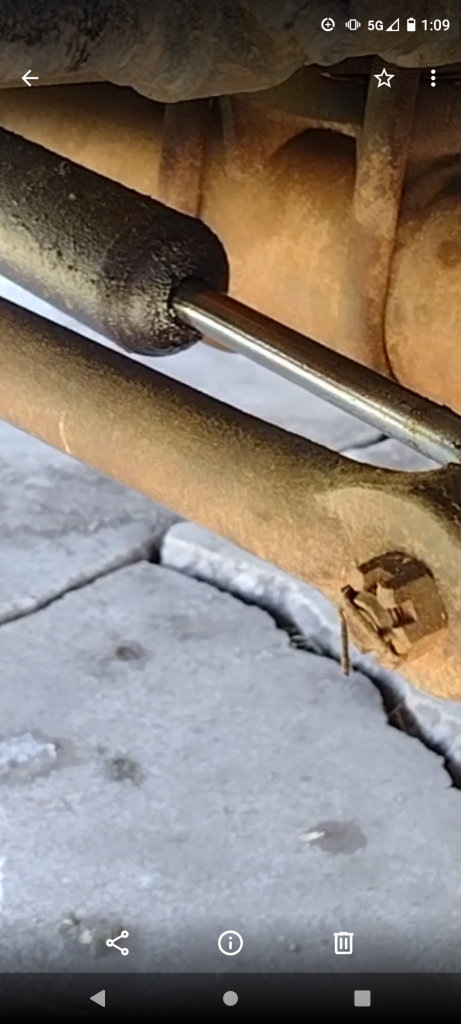

Everything feels good stabilizer has been leaking for awhile and is totally blown out I remember my Jeep did the same awhile back everything was tight stabilizer was leaking I believe it to be my main culprit the leaf bushings are pretty bad and the sway bars rubber is missing bushings either way want to have new rubber or poly in this case :driver: :driver:

Went ahead and jacked up the front end to double check and everything feels good no play in anything stabilizer should be here soon so I'll pop it on and see how she handles

I’d argue that DW has contributing factors that involve any and all front end components as well as caster. Especially spring bushings.
Bad shocks or stabilizer won’t cause DW and imo there is a small chance they could partially mask the real causes but who’d want to do that.

Unless it's a left front bushing on a truck that still has push pull steering. That bushing can be a major contributor.

Replacing what I see is bad king pins and tie rods are good and tight spring/sway bushings are toast could be the tires are really old but they still hold wind :laughing1:

That's awesome , and that left front bushing is definitely done for
