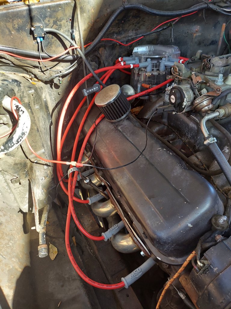

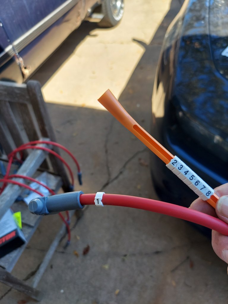

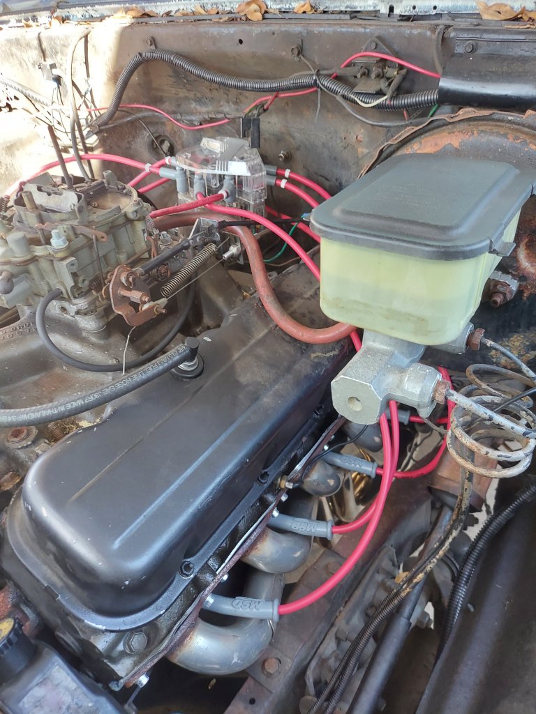

Put new plugs and wires on today. Really like the msd wires with the number rings. Now beer run time.

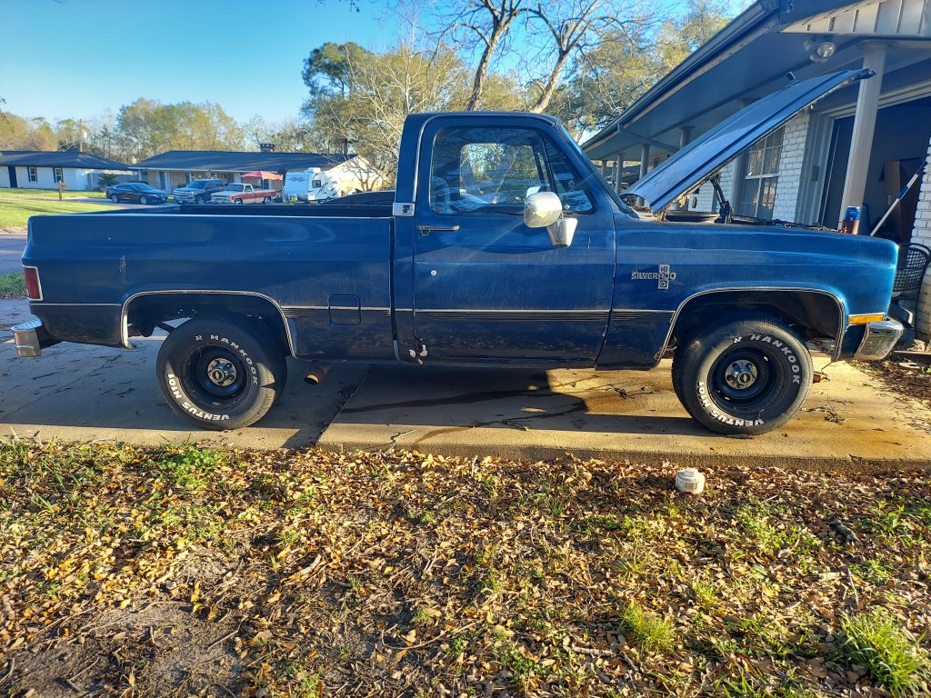

Two of my beauty rings are really rusted. Thinking of touching up the rims without the rings. What y'all think?

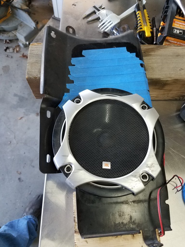

Started working on getting the JBL component speakers fitted behind the seat. Gonna have to fill the top of the existing hole and put the tweeter there.
