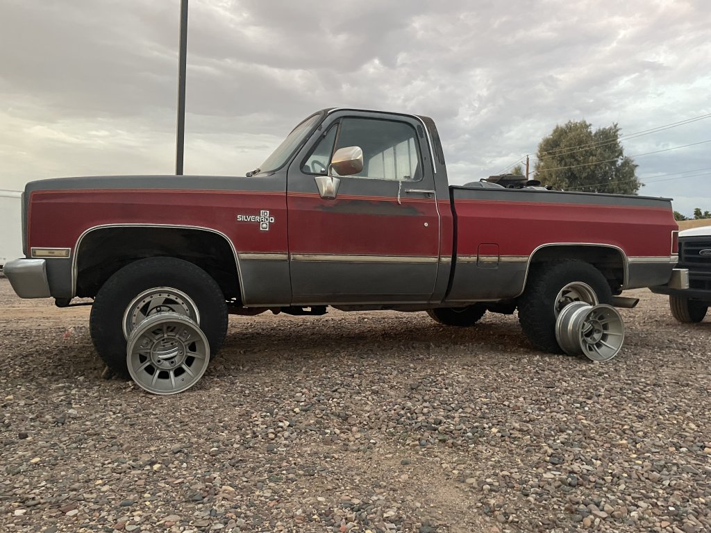

Dropped a tank and installed a new sending unit and diverter valve, replaced positive and negative battery cables, installed a new battery, changed the oil, got it running, found the water pump pouring, that is the next project.

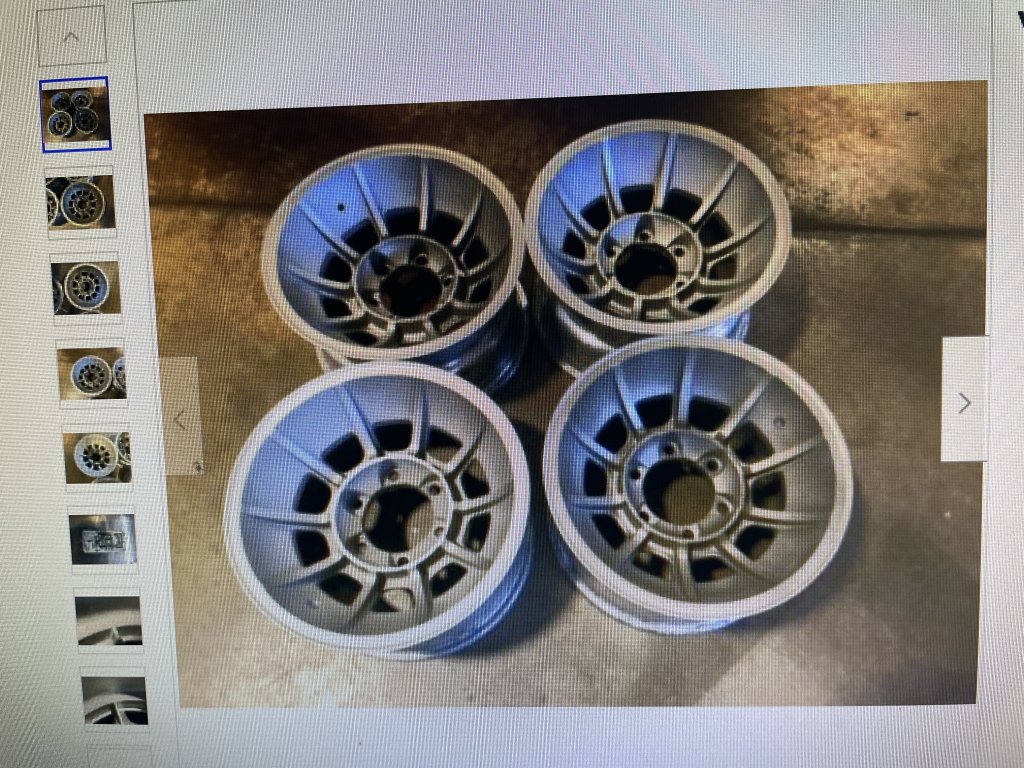

Bought a set of old American Racing Vectors off Ebay only to have them show up with 2 of them being junk due to the lug nuts coming loose and wallowing out the lug holes. They were also painted a shade of aluminum, I was expecting them to be just old as they appeared in the pictures.
Located a place in Los Angeles who will weld them up and install steel inserts to use conical lug nuts instead of the shanked. Also agreed to have him restore the wheels by stripping then repainting the wheel, re-machining the machined areas and clear powder coating them. I am not happy with what I will have tied up in them but also know I have not seen a set for sale in some time, they will make the truck. Was thinking 33/12.50's and a 2-3" lift.

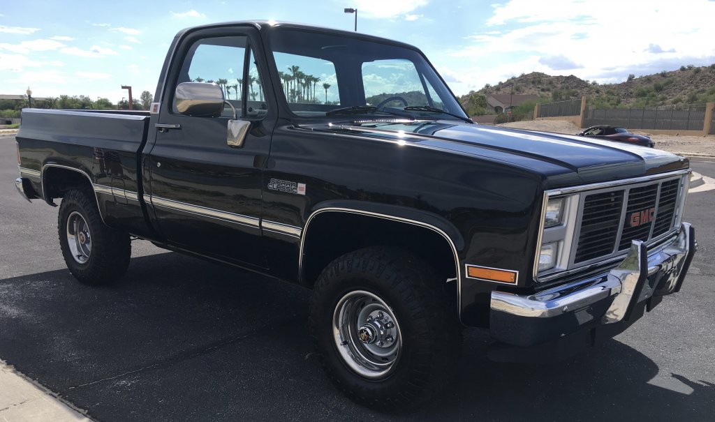

I completely agree with you here. None of the current/modern designs look right on these trucks. You have to find something that either is old or looks old. Some of the aluminum "Slots" can still be had and they look pretty good.
I was surprised at how many folks reacted to my OE Rally wheels. I had considered some aftermarket wheels but quickly realized that was not an option.
My truck is sitting on a roughly 2 inch lift with 33x12.50-15s if this pic helps you at all.

Sweet! I think your other pics posted helped with my decision :cheers:
It was my original intention to get a set of factory rallies but local sets for sale are as much as new aftermarket wheels by the time you freshen them up. My original thought was the Vectors were going to be a cost effective solution, once they showed up, I realized it wasn't going to be that easy.I looked at all my options, thought about it and just said #%&@ it, I like them and it will make the truck.
