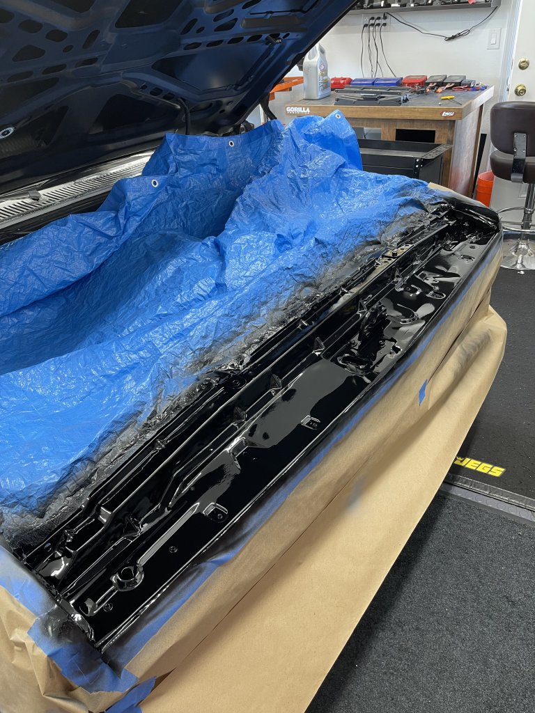

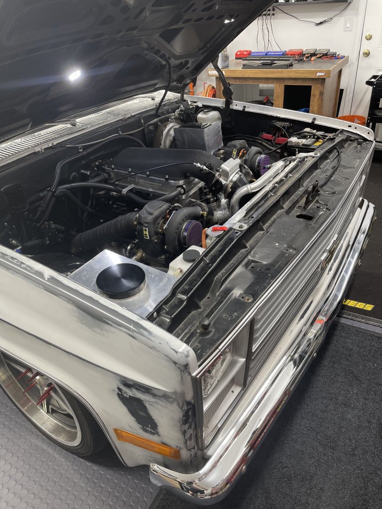

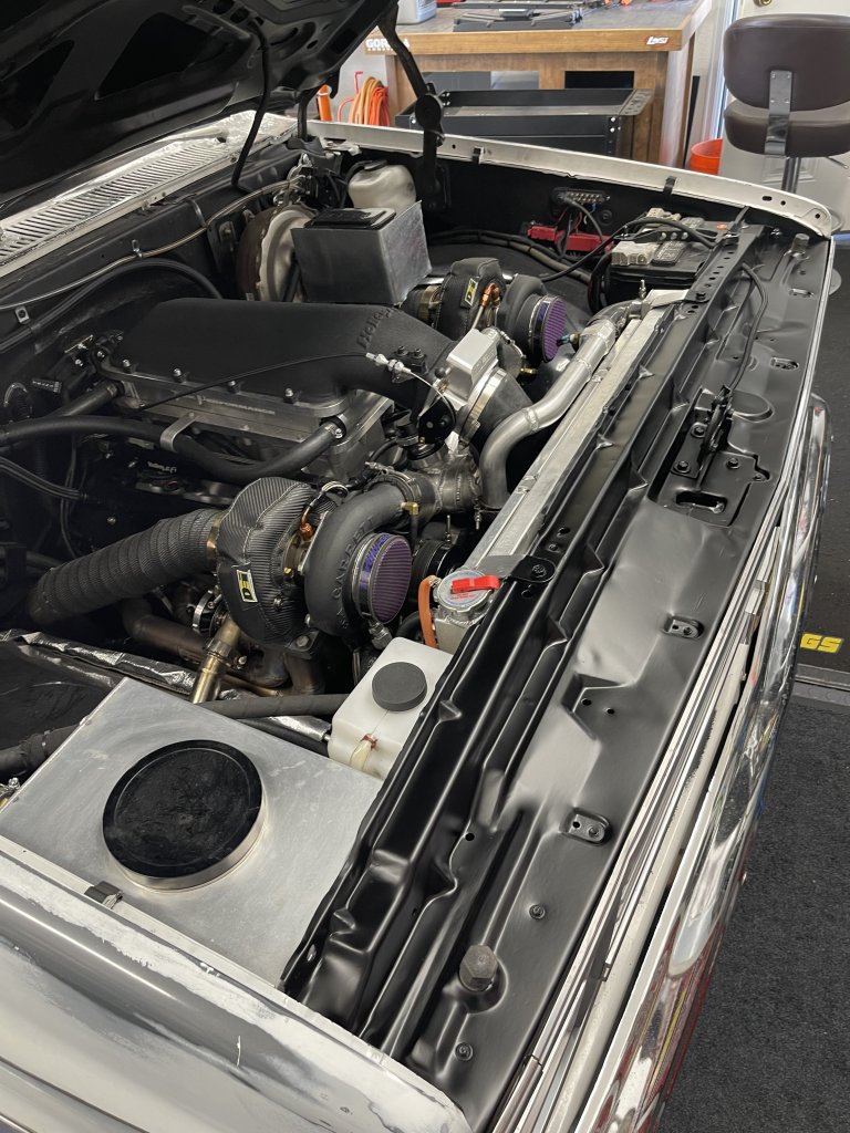

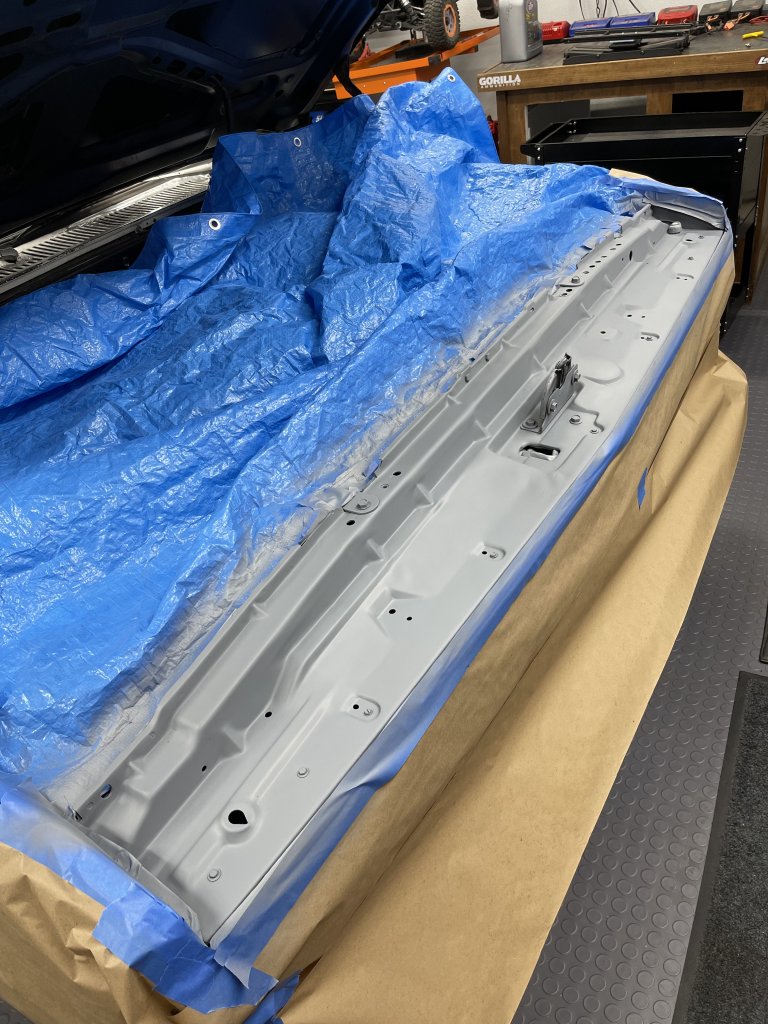

I was tired of looking at the krylon painted core support, so I stopped it to bare metal primed and sanded and p[ainted low gloss black from Eastwood. Cost me about $50 and a few hours but I think it came out great and isnt junk aftermarket!

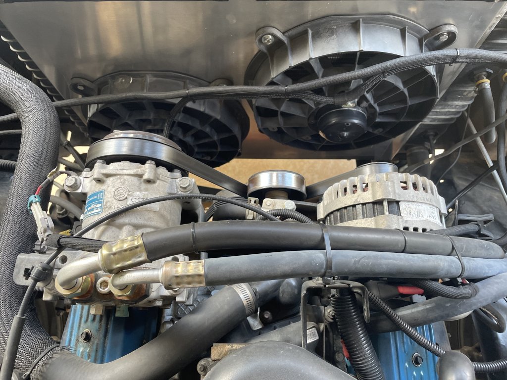

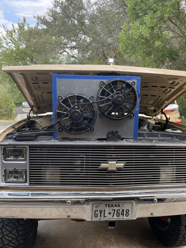

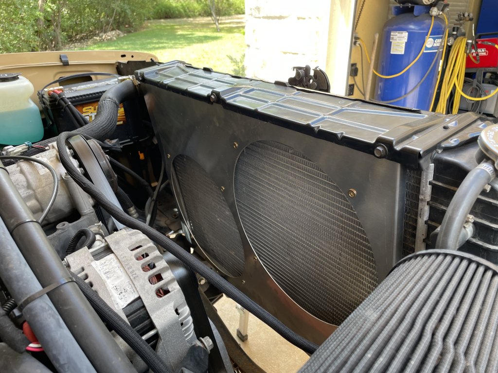

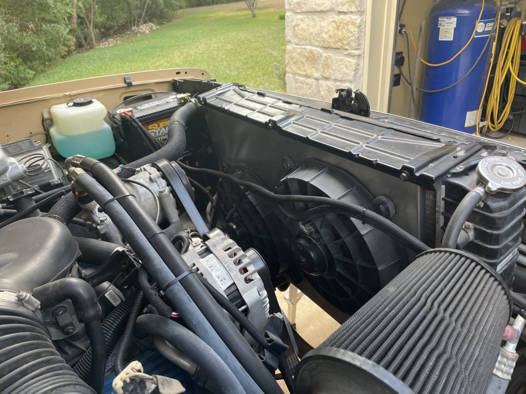

Finally got around to electric fans. Wired to the PCM for Low speed, High speed, and come on with the AC. So far so good.
Prolly added 10 mpg and 75hp!

How did you wire them? Looks like you are running an L31 with an 0411 conversion? Did you wire them with the three relays like a stock 2007+ silverado? The stock three relay system runs both fans for both high and low speed, but low speed runs the fans in series and high speed has them running parallel.

That looks really good! Now you could do mine just like that, I'll be your best friend. Lol
