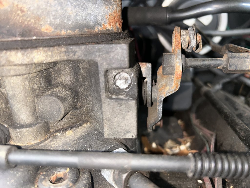

What’s the solution to this?? Idle adjustor

So I went to adjust my idle on my 90 suburban and found the adjuster like this!

the cap will come out with a small screw driver or a pick. you shouldn't need to drill it out.
better question is - what are you trying to accomplish by adjusting the min idle air screw? the IAC controls the actual idle speed.

Sorry for the late response I’m trying to lower the idle on start up, I’ve replaced IAC but it is still a bit high.

Would be better to properly diagnose the problem. Really need to know the IAC counts. If you close the throttle plates to fix a cold start issue it could have a sticky throttle or die when warm. The IAC can only adjust so far then other undesirable things will happen. Some possible suspects are a vacuum leak, timing advanced too far, TPS out of adjustment or bad.
