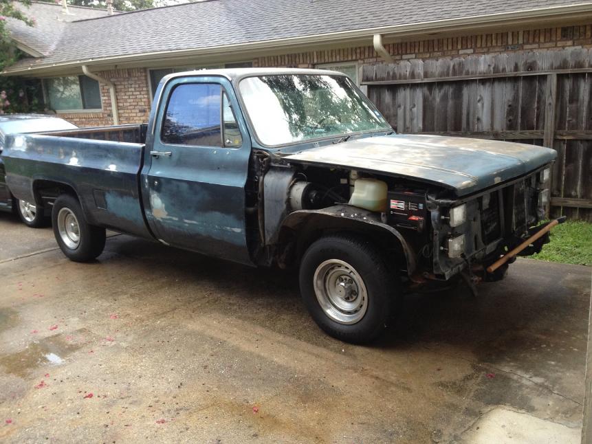

Hi,
We are in the process of rubbing back my 1985 long bed c10.
I would like to paint all of the cab, but am unsure how difficult it will be to remove the long bed? Is it just 8 bolts as people say or am I opening a can of worms? Could I unbolt it and slide it back to get to the cab, but leave it on the frame? Any ideas how much it would weigh? I have an engine hoist but don't really have any sturdy saw horses.
Thanks,
Phil
PS If you have any advice on removing door handles that woudl be appreciated as well!

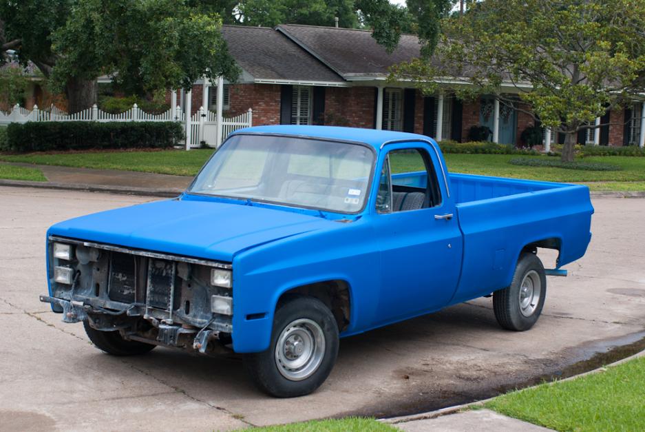

Painted (but not yet assembled). Some streaks in it (paint was drying fast), so going to wait for it to cool down and then sand, final coat and then clear.
Cheers,
Phil
28,638
10,051
wow that's bright :)
47,210
9,482
That's a BLUE truck !!! Looks good !!!
