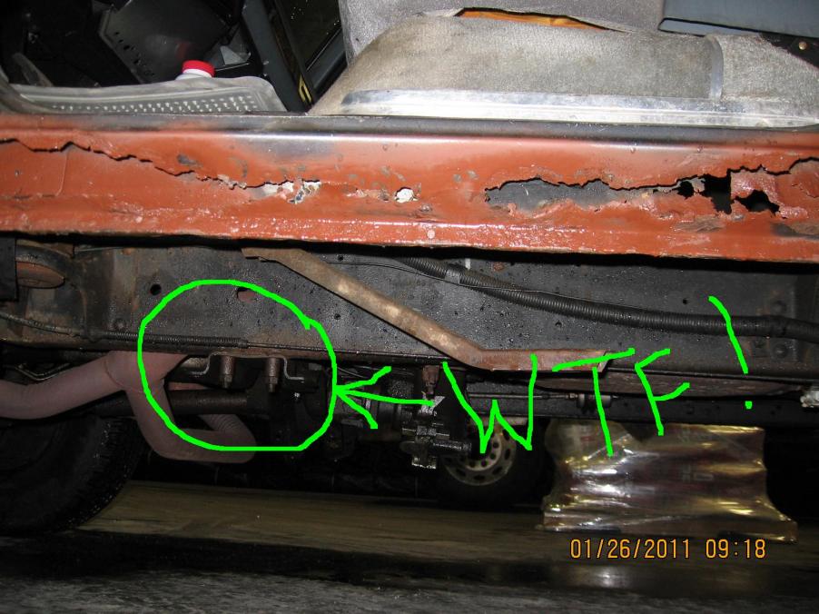

You can use the factory bolt spacers to lower the transfer crossmember. Just move them from under the crossmember to between it and the frame. :waytogo:
attachment.php
35,849
46,286
You can, but it's not a good idea. It can lead to cracks in the frame, crossmember, or both.

Mine hasn't cracked so far, and I am far from easy on mine. But I wont say that it wont happen next time out!!
25,665
9,647
Well, if you are a die hard off roader I wouldn;t suggest it, but a street ride is fine like that, I did that to my old Burb with the 6" lift and didn't have any problems. But The square tubing or solid steel shims would be better of course, this is just my poor man's contribution, lol....
