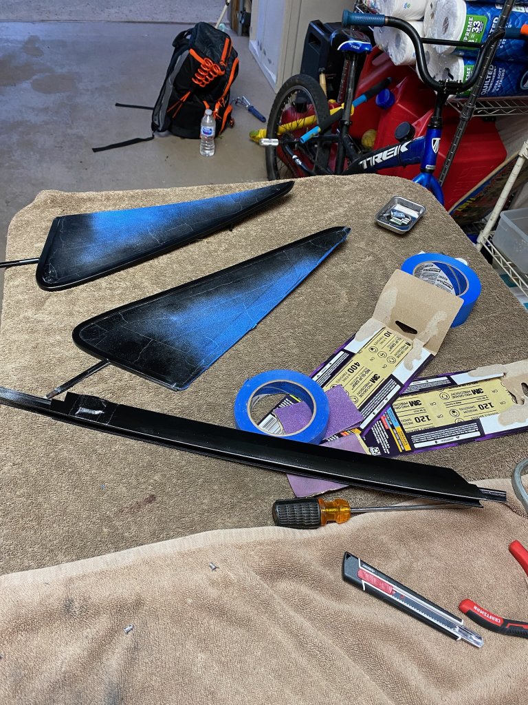

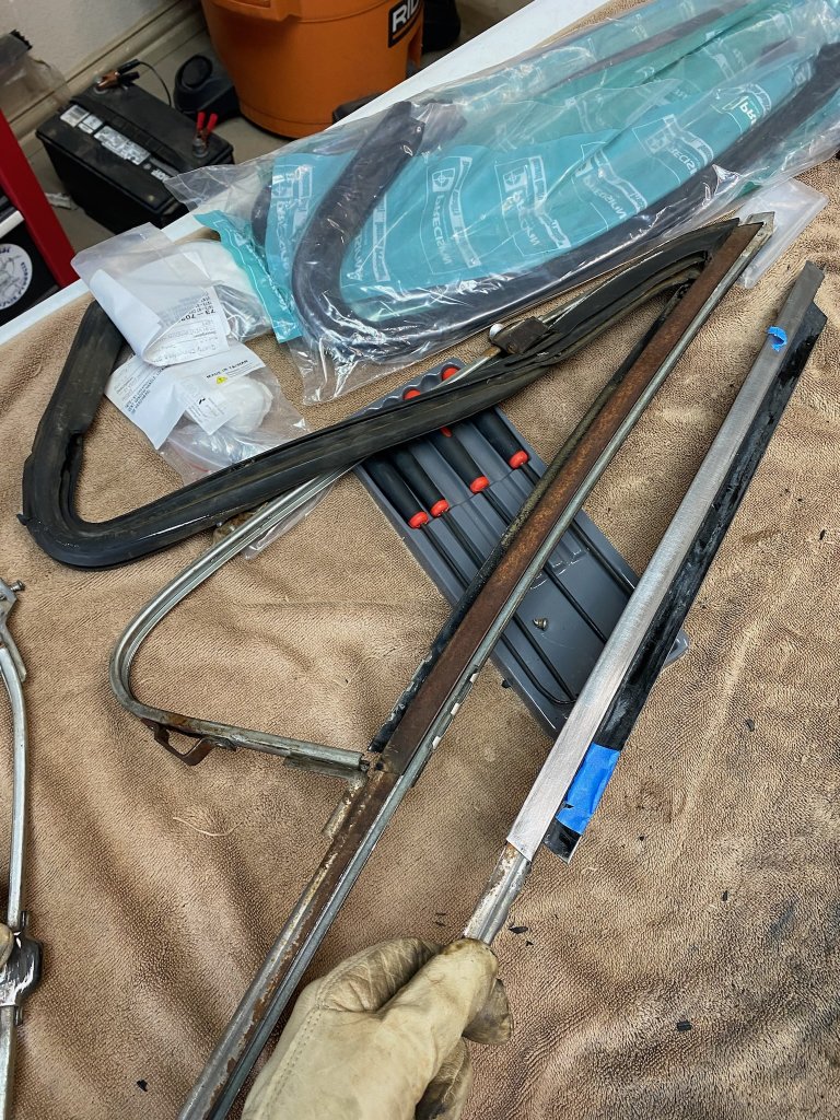

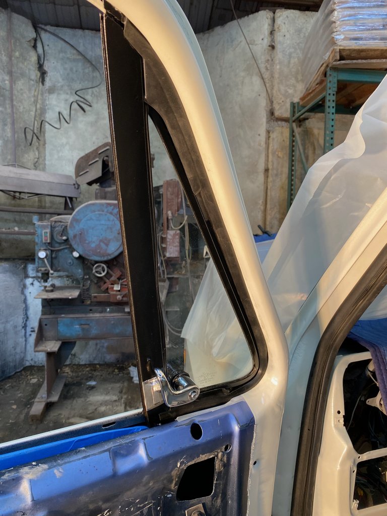

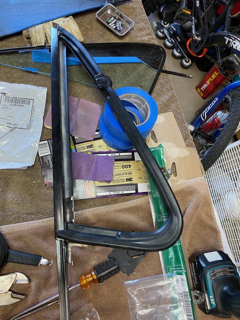

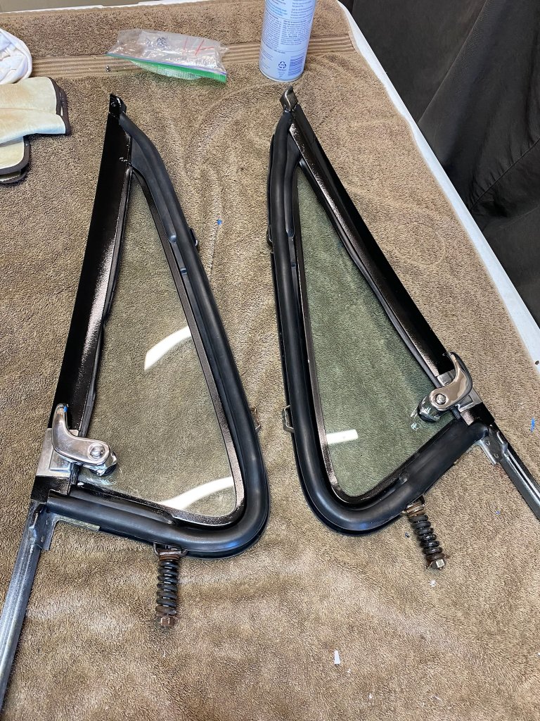

We did ours, two piece set from precision. Took a while. Took one frame apart and not the second. Both came out great. But as posted above take your time, walk away when you have to!
The refurbish at precision is a great deal as everything is included including powder coating frames which we were unable to do but they came out fine.
