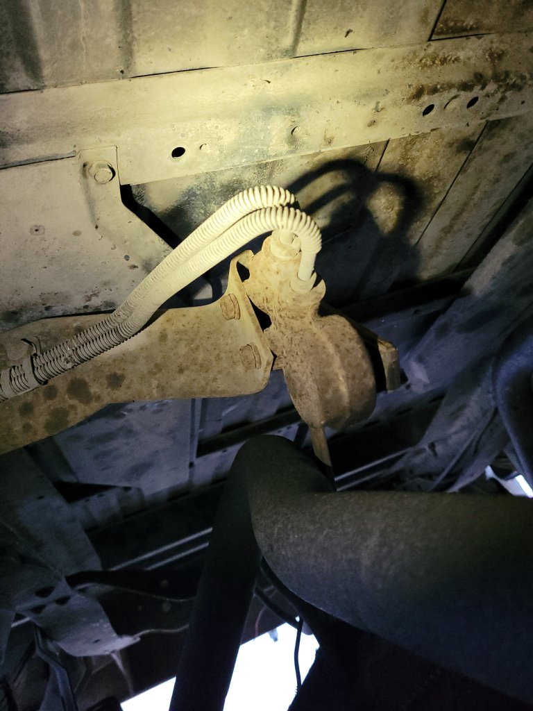

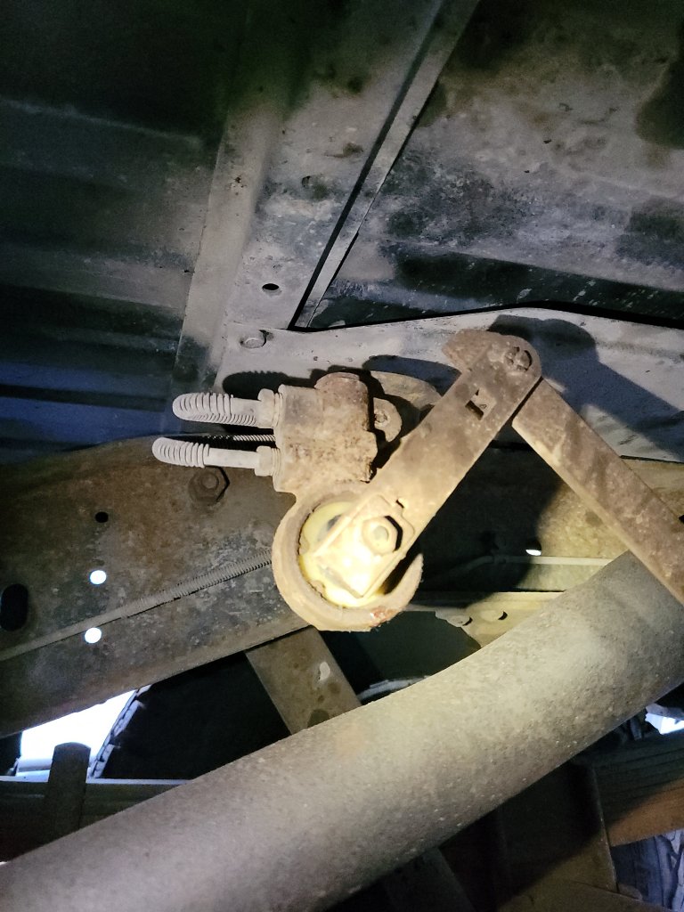

Unkown fitting on rear brake line

It's only an issue when driving and pumping the brakes a couple times in park causes them to work again. Sometimes they don't work at all and sometime it's while you are breaking, also the front will still stop me but only with the petal all the way down. There is also no leaks, I just replace the rear wheel cyclinders as one of them was leaking. I have also bled them and re check for any air and replaced the brake booster. I might get a new proportioning valve to see if that fixes it too. I have only had this truck since December so I'm still figuring all this out and deeply appreciate all your help, truly thank you.
Sounds more like a bad/wrong master cylinder. If it was prop valve or this load valve not sending fluid to the rear, you'd still have good fronts, and the pedal would feel normal. just no rears. This sounds like the master isn't holding pressure.

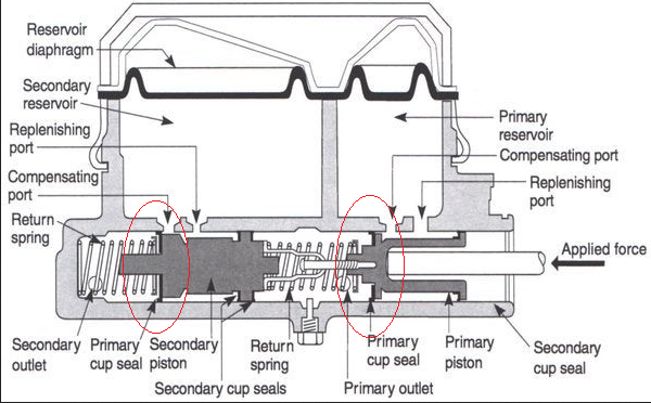

Well, if it repeatedly bleeds down - then there is a loss of pressure. Either through the master cylinder piston seals, or an external leak of some sort. It should hold firm indefinitely.

A leak that causes the peddle to drop will barf out about about 1/2 a shot glass of fluid with every pump, so it won't take that many pumps before your are either out of brake fluid, or have some driveway art to slip on. The only way the peddle can drop without an external leak, is if the master cylinder is leaking internally. It basically forces fluid from the high pressure side to the low pressure side, by leaking fluid past the rubber seal that is supposed to prevent that from happening. A new master cylinder on Amazon is like $30 on Amazon, usually with free next day delivery.
