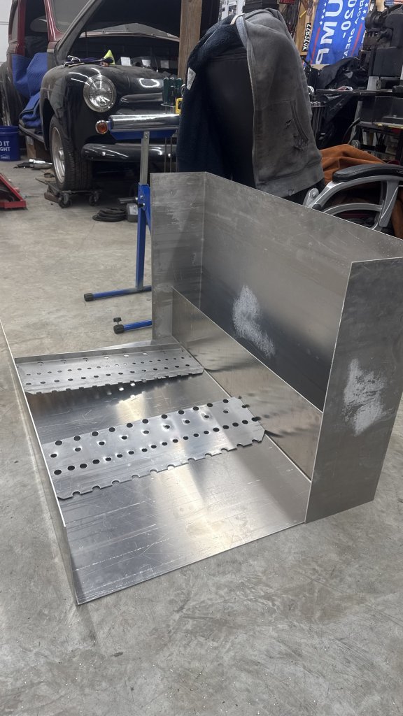

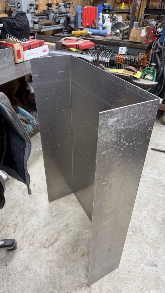

Started building a new fuel tank38 gallon to fit between my frame rails under the centerline of the bed. Doing a 350 efi and turbo 400 swap in the very near future. I currently have a 16 gallon tank.Has anyone on here done this? Any Lessons learned advise would be greatly appreciated.thx Phipp

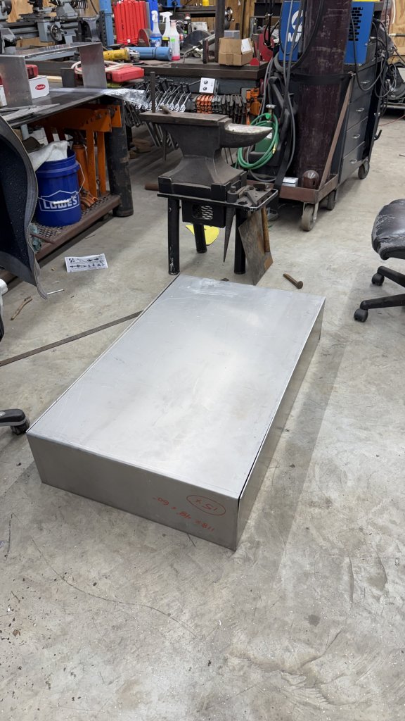

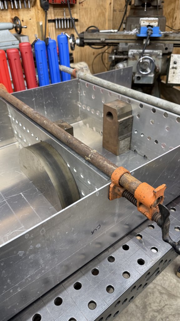

42”x25.25”x8.5” fuel tank in tank fuel pump Aces 340 LPH return less fuel system Aces EFI.

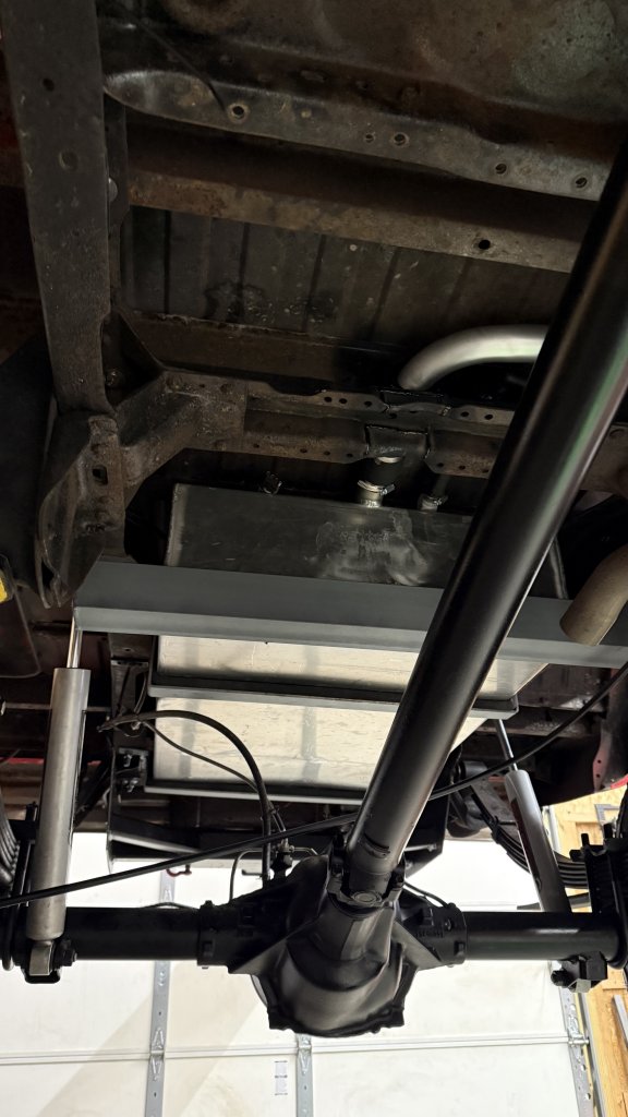

38 gal fuel tank installed. Today. Won’t finish the plumbing, wiring.& fulfill termination intill I do the L-31 EFI 350 & Turbo 400 swap.
