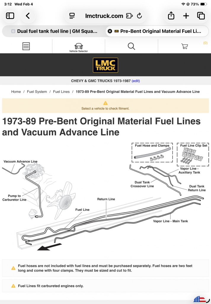

I'd start here.... they may not be the exact line but it will get you close.

I believe 3/8" for feed line (tank output to valve input), 1/4" for return (valve return to tank inlet/return) and 5/16" for vapor (tank to canister in engine bay, if its still there)

I recently fixed my dual tanks on 85 c10 and fuel lines from LMC worked great. I would replace the fuel sending unit on that side while you are at it.
