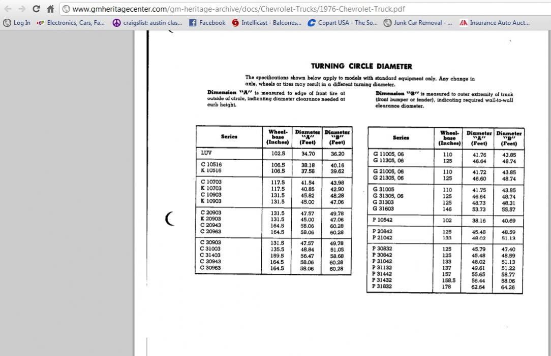

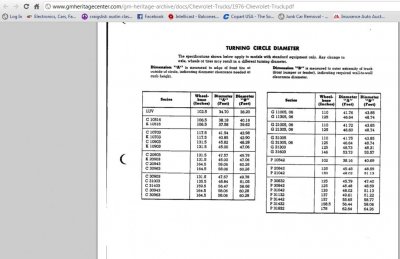

I need to find out the turning radius on my 76 k10 Chevy with 32x11.5's on it.

Well, a factory K10's 131.5" wb turning radius is 47.06 feet if that helps. Shortbed is 42.90 feet...I don't recall if you have a SWB or LWB.

lwb

attachment.php
