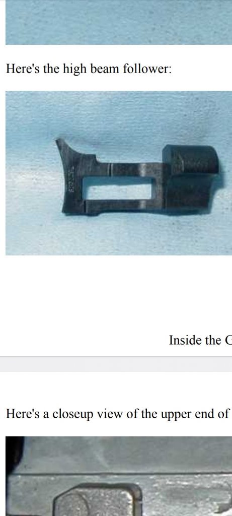

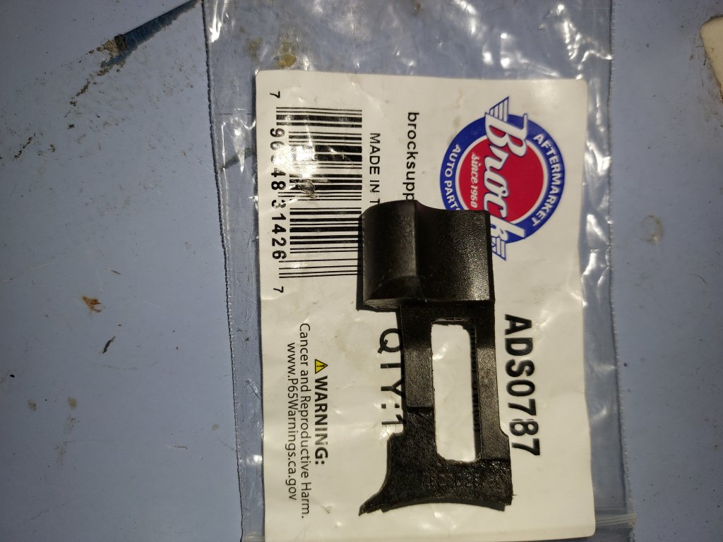

Order this cheap part incase...
It's in the top end for high beams, mine had little plastic nob broken off.

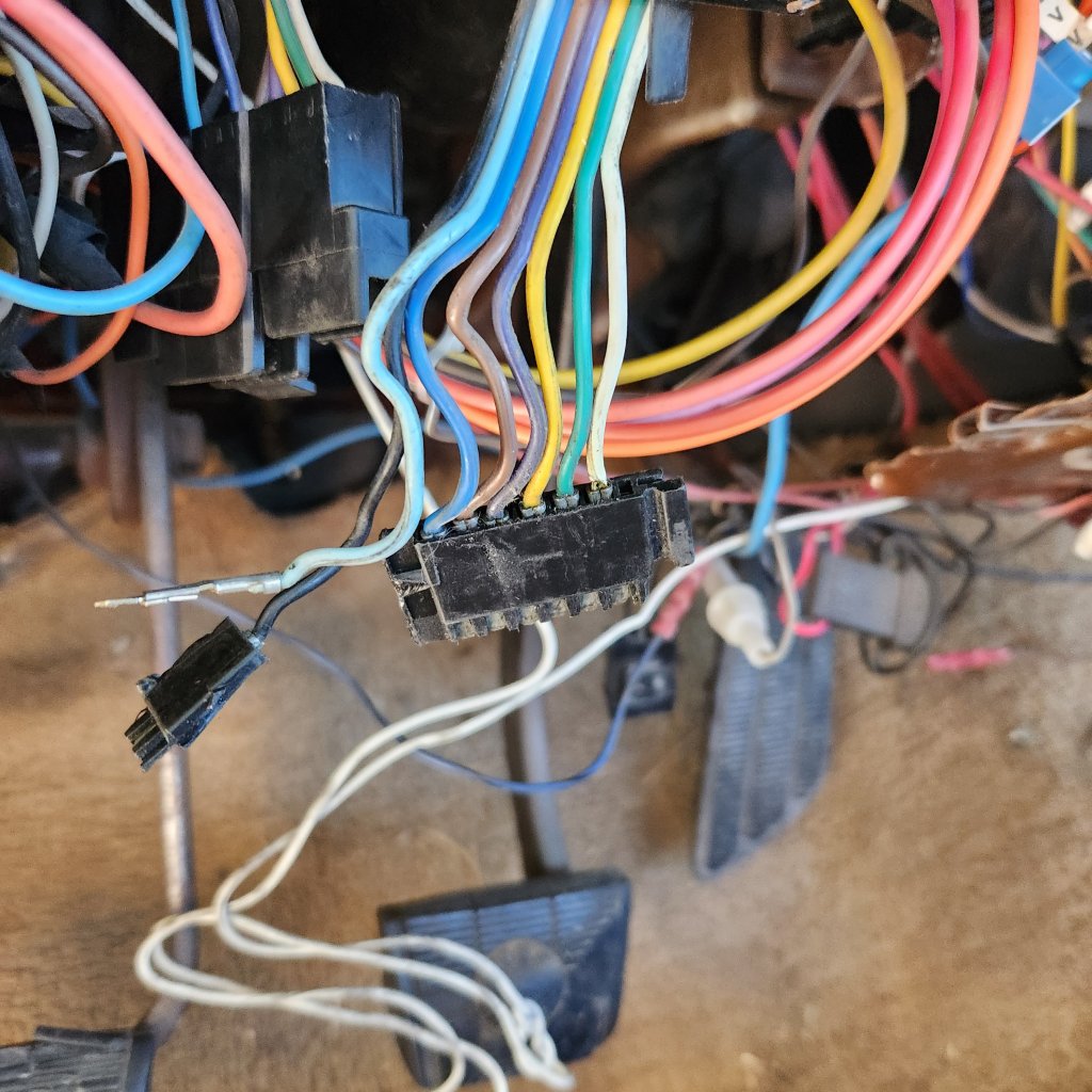

My harness only has eight wires, the socket was broken on the far left so two wires fell out easily

Cornering lights to me are your turn signals, so perhaps I should ask what he means by cornering lights?
Hi Paul, Turn signals are for indicating a turn. Cornering lights are a separate feature to light up the side of a vehicle, while turning, to see what is next to the vehicle.

Since it's a dual wheel truck it does have lights on the sides of the wheels, but my current turn signal only has eight wires, where would I find a harness with corner cornering wires?
Cornering lights were found on lots of high end fancy cars. It is easy to add with the correct turn signal switch.
