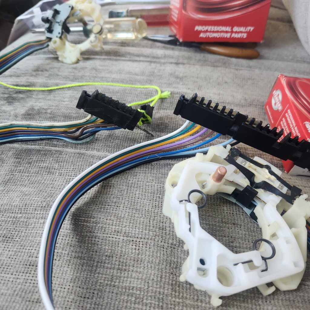

The new turn signal module arrived today it's the pretty one on the right that clip on the harness is twice as long as the original one on the left, does anyone know if it will still plug into the chassis harness or do I got to do some finagling?
The original plug is subbridled it broke while I was just trying to disconnect it so if I'd rather I would rather use the new one

Although longer, as long as the new plug has the same wire spacing as the old plug it should go together no problem. Looks like you got the longer harmonica connector for a switch with cornering lights even though the switch is not wired for it.

I will find out tomorrow morning if it will fit
