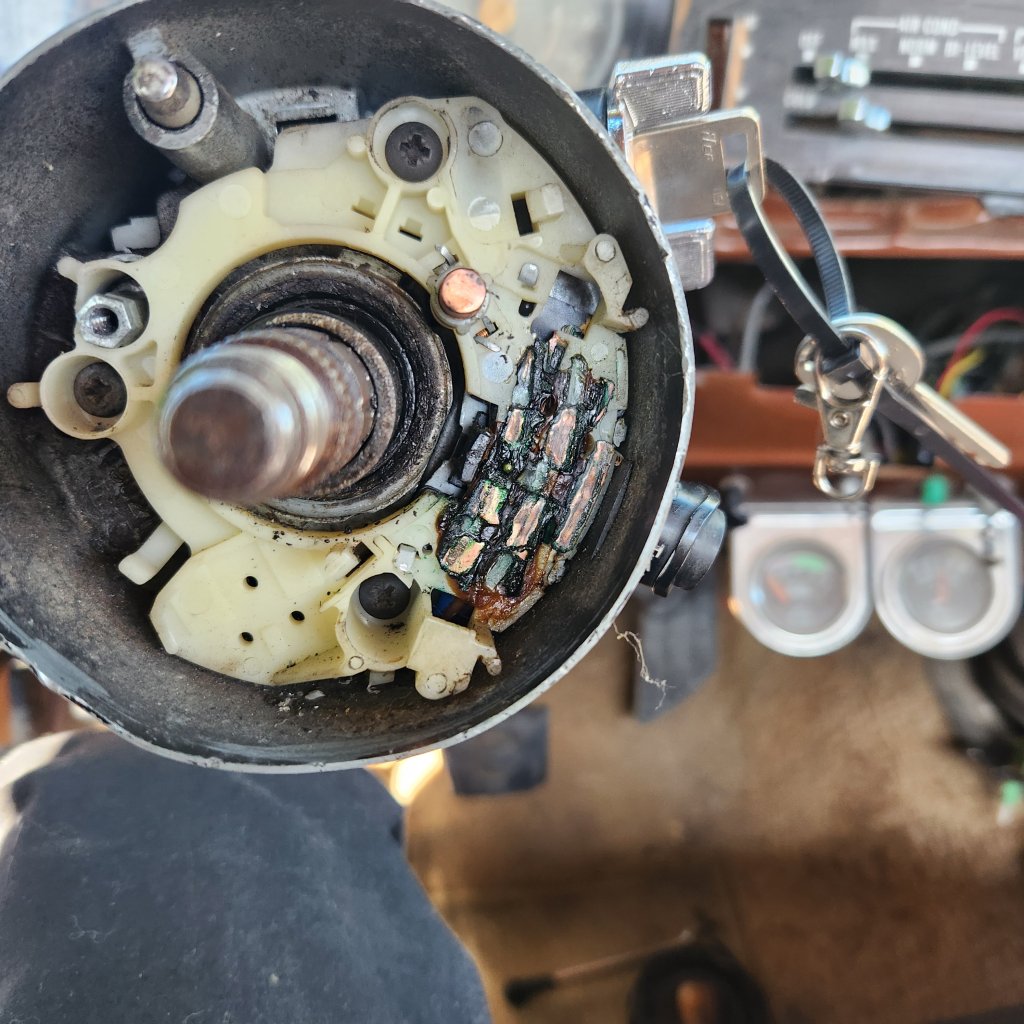

Order this cheap part incase...
It's in the top end for high beams, mine had little plastic nob broken off.

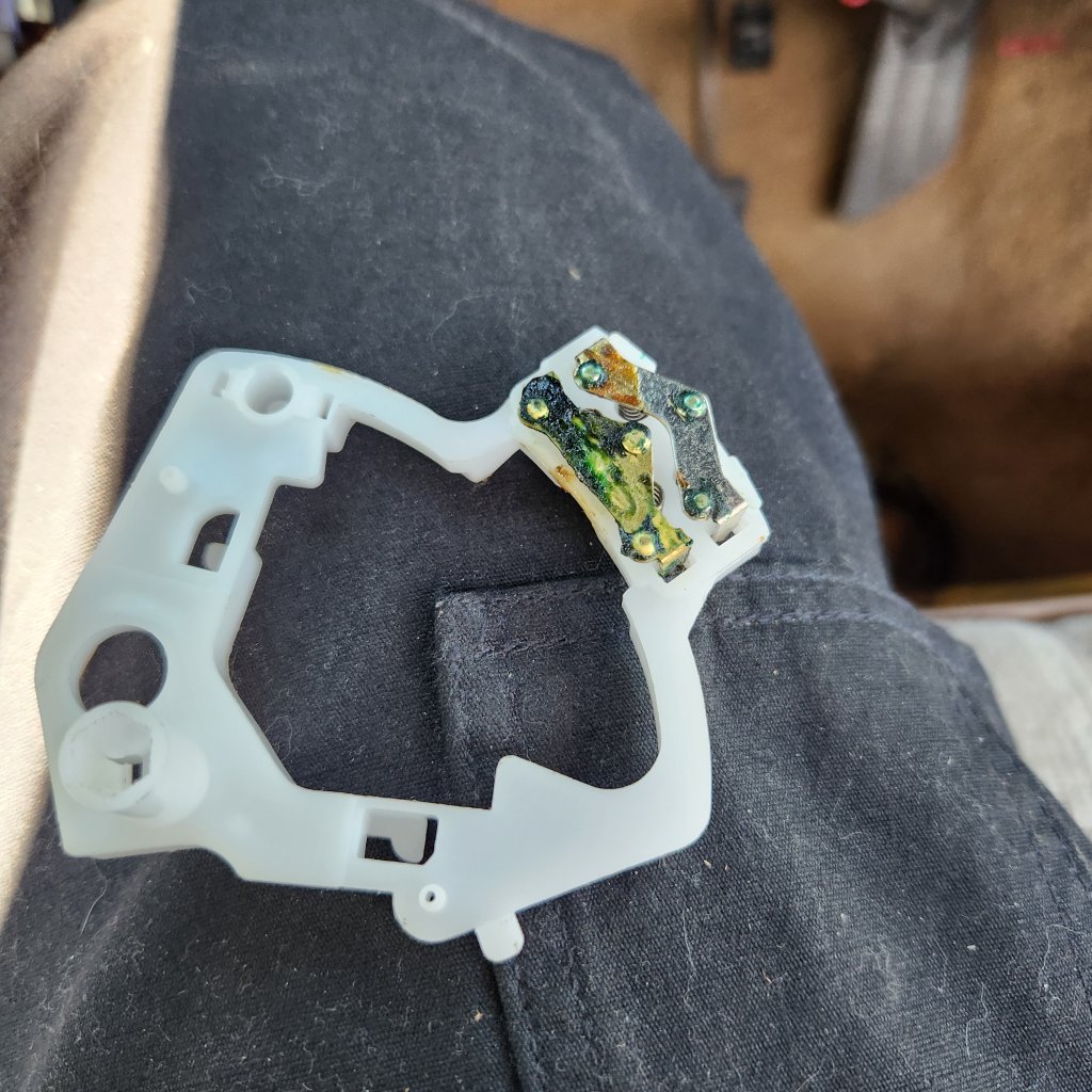

My harness only has eight wires, the socket was broken on the far left so two wires fell out easily
