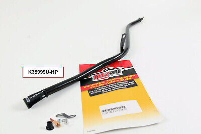

Does anyone have a place to buy these?
My dipstick tube is rusted through and I bought a universal one, but it isn't a direct fit.
Shocker, I know.
My tube is 33", most of the after market ones are 24".

I ended up using this dipstick and tube combo.
It is pretty good, but shorter than the original.
The dipstick is also off, but it is manageable.
The fill line of the new dipstick is really the full line according to the old dipstick.
I was able to tweak the bracket so it fine okay.
I also used the GM seal because it looked better.

They are available at summit, JEGS, your local speed shop probably has one in stock. Autozone or advance auto could order them.
