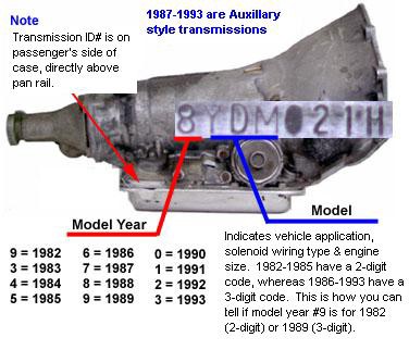

You will notice in this ID chart, that the 82 and the 89 both have the 9 digit to identify them. Keep in mind, the 82 will have the pressure taps, the 89 will not, so that is how you tell the diffenece in an 82 and a 89 year model. The white arrow points to where you find that # to use the chart above.

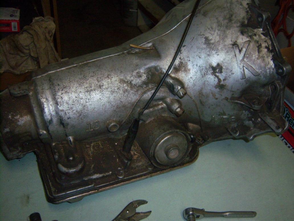

Here is a pic of the rainbow on a 700r4 that some will reffer to. This is what you want. The case with this rainbow in the case cast, is the more desireable unit to build. Also notice, NO PRESSURE TAPS.
