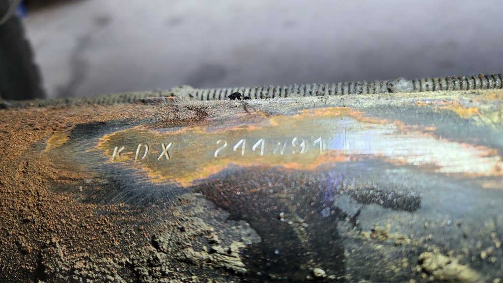

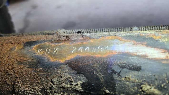

I can't find anything on this axle code. I just need the size or whatever. Ex: 2.75
Kdx 244w91

So as it turns out I had it all wrong. I need a 44 tooth gear. Not a 29. My axle ratio was 4.10

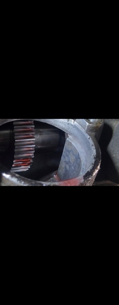

I ran into a issue. I orderd a 44 tooth gear and a new housing for it.
I counted 40 teeth on the old gear. It was stripped and bent a little.
The drove gear looked fine and also looked metal?
I tried to install the 44 tooth but it wouldn't go in. So like a idiot I had my freind spin the tire backwards. And it sucked the gear in and bent it.
I reached the conclusion that the driven gear must be for the smaller size.
I put the old gear in the new housing and re installed the truck and did other irrelevant stuff.
So do I need to order a 38 tooth ish gear? Along with new housing. I'm going to be puting bigger tires on it.
Now the other question is. The 40 tooth I had in there looked smaller than the 44 I had. Which by my reading they shouldn't.
I can't return the housing or the 44 tooth because they came together and 44 is damaged.

Thats a reluctor for an electronic VSS.
You need to replace that with a mechanical speedo drive gear.
Look at the grey gear:
You will also need the metal clip that holds the mechanical drive gear in place.

Wait to this trans is suppost to be electronic?
If so that works out way better.
It can be either.
Install an electric VSS if you want to go that route, or you can remove the reluctor, install a mechanical drive gear and driven gear, and run a mechanical speedometer.
