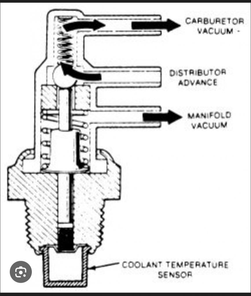

I will disagree with the comnent about vacuum advance is only there for milage,but I don't want to get into it. There is reason GM used a thermovacuum switch that changed default from ported to manifold vacuum once a certain temperature was reached.

Cap your vacuum ports on the carb install a vacuum tree somewhere on the manifold. Then hook your transmission and vacuum advance to the manifold. As for engines running fine just poor milage with vacuum advance. Not true that's why manufacturers have installed it for decades,and decades the advance needs change at idle,different engine speeds,and different engine loads,and vacuum is an easy way to monitor this,its like a primative ecm. Race cars don't need vacuum advance,and it wouldn't work of they had it,there is no vacuum at higher throttle openings. All factory cans do not provide the same amount of vacuum advance,some provide very little,some provide a bunch,they also don't all come in and drop out at the same vacuum rating. Most if not all adjustable vacuum advances are a very poor substitute for a properly rated can and a limiter if needed. The way most if not all adjustable cans work is they have a spring that creates more and more tension as you tighten it limiting the amount of advance because the vacuum can't overcome the spring tension. Great except now you have a can that is non responsive because it's bound up by a spring and can't move as freely or at the hg rating that it needs too,not just at the end of the range,but the entire range. Cranes kits used to come with an adjustable can but the spring tension in the can was only to adjust what vacuum reading the can started moving at. It came with an adjustable limit plate to control the amount of advance possible.MSD manufactures those also. The shift started coming when manufacturers started using price point and the consumers buying that way,so now everyone just buys the adjustable can but 90 percent of the time it's not being used correctly. The adjustment is for vacuum rating,not degree limiting. Race cars get away with no vacuum advance and sometimes no centrifugal either because they are timed for total timing and are 99 percent of the time in the RPM range that they can use that timing. They spend very little timing lugging around in traffic,very little time idling,very little time at part throttle cruise. Not having proper timing at the lower speeds creates more heat and dirty plugs,as well as poor milage. Auto manufacturers came out with this handy little gadget to cure running hot at low speed with ported vacuum advance. If the engine starts running above a specified temperature it changes the vacuum source from ported to manifold vacuum,to cool the engine. Because sometimes at low speeds the engine needs the extra timing.
