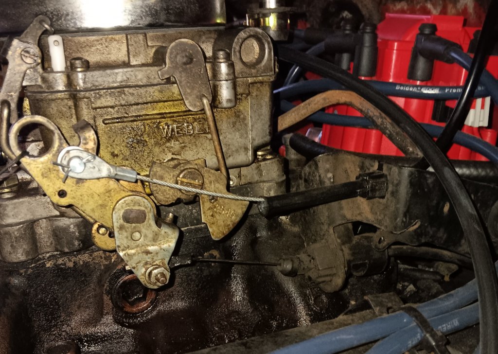

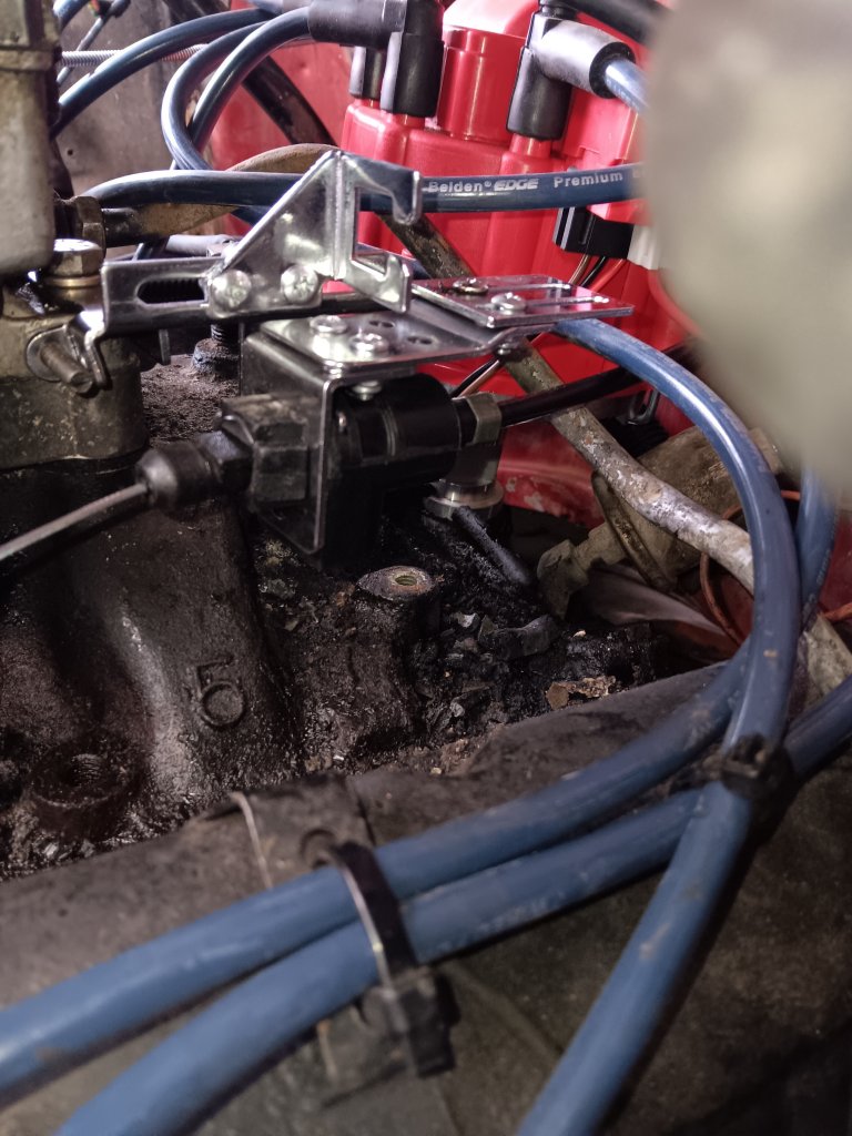

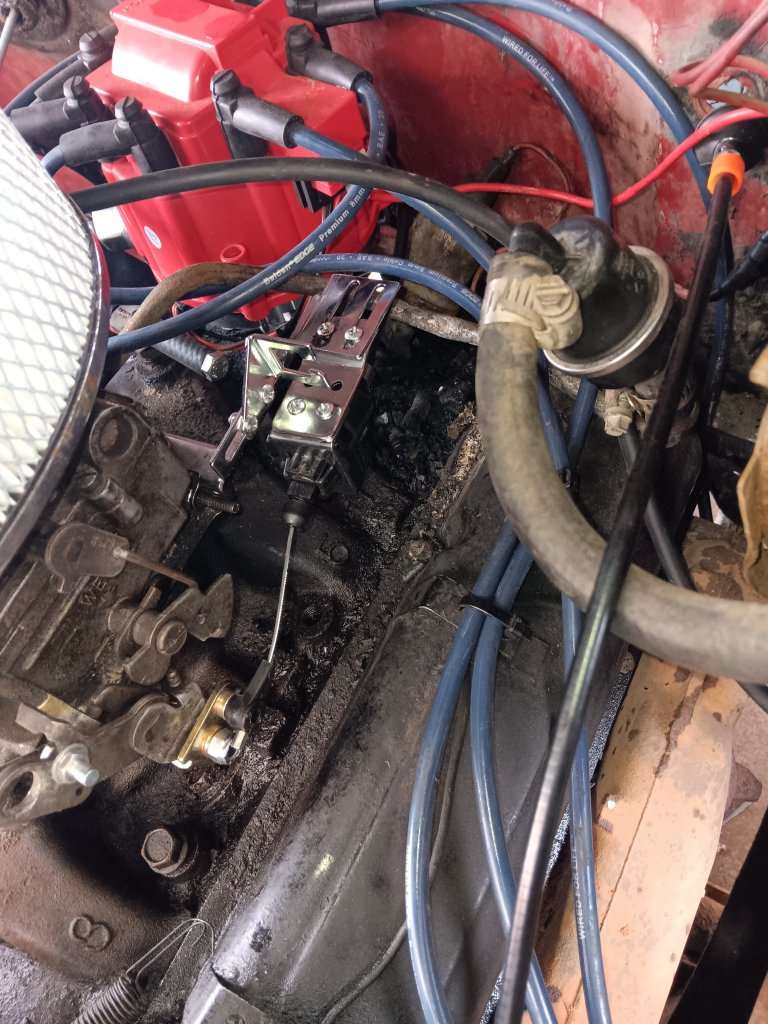

Works much better at low an part throttle.
The way it was rigged before was fine at full throttle but shifted to soon at anything less.

caincrx
Jan 4, 2023
9
Sedro woolley WA
Caleb
Custom deluxe K10
It is much better and much closer to being right the way you have it now. It still isn't right. The cable needs to be level and straight from the braket to the mount stud on the geometry correction braket. The braket you got isnt for a edelbrock card, its for a holley. Why isn't it for a edelbrock carb? Because it is the wrong geometry and the cable cant be straight and lever. Most people use that sane braket but modify it so it works.
