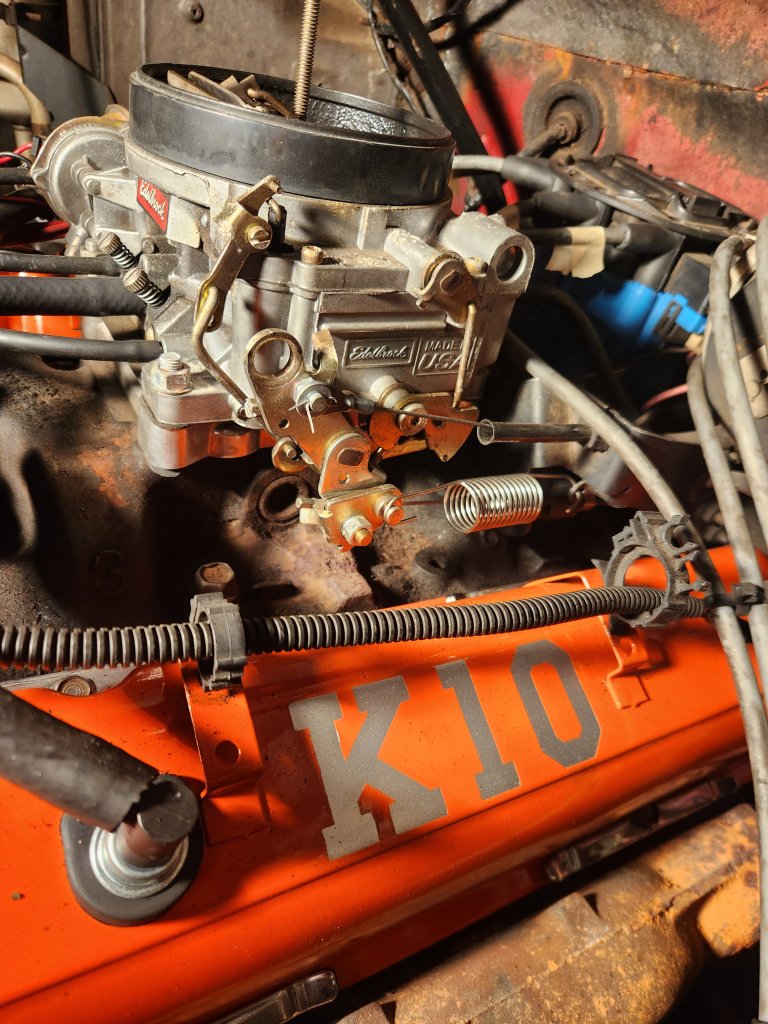

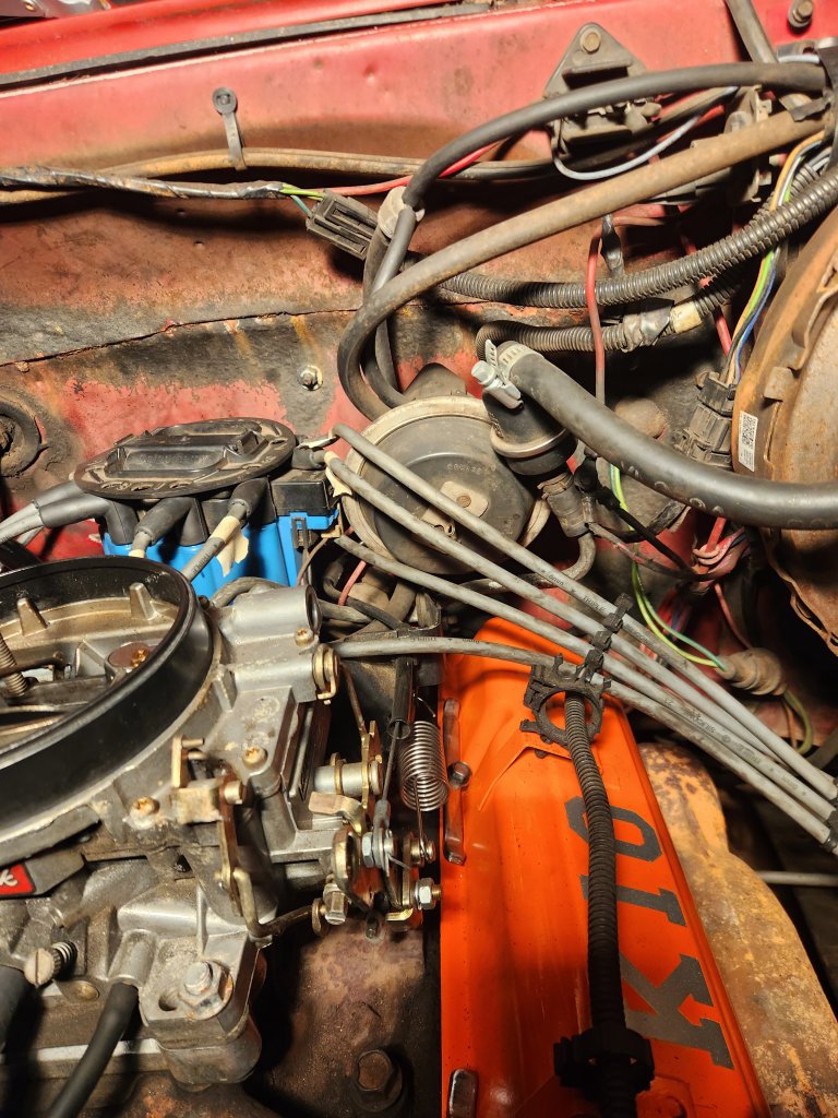

K10 silverado
I had this same problem, my transmission started to not shift unless I was doing like double the rpms needed, down hill. I got mine rebuilt in a shop and then it was good until about a week later of daily driving I no longer had a reverse and could not climb hills well. I took it back to the shop and they took care of it and adjust the tv cable bc it was really off. I bought a geometric adapter something for my edlebrock,

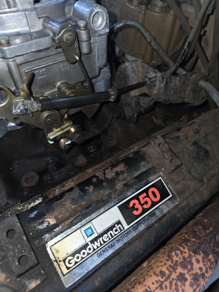

here are some pics of mine

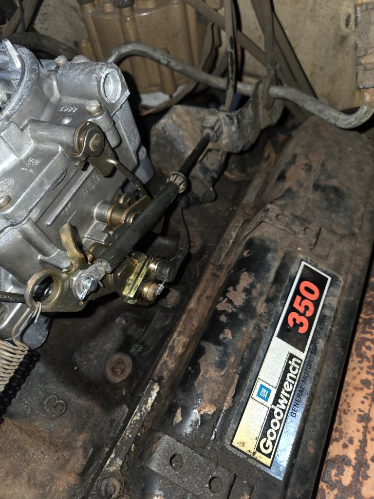

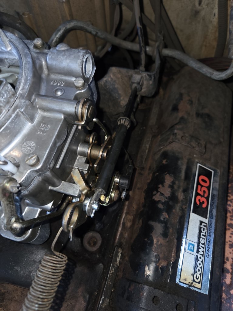

Thanks for the info. Got the edelbrock bracket ordered to replace the stock. Here are some pics. The cable is definitely not lined up as well as before.
