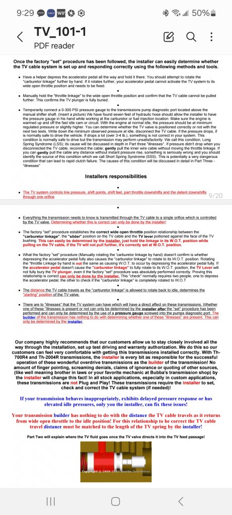

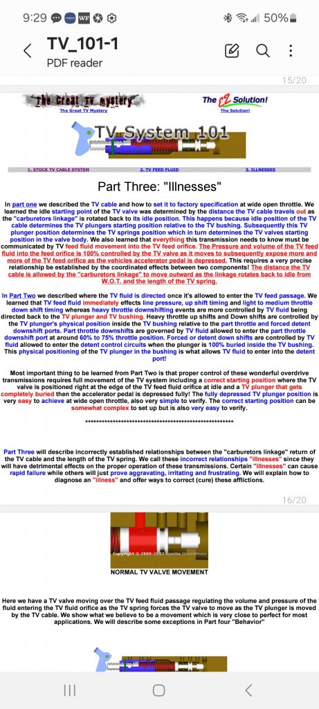

i will be putting a 350 in my truck it originally had a 305, it has a 700r4 and im going to have a edelbrock carb on it, i see lots of kits out there for the tv cable but not sure what all i need for it to run right and not kill my transmission. Thanks
9,940
19,066

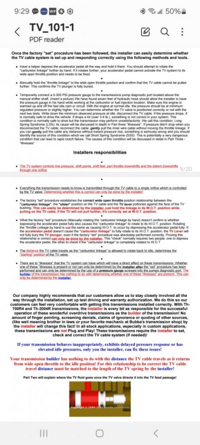

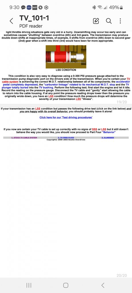

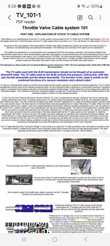

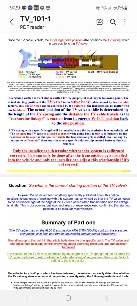

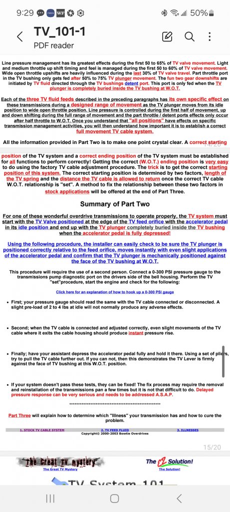

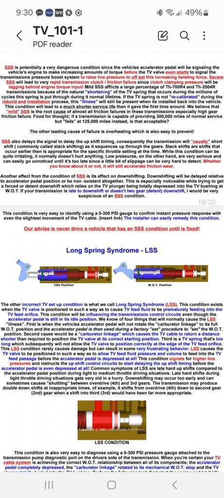

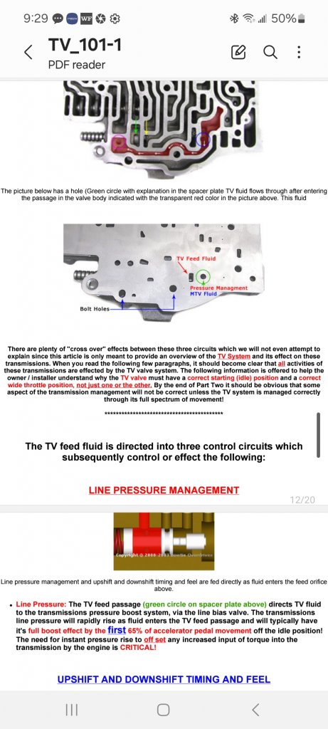

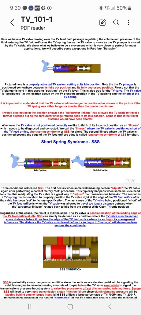

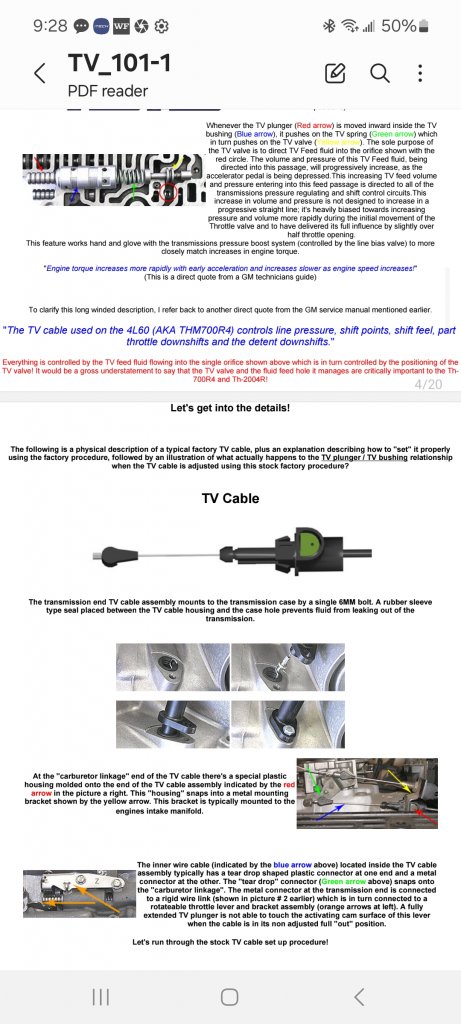

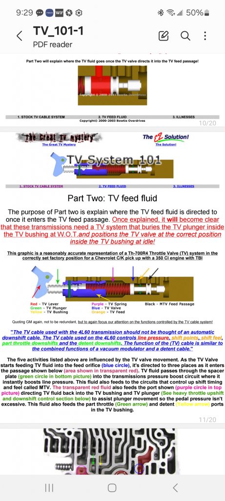

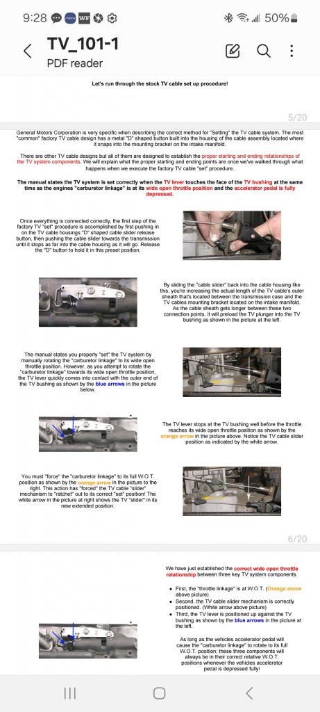

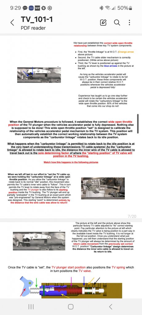

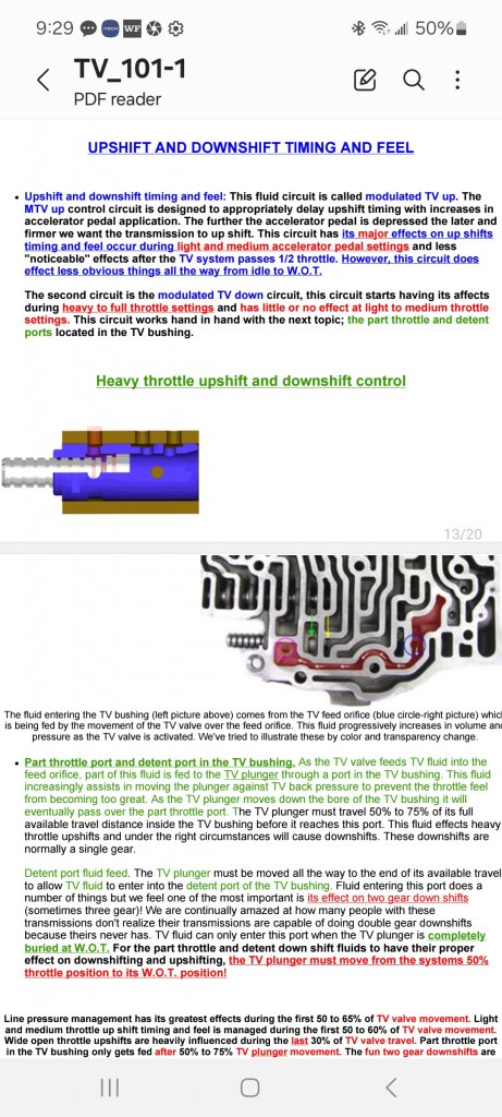

There is no simple answer you are going to need a TV cable possibly a universal TV cable,you are going to need a correction lever for the carbureator,you are going to need a cable bracket that will bolt to your manifold and keep proper geometry with your correction lever. And you should have a pressure gauge to check your set up,and make sure the valve body itself is in good operating condition .I ve put up 14 screen shots explaining TV operation and problems. I believe B&M on their website has diaghrams for TV geometry and transmission pressures.

Double tap on the pressure test to dial in the TV cable before you move it. A pressure test kit is like $25 on Amazon. Make sure you get one with a gauge that goes up to at least 300psi.
Nick has the pressure test specs on his 700r4 page. Do it wrong and you will burn it up in less than 5 miles
